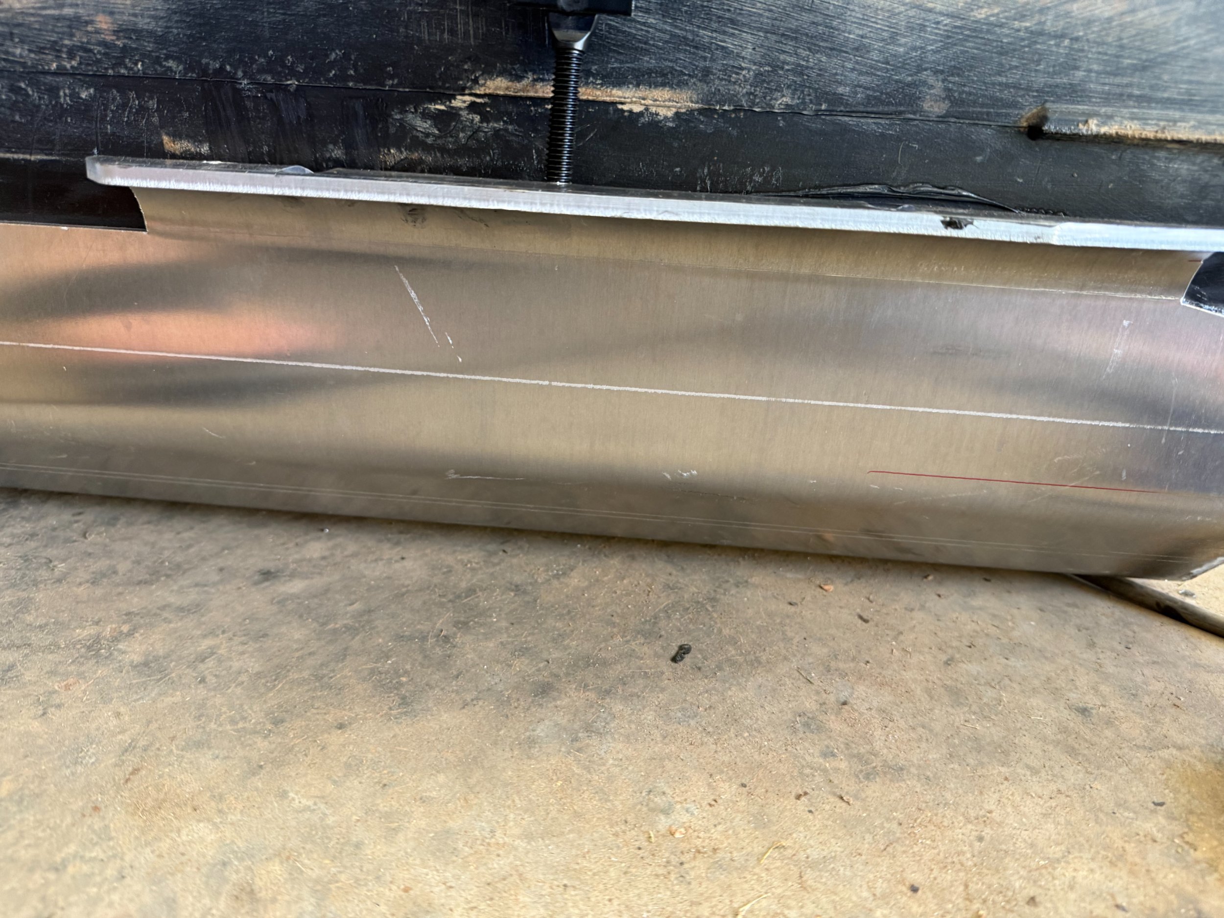

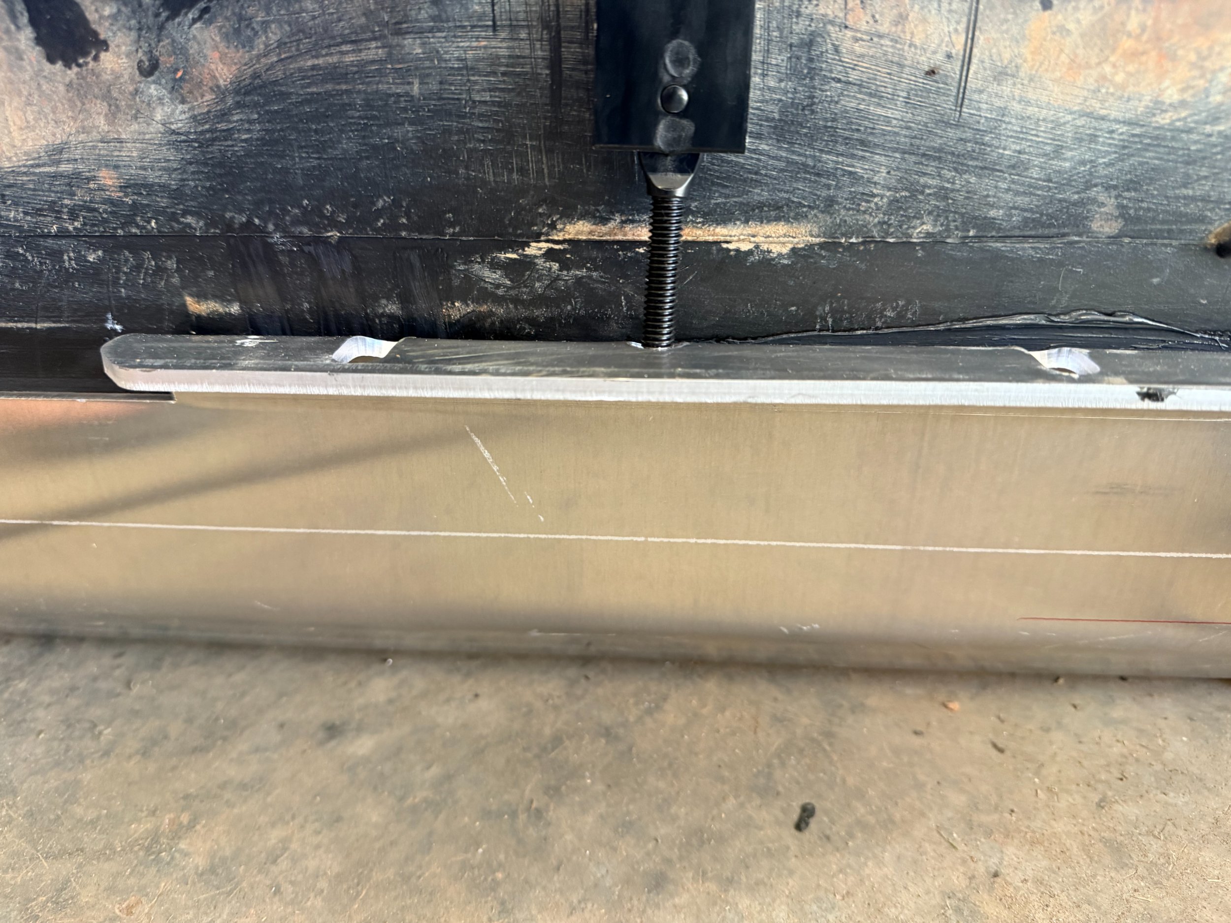

This is a timely post. Today I tried to put my tank into my UCF Aluminum Gas Tank Skid. I have the same problem. I'm contacted UCF to get advise and am waiting on a call-back.
I cleaned my tank off and sprayed silicone on the tank and skid. I took a BFH and pounded the skid at the contact points which helped. However, the tank is still about 3/4" too high.
Having read the posts above, I'm now thinking about taking my heat gun and warming the tank (same as setting it in the sun) and traying again. I'm assuming that the tank distorting to slid into the skid isn't an issue.

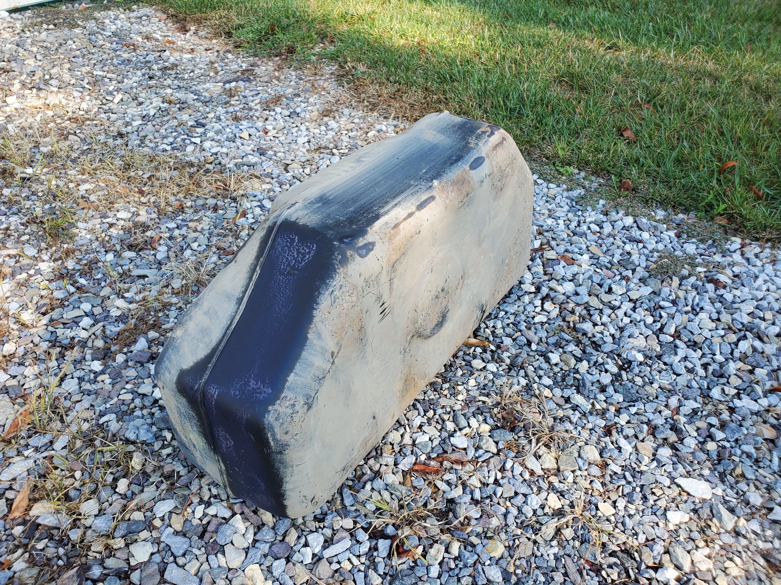

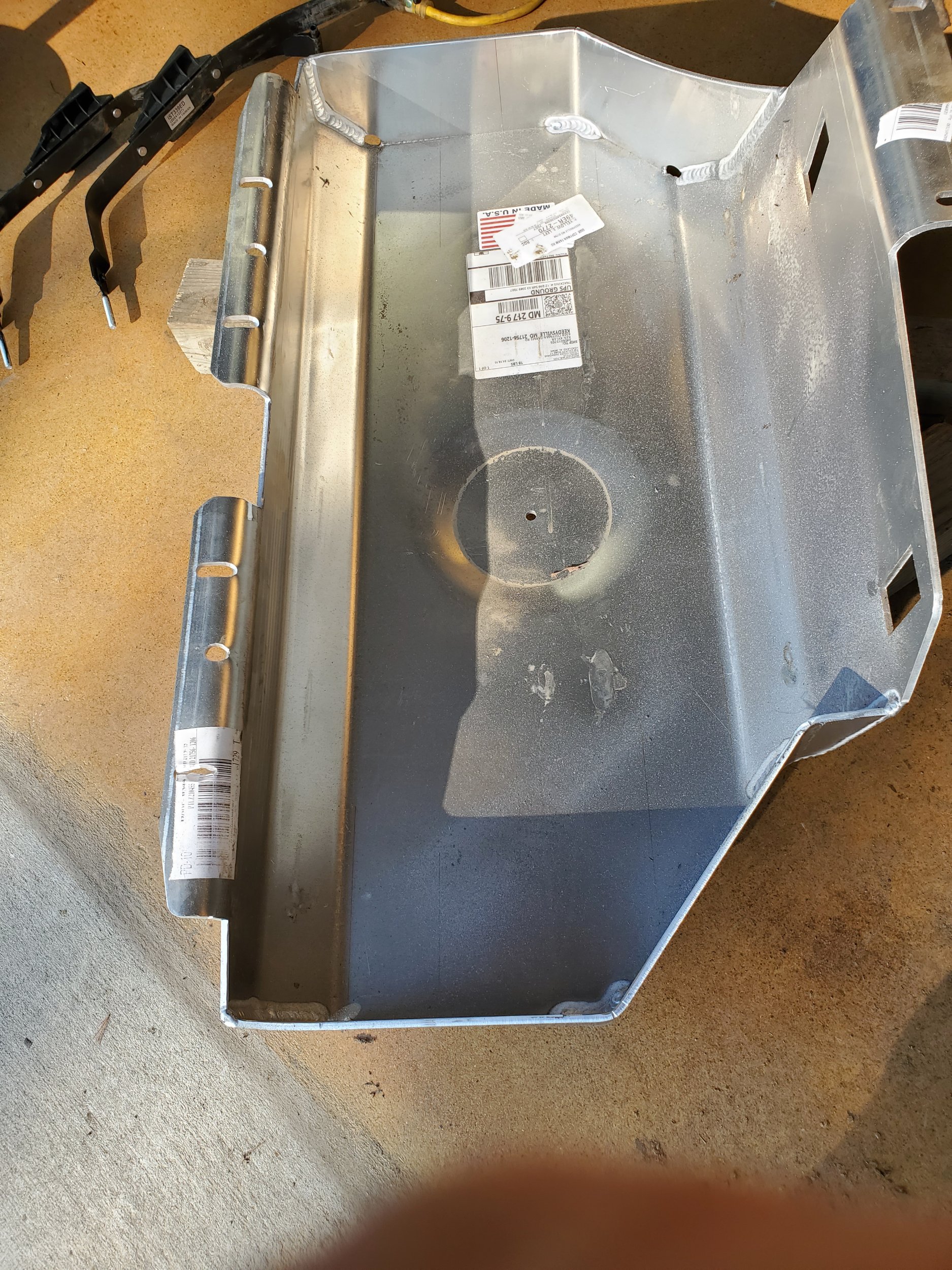

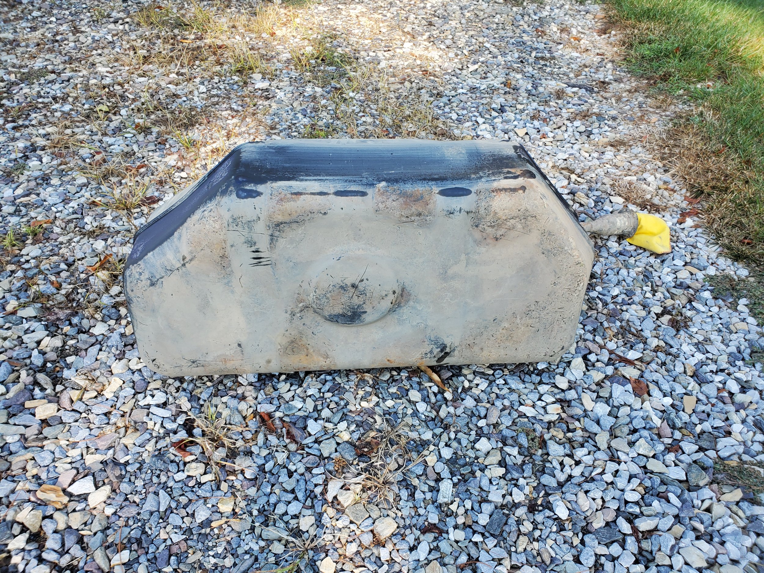

Not sure if this affects the OP or not, but this appears to be my problem. The bottom of the tank skid is bevel front and rear. My tank won't go all the way to the bottom. Look at the pics of the tank and skid, you can see contact points where the tank contacts the skid. That leaves the tank about 3/4" high. The sump for the tank is about 3/4". There is a depression in the skid for the sump but the tank won't go that far down.

I would try cleaning the gas tank and skid really well, then lubricate the contact points with silicon grease, and then use a ratchet strap with a 2x4 cut to the width of the tank placed between the top of the tank and strap so it gets squeezed downward without putting pressure on the sides of the skid plate.
given the tank won't physically fit to the bottom of the skid, I'm concerned about the deformation of the tank required to make it fit.
I'm still waiting on a response from UCF.
View attachment 641006View attachment 641007View attachment 641008View attachment 641009
Probably clean the layers of dirt off and it should fit better.
I finally heard back from UCF. They too said to use ratchet straps and lube. So I slathered it up and cranked the ratchet straps tight. The tank straps tightened to spec. I used a dowel rod through the drain holes and in some places it isn't tight to the skid and in others it is. I'm calling it good enough for now. Tomorrow I'll put it in the TJ. 🤞🤞🤞🤞
for the next person with this problem, this is what UCF said "The skid is designed from the cad model of the tank. It is a tight fit but that's on purpose. You will need to wrap a couple ratchet straps around the tank and skid to pull it down and then install the metal retainer straps."
That works. In my case it was still slightly high but as @macleanflood said, when you jack it up it will go down a bit more.
For reference, if you want to slide the skid back in the slots, you have to do that before you jack it up high enough for the pads on the tank straps to contact the tub. Ask me how I know :LOL:
