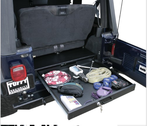

https://tuffyproducts.com/?gad_sour...2VbAeiBVDX8biAiBkWK_h4cKMT-smOSRoCAS0QAvD_BwE
I installed their under rear seat security drawer and it was a solid storage area. I later added their glove compartment door and most recently replaced my center console with their version.
Tha
That thing looks pretty nice and I didn't know they existed. I assume the seat belts attach to the top of the Tuffy enclosure? I would consider it if not for my powered sub woofer which I am not ready to re-locate at this time.
