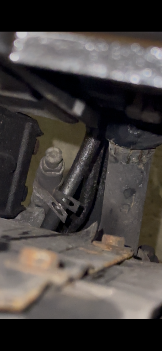

  2. Next thing is my coolant reservoir. Topped it up, drove 10 min, and found it low again. I haven't had any temp issues and couldn't see any leaking. Only thing I did spot was what appeared to be a hose/tube that isn't attached to anything that's near the bottom of the radiator, and I saw when looking down at the space between where the coolant reservoir tank and front of the jeep.

I'd guess the hanging hose is your front diff vent line. But it's just a guess without pictures or more info.

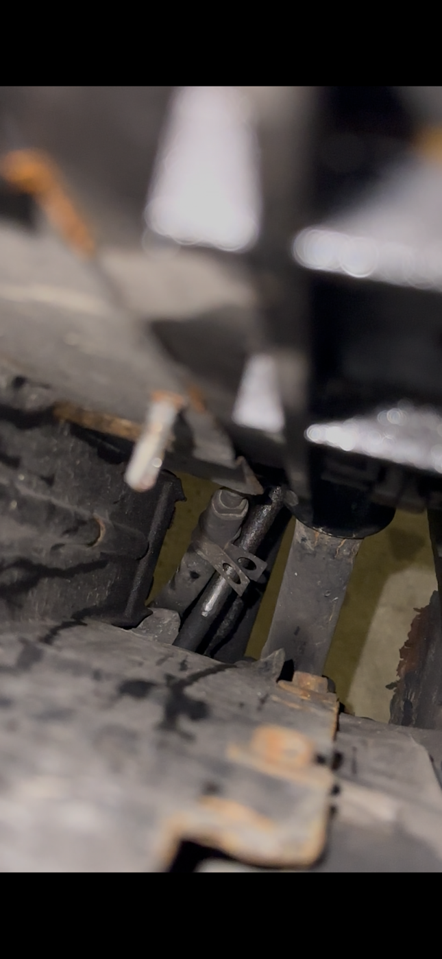

Here are the images. It does kinda look like the breather hose. In my best attempt to follow it, did seem to feed into the front diff
Yep that's probably the front diff breather hose. See the vent on top of it.
I would do what I could to get the hose up as high as you can.

Will do. I definitely had it mounted higher... many moons ago.

I'd get the hose to a point where you can blow through it and verify it's not clogged up.
