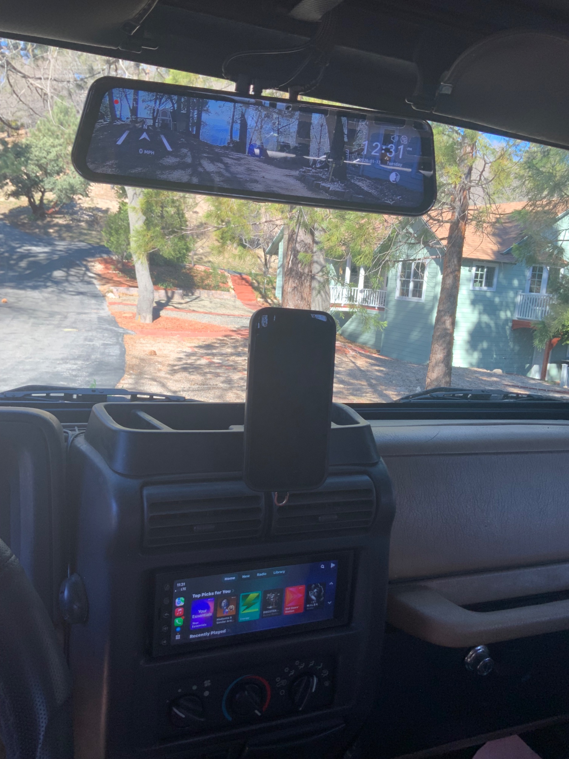

Hi all,
I use my Wolfbox 900 pro as my back up camera which leaves the back up input on my 1.5 DIN CarPlay head unit unused.
I was wondering how I would wire it to activate and switch inputs once I engaged my passenger turn signal so a third camera above my passenger side mirror would feed an image to my CarPlay head unit of my blindspot?
Either find a steady-on power source that is activated by said turn signal - or - use the flashing signal as a source to trigger a re-triggerable one-shot of sufficient duration.
I was thinking a relay with a long turn off, or maybe an RC circuit with RC high enough to hold the relay open until the turn signal cycles back on?
