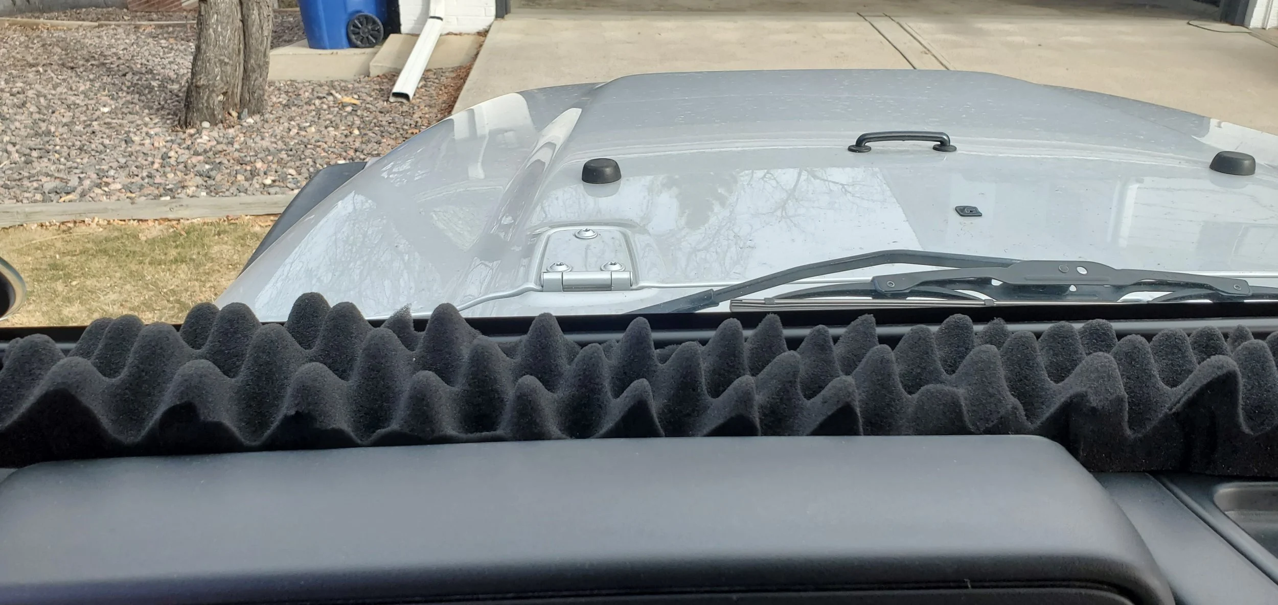

I've very recently done some 4mm CCF inside the window surround trim and center console and stuffed some dense egg crate foam into the parts of the dash along the top and an underhood liner (with a chunk of CLD). That was surprisingly effective at cutting wind, transmission and engine noise respectively.

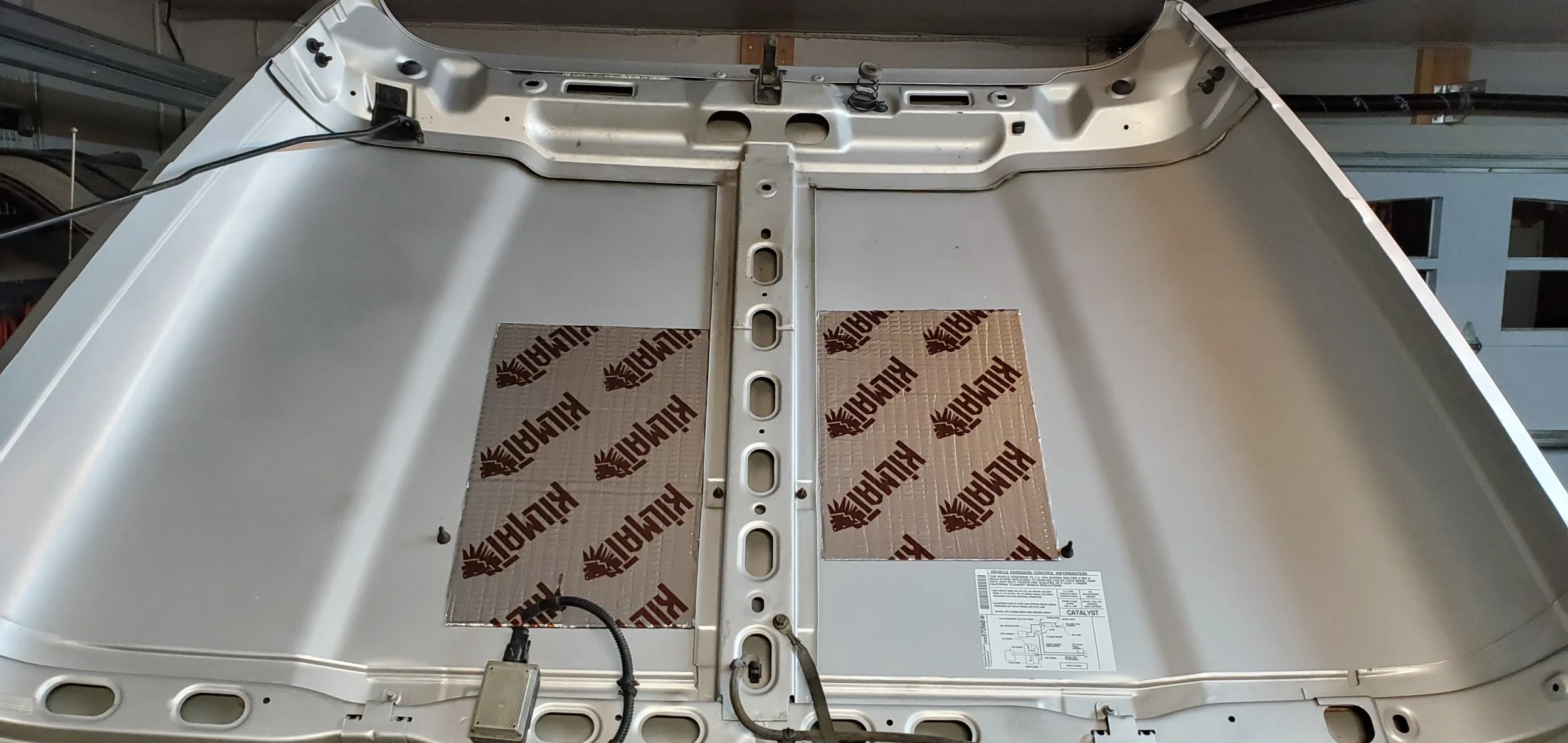

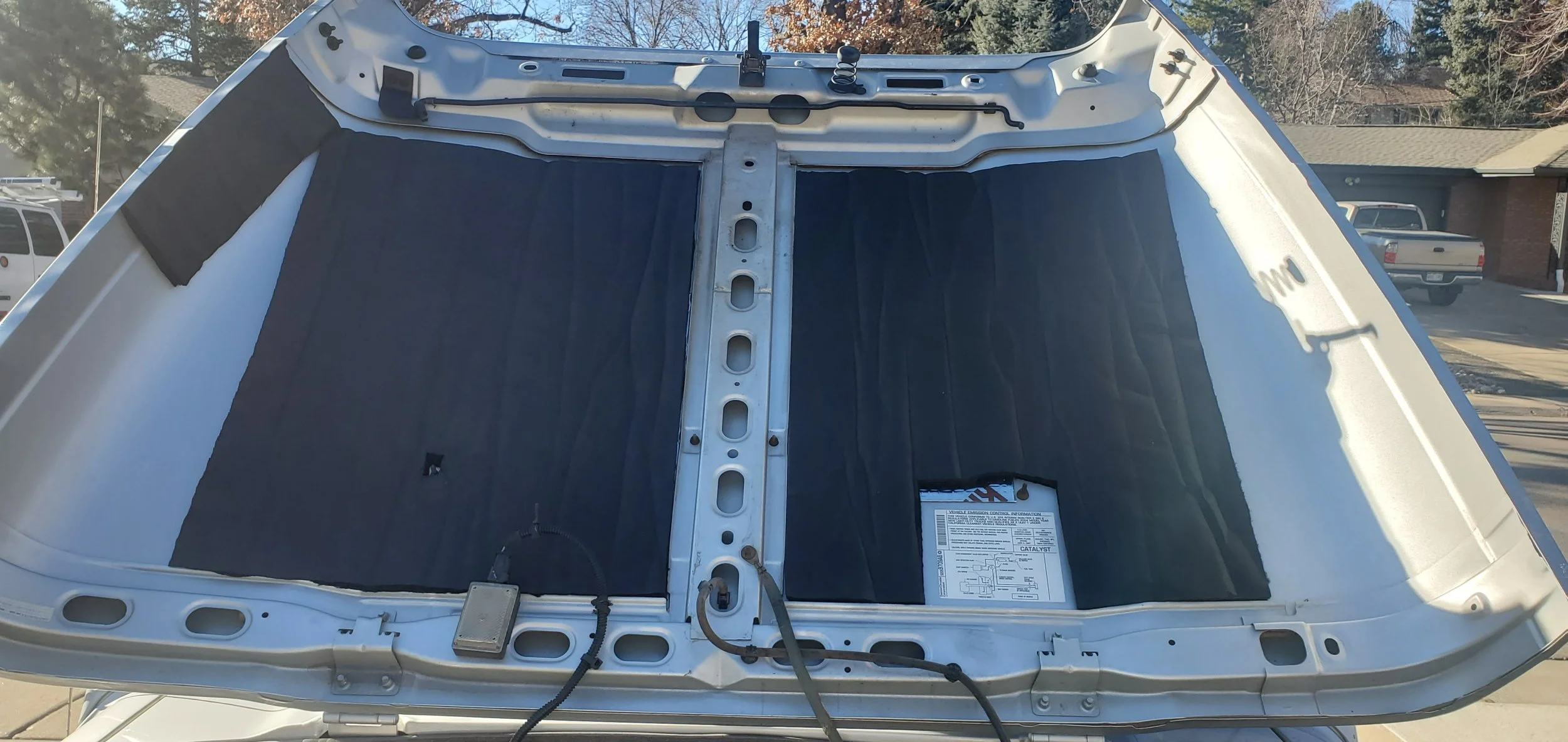

The little bit of under hood liner on the front edge of the passenger side lines up to the side port of my talkative CAI but doesn't impede airflow.

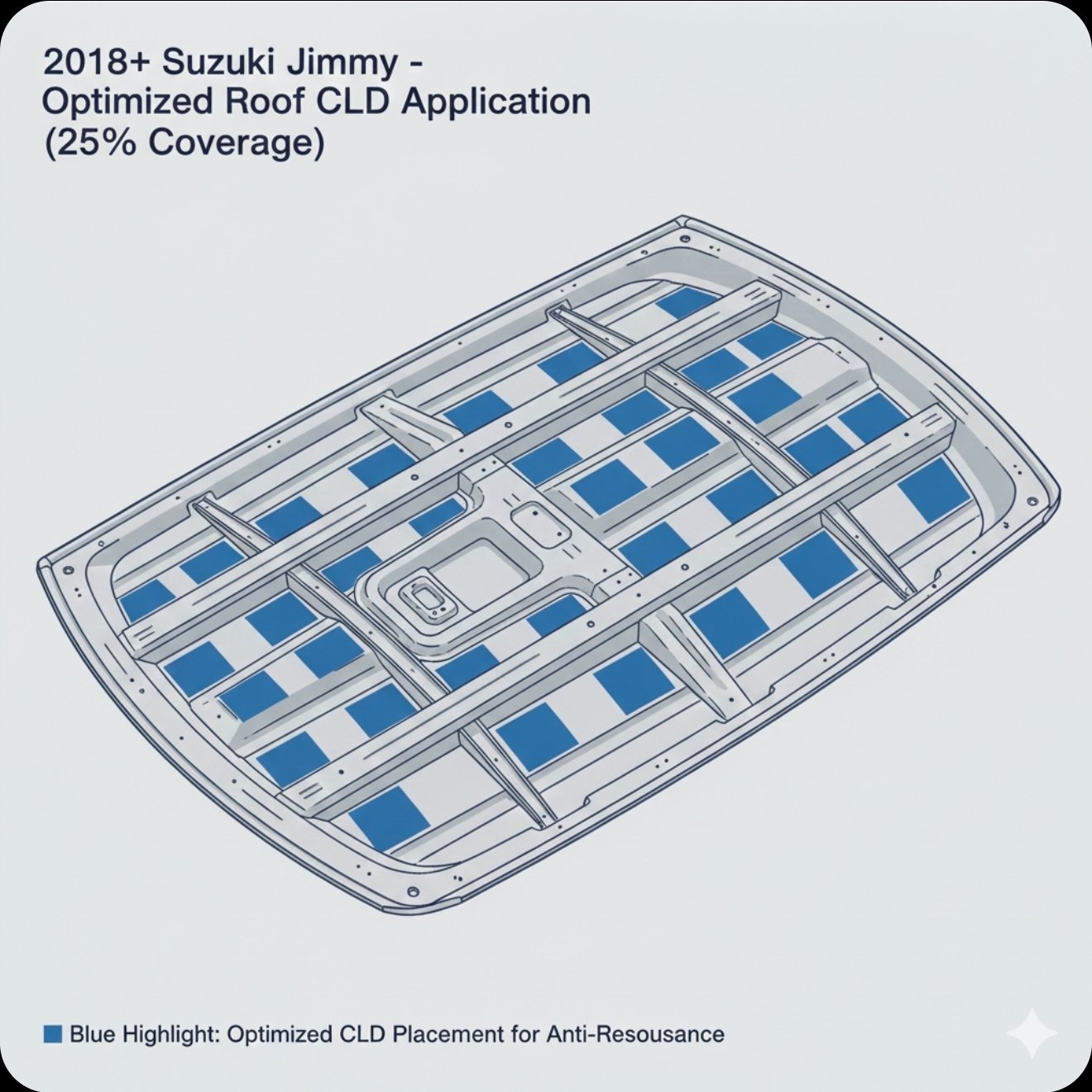

As just an example this is a mock of 25%-40% CLD coverage on a roof. And an excellent example of 25% - 40% coverage on the interior of a Suzuki Jimny.
This is a video of how a small amount of CLD quiets a cymbal. Which gives you an idea of what it does to the sheet metal in a vehicle. And why so little of it is necessary.
The important thing to remember is ribbed or raised sections of sheet metal don't reverberate like that. Only flat sections have that ability. So it's only helpful to place it in the larger flat areas. Installations showing full coverage add little to no benefit beyond this 25%-40% coverage. And add a tremendous amount of weight. Likewise thicker heavier "premium" CLDs add little to no benefit as well. It simply isn't necessary.
