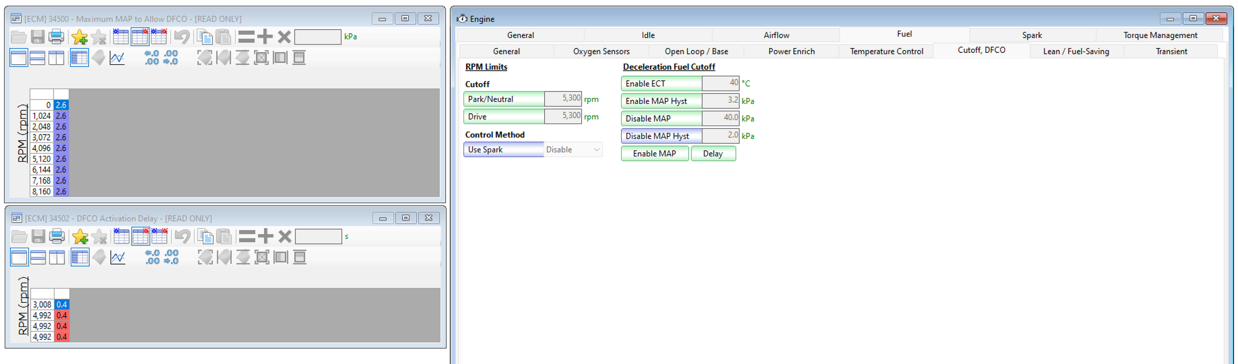

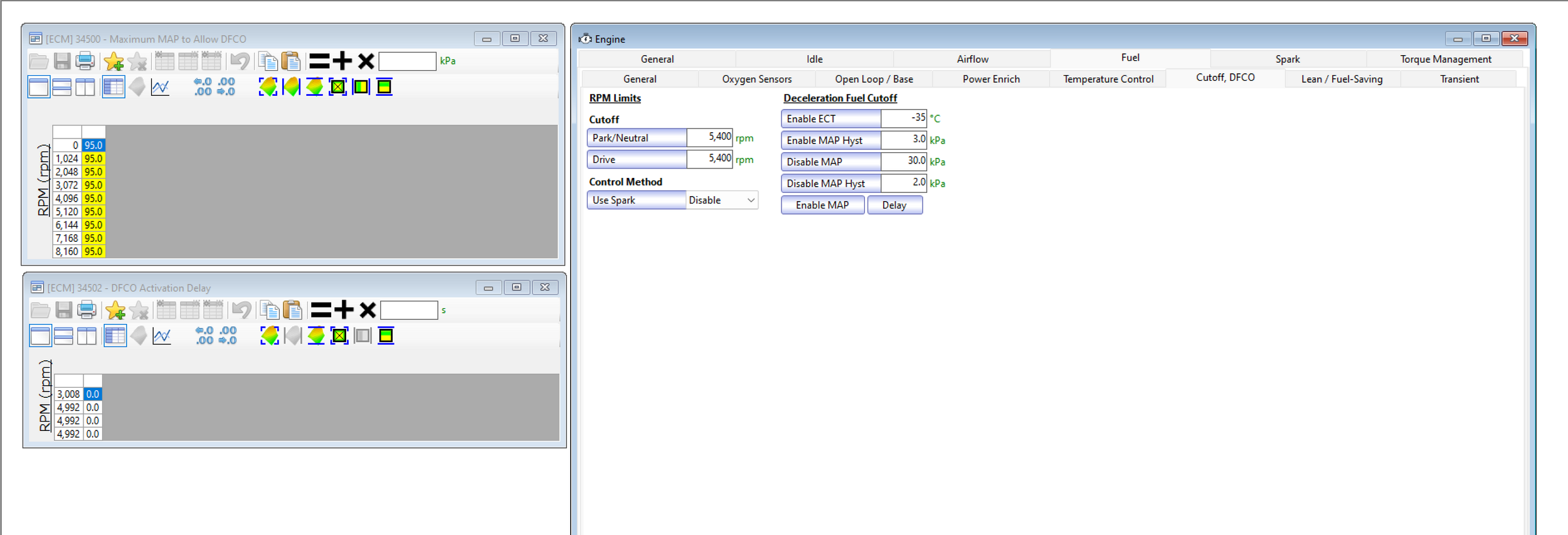

Factory settings:
Note that the Enable MAP is set to 2.6 kPa across the board. This effectively disables DFCO (except for emissions reasons) as MAP never goes below ~10 kPa in practice.

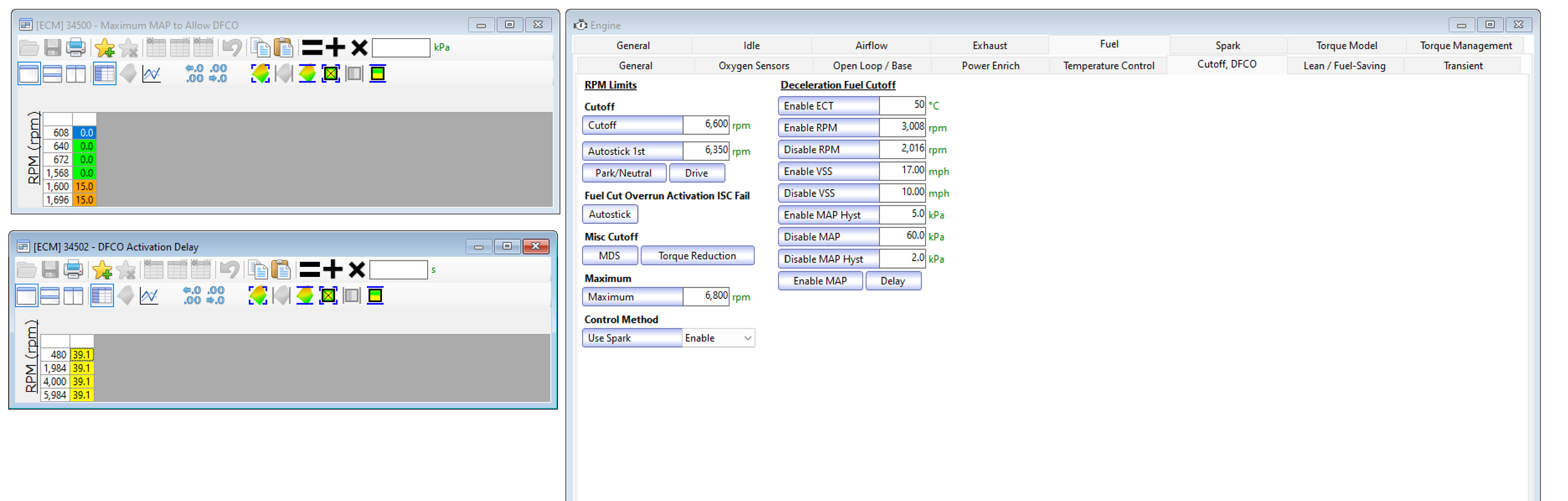

After probably trying 50 different variations of all the variables in any way that made sense, I gave up on trying to use the DFCO settings as they were intended to be used. DFCO always worked great with every tune, but the stalling issue was just a constant thorn in my side. The biggest issue is that with the engine below the enable temperature, it would actually flip the logic. It wouldn't enable DFCO, but at the instant it would otherwise disable it, it would kick in and stall the engine.
Finally, on the 51st (plus or minus a dozen) attempt, I tried a final kamikaze tune and set the "Enable MAP" way above the "Disable MAP" and set it across the board to 60 kPa. Figured it would stall everything out immediately. Instead, it did the opposite. I couldn't get a single stall driving. But suddenly, the engine would die at idle if I let out the clutch too fast. And lowering that 60 kPa to 40 kPa made that far worse. So I doubled down on the Kamikaze tune:
And it works! Beautifully. And yes that enable ECT and that Maximum MAP settings are exactly where they need to be. Does it make sense looking at it? Heck no. But it works.
My best guess as to the error in the ECM logic is that the DFCO state is stored as a yes/no state, or effectively 1/0. If one parameter wants DFCO disabled, it flips and disables itself. But if two parameters (such as idle state, Disable MAP Hysteresis, Disable MAP or Enable ECT) then both say to disable the DFCO simultaneously, it flips it to enable DFCO, generally when you least want it.
So effectively we tune it so DFCO is always enabled, and only one parameter can kick it off at a time. If you set the Enable ECT too high, the logic will flip when the engine is cold, and you will stall. Set the maximum MAP too low, and the Disable MAP Hysteresis will line up with the idle request, and you will stall. But if DFCO is always enabled, it only ever gets kicked off, not re-enabled. So you don't ever stall.

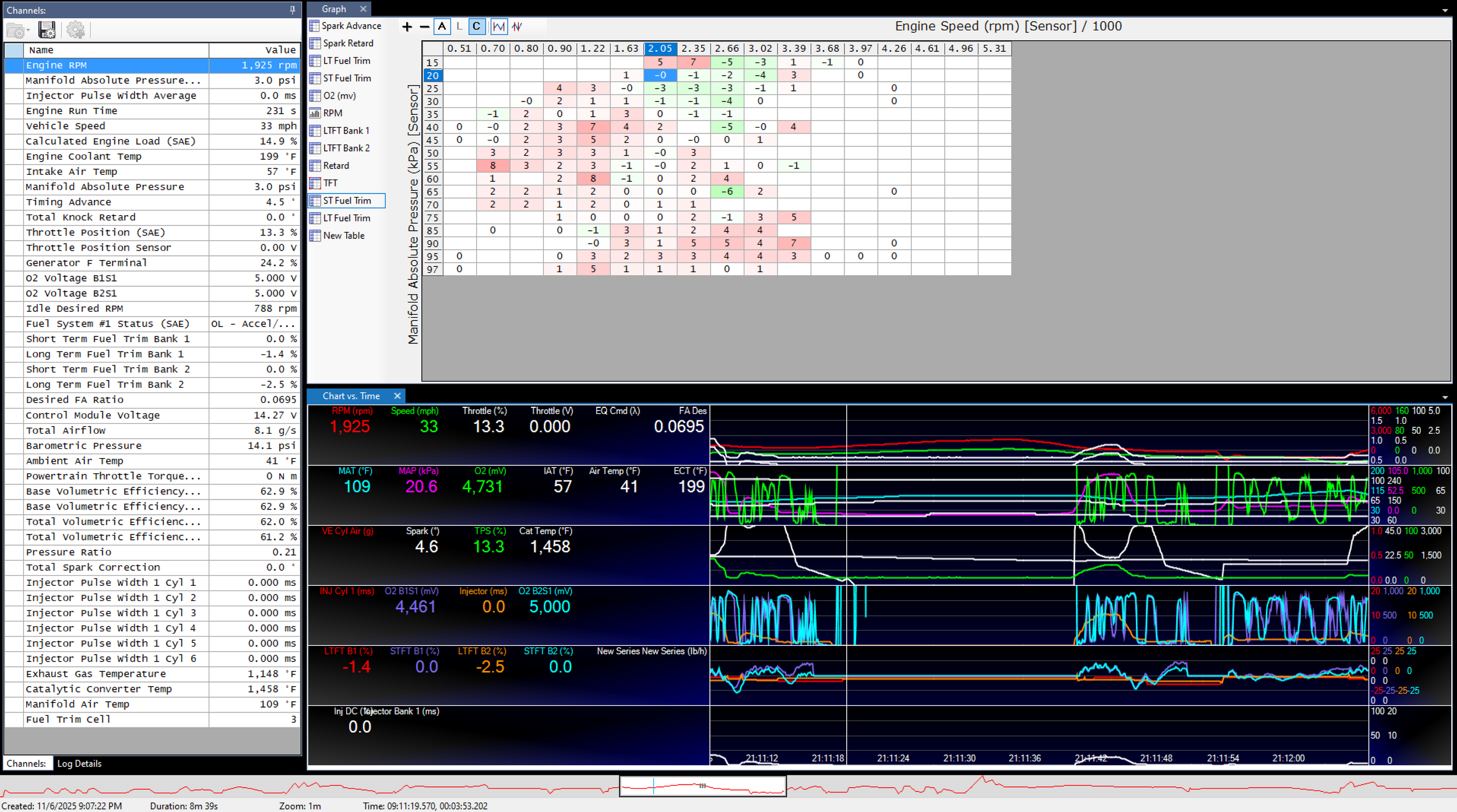

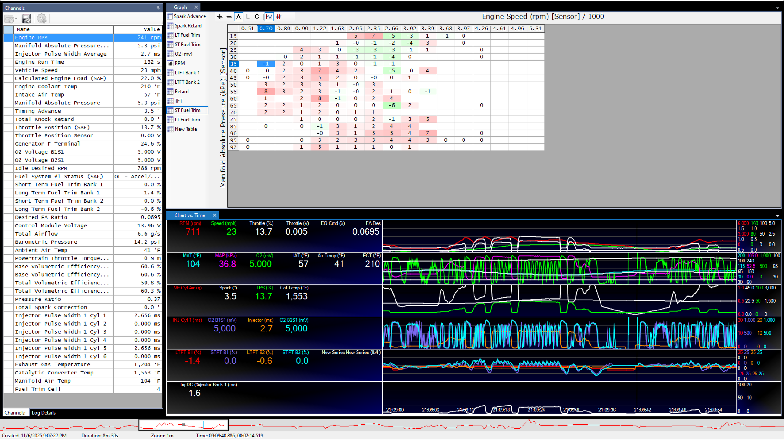

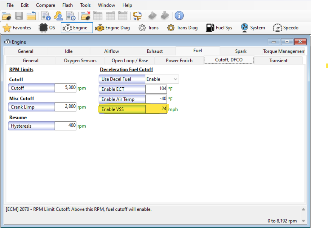

I happened to be focused on these 2 settings at the same time this post came out and have settled on a combo that works for the earlier JTEC and JTEC+ 1997-2004 PCMs. This is an area were the simplicity of tuning on JTEC provides some advantages over the NGC3 PCMs.
#1 is to reduce the Deceleration Fuel Cutoff - Enable VSS setting from 32mph to 24mph. This places the speed in a range where it doesn't interfere with low speed driving in the neighborhood on trail, but increases times when DFCO is applicable. It will not apply DFCO until the engine is reasonably warm as this could cause a stall.

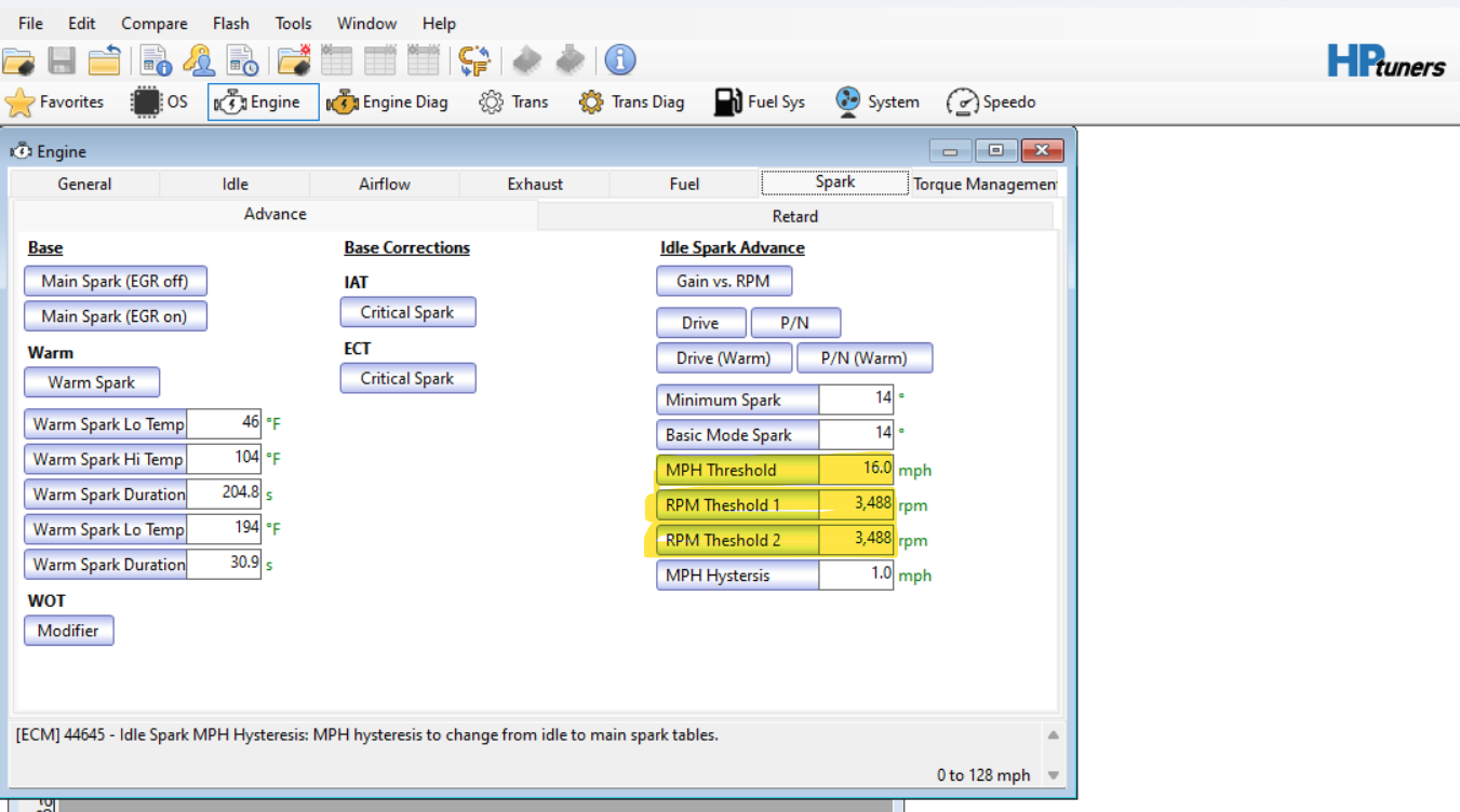

#2 is to adjust some spark advance values to ensure you don't get caught in a throttle hang at lower speeds.
