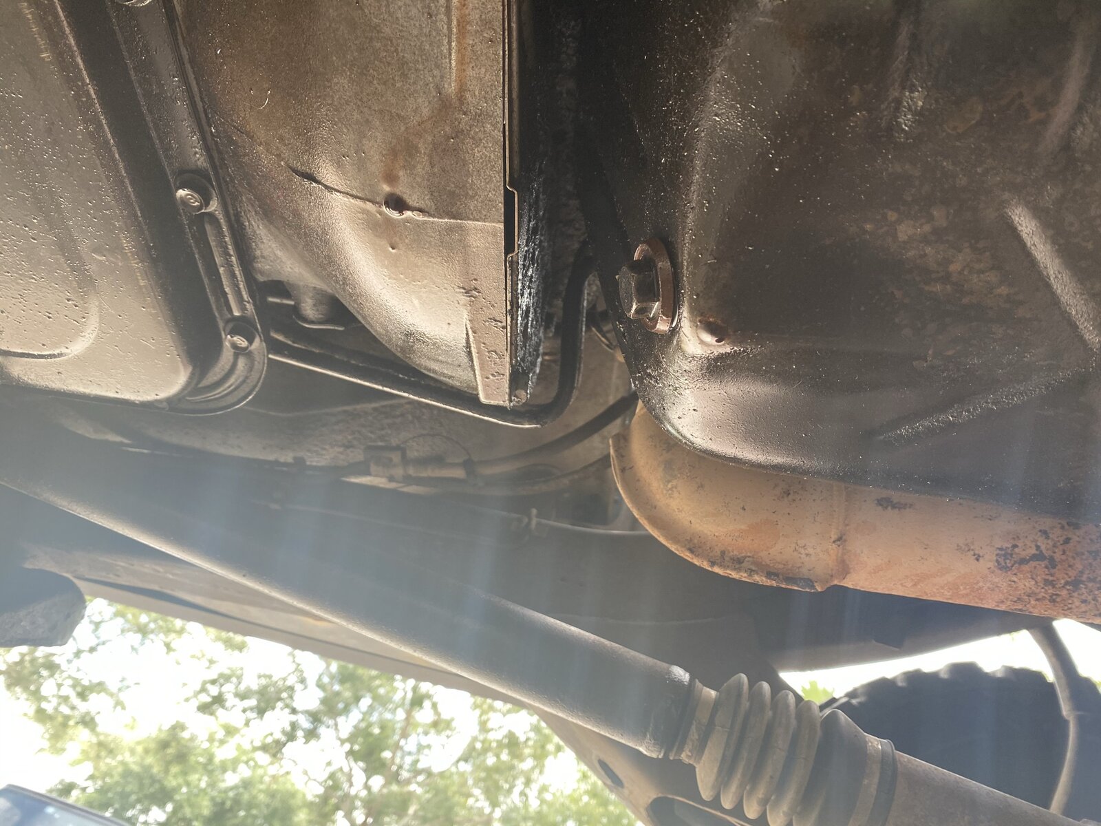

All taken yesterday immediately off of the tow truck, it is literally everywhere underside, washed it off and going to do a leak test later today. Had to push it into the driveway because it was empty on fluid. Nothing on the stick, fluid was tinted brown but I think that was just because of the dirty skid that I looked at it from, was definitely not motor oil.
First thing is to find out where it’s leaking from. Could just be a line ruptured? You may have to put fluid into it to see where it’s leaking from.

Just did a test on the transmission to see where it was leaking from. To my dismay, I filled it up and turned it on to see that it was not leaking at all, but instead from the filler tube there was white smoke was coming out. Gonna talk to a mechanic to see if it is safe to drive around the neighborhood to see if it is driving weird.

I brought it back into my driveway and saw white smoke coming from the driver's side underbody and naturally looked there first, completely dry. There was more trans fluid on the exhaust, and I think that is where the smoke was coming from.
