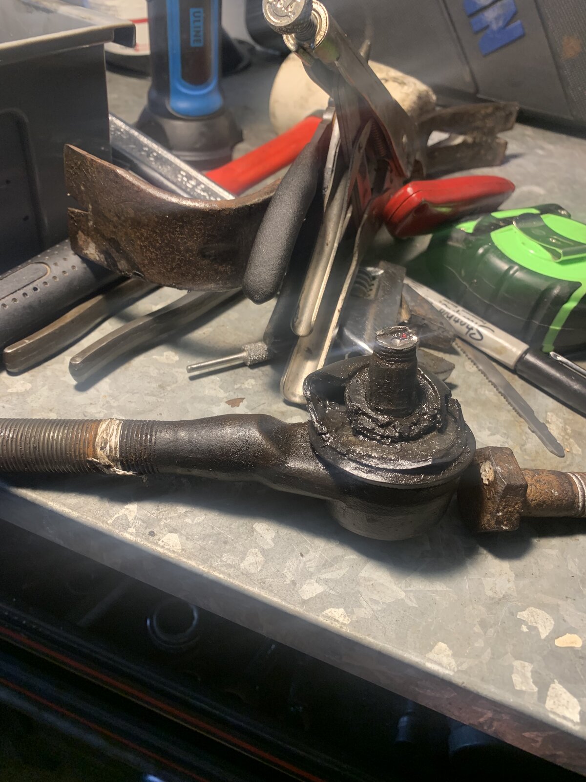

Replacing my inner TRE because how when i did a dry steering test it had a bunch of play. Well the problem is whenever I tried to unscrew the castle nut the stud turned with it. I have tried to put vise grips on the stud and try to use a wrench but nothing seems to work. I tried drilling through the stud but it is taking too long and it didn’t go far.
I was able to get the rubber boot off and might be able to get a jigsaw in there to cut it off but I ran out of sunlight.
I just wanna see if anyone else has any other ideas, I will probably pick up a pickle fork in the morning and maybe a torch
thanks guys

Stop being silly and use a jack to force the pin deeper into the taper. That will lock it down so you can zip off the nut.

I jacked it up to the point that the tires are starting to come up and It is considerably tighter but I cant get it with a wrench. Would an impact drill be worth it?
Well went to Ace to pickup a impact but saw that drill bits were cheaper, $200 impact or $6 drill bit? Well impact would have been a better investment but the drill bit did its job.

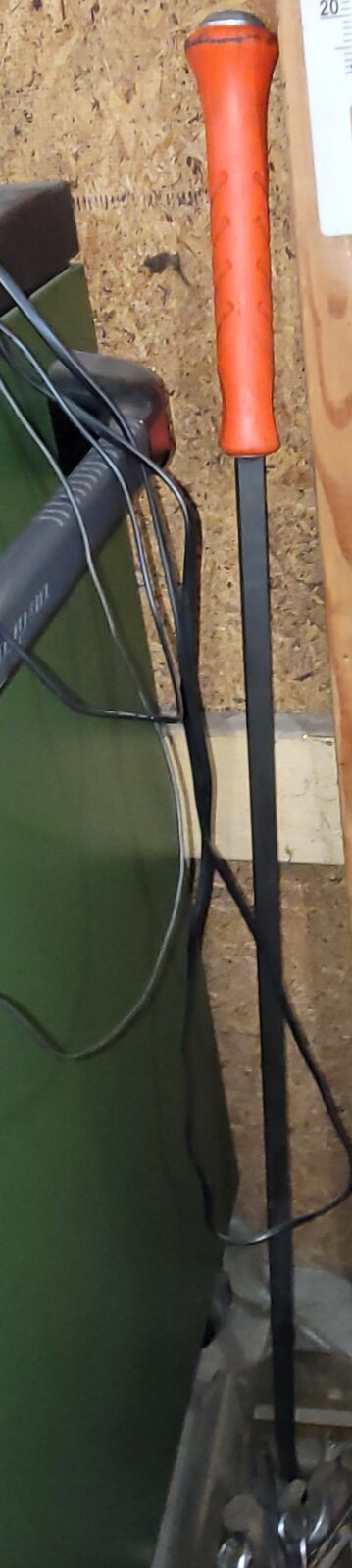

We use this...for pesky TRE's at times...among other things.
4.5 foot pry bar
