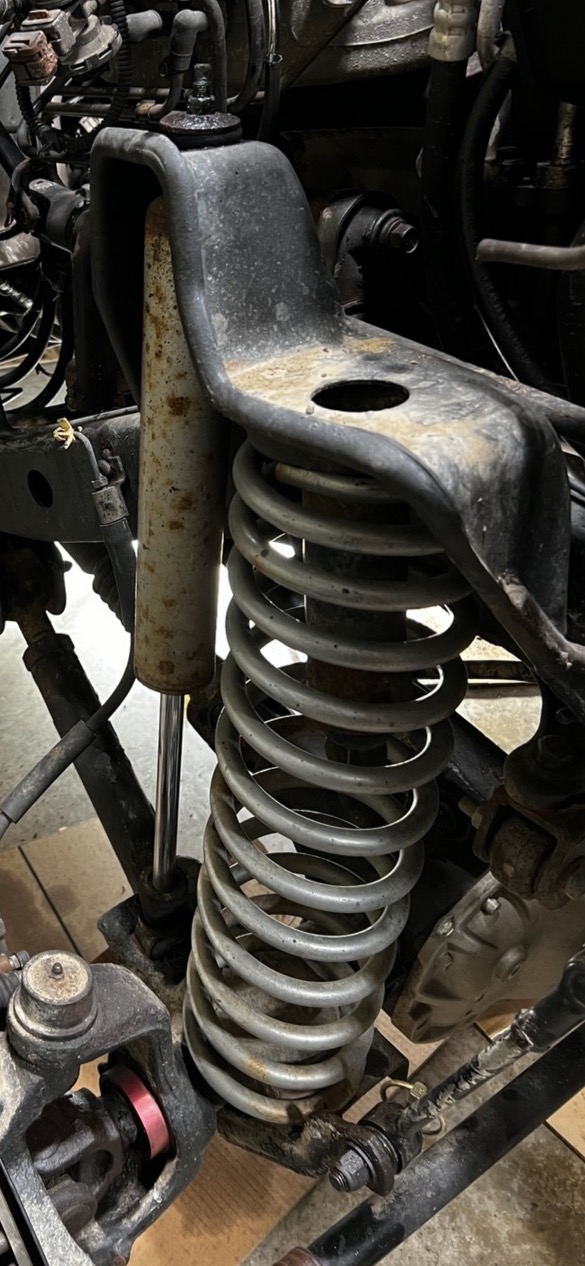

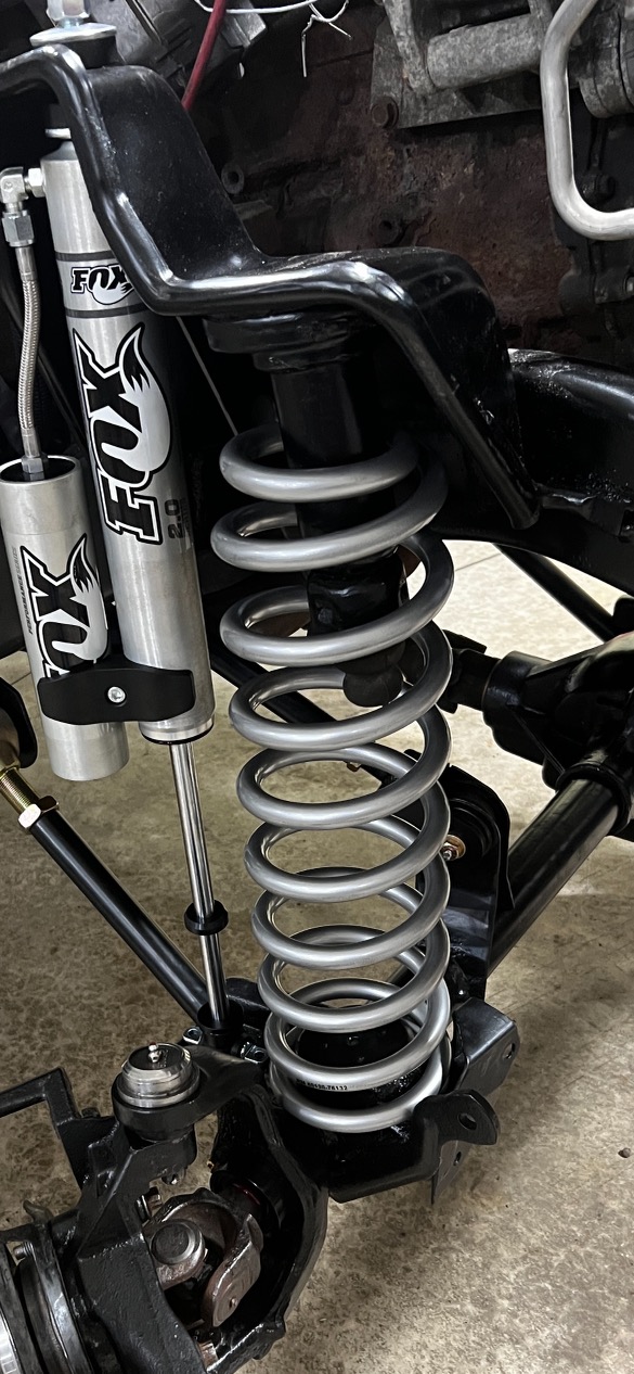

The first question I ran into last weekend has to do with the springs. I took the Dana 30 front axle out, painted it, replaced all the ball joints, control arm bushings, wheel bearings, outer axle seals, and just cleaned up the whole axle. When putting the axle back in, everything went smooth until I got to the springs. I did notice the new 3.5" Rubicon Express springs were much shorter than the old 2.5" Rough Country springs out of the Jeep. When I put the Rubicon Express springs in, they just slid right in with absolutely no tension at all. There is almost three inches from the top of the spring to the top of the spring tower (See attached before and after photos).
I set my new control arms to the same length as the rough country ones that I took out but added about 1/4 inch in length to give me a good starting point that accounts for the additional lift (the guy at the local alignment shop recommended I do that). What might be the cause of there being so much gap? Is this not even an issue and I'm worried about nothing? Any input you all have would be greatly appreciated!

Did you measure spring height before taking the old ones out? Did you measure new ones after putting them in with the weight of the jeep on the springs? What were the free lengths of each spring?

I did not measure the spring high of the old ones with the weight of the vehicle on them. I can put them back in and get that measurement.
I also just got the jeep back on its wheels last night so I can grab the measurement of the new springs with the vehicle weight on them.
When I have them out, I can get measurements of both sets without any weight on them. I do know that the new rubicon express springs were at least 2" shorter than the old rough country ones.
Also, I dont see a track bar or steering setup up in the first picture, so your axle is seeing a bit more droop. Hook those up and then cycle your suspension.

Thank you, @tworley. I didn't know the axle would droop more without those connected. I will get those connected tonight and see if it makes a difference.

Its still early and I havent had coffee--you wont be able to cycle your suspension with the coils in place, but if your trackbar gets installed that will still limit the amount of droop your axle sees.
Sway bar is connected in the before picture, but not the after. That would account for the axles droop
I knew what you meant. I still need to pull the coils and cycle the suspension to get my bump stops set up. Just been waiting on parts to come in. I will get the track bar and steering components in tonight with the coils still in and see if it reduces the gap.
I did think about that as well. I upgraded to the SwayLOC system and haven't had a chance to install it yet. I will try to get it in soon to see how much it brings the axle up.
