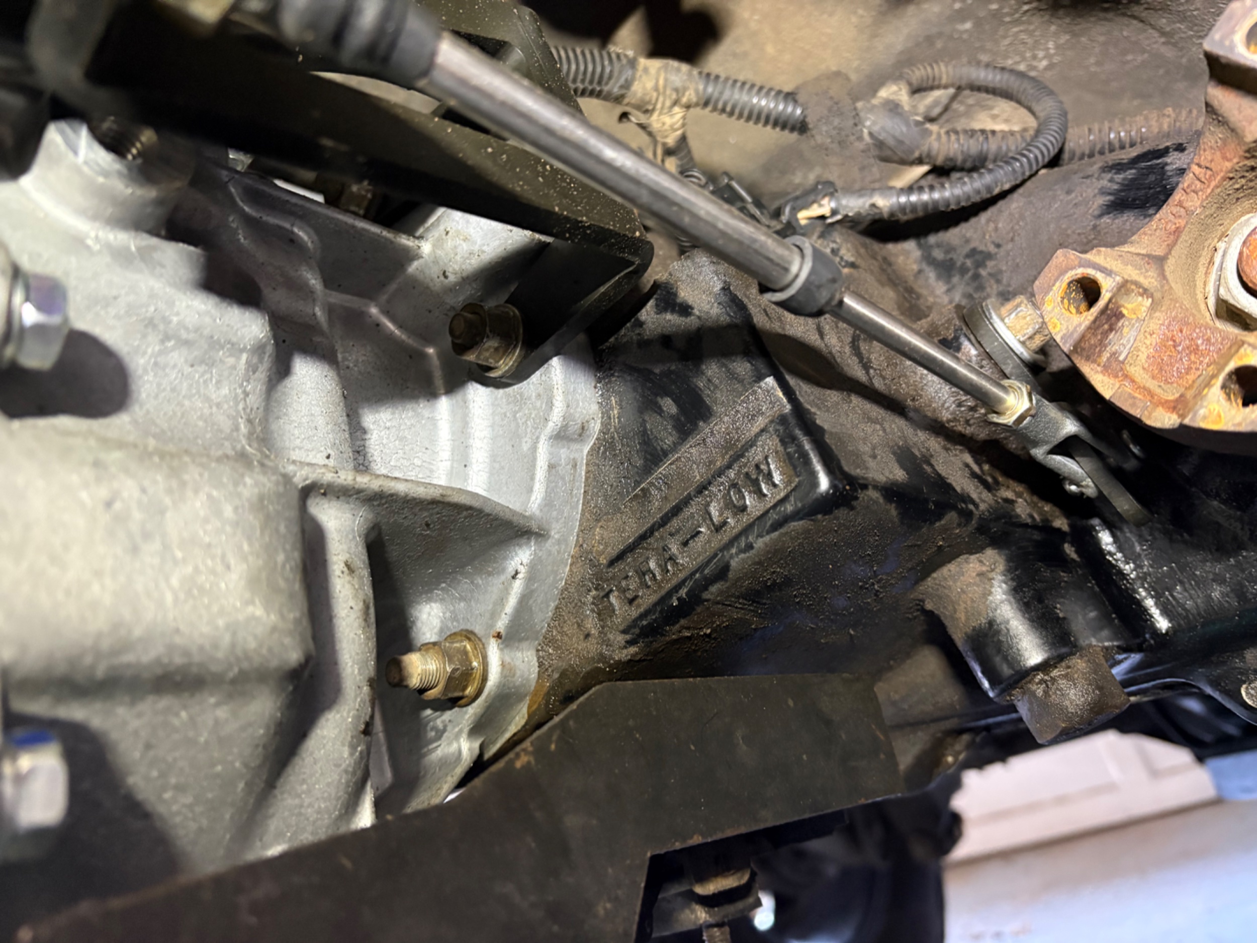

Well, starting taking stuff apart in anticipation of my JB conversion short sye that should be here on tuesday. Dropped skid, drained, removed driveshafts, started cleaning up the front of the transfer case and uncovered through the grime that i have a tera-low. Not sure if thats good or bad, but it seems to work fine.

Keep your foot out of it when in low range... If you look up the TeraLow online you'll find the installation guide where it warns you to keep your RPM's under 2500-3000. Don't keep your RPM's higher than that for extended periods.

I'd have to go back and read the instructions... As I don't remember other than them saying to keep your RPM's down. But I also know I used to rev mine up above that but also wasn't bouncing it off the rev limiter or extended periods. They've been discussed on here a few times and a few members had one that exploded. I know @JMT has one in his Red TJ.
Per their instructions:
High RPM Warning Do not exceed 2500-3000 RPM for sustained periods of time when using the Low231 in low range.
Avoid high engine speeds when using the Low231 in low range in 4th or 5th gear with manual transmissions or with high gear automatics. This is common when driving in snow, mud, or sand.
Because the gears are turning 50% faster and with the high gear ratio, it is possible for input speeds to reach 6500 RPM and cause damage to the transfer case.
We recommend using a lower gear in high-range for higher speeds rather than running the Low231 at extreme RPM’s.

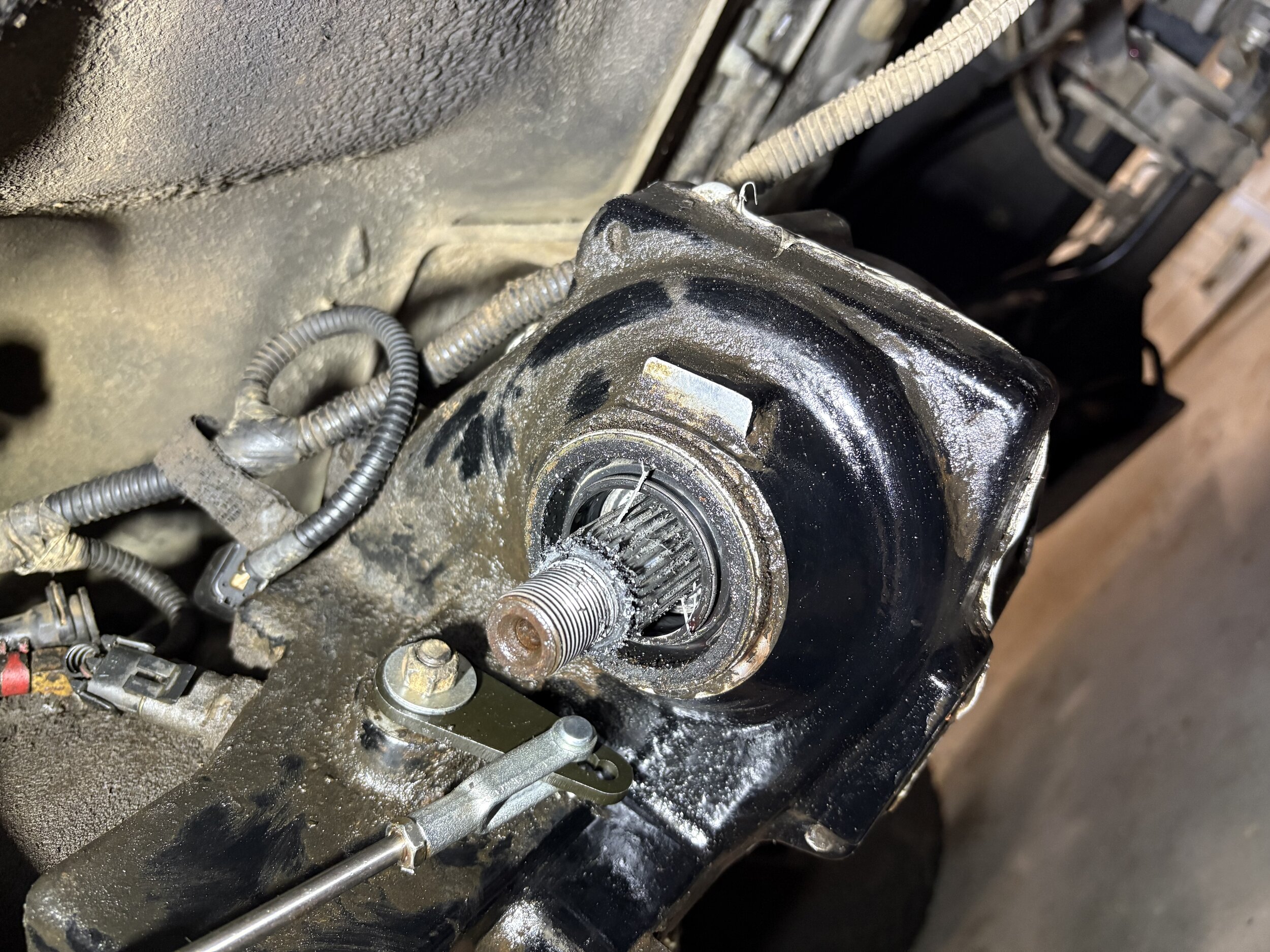

Ok, this front yoke nut is fighting me. Not sure if they red loctite it on or something. Maybe i just need to pull harder. Im worried about damaging something.

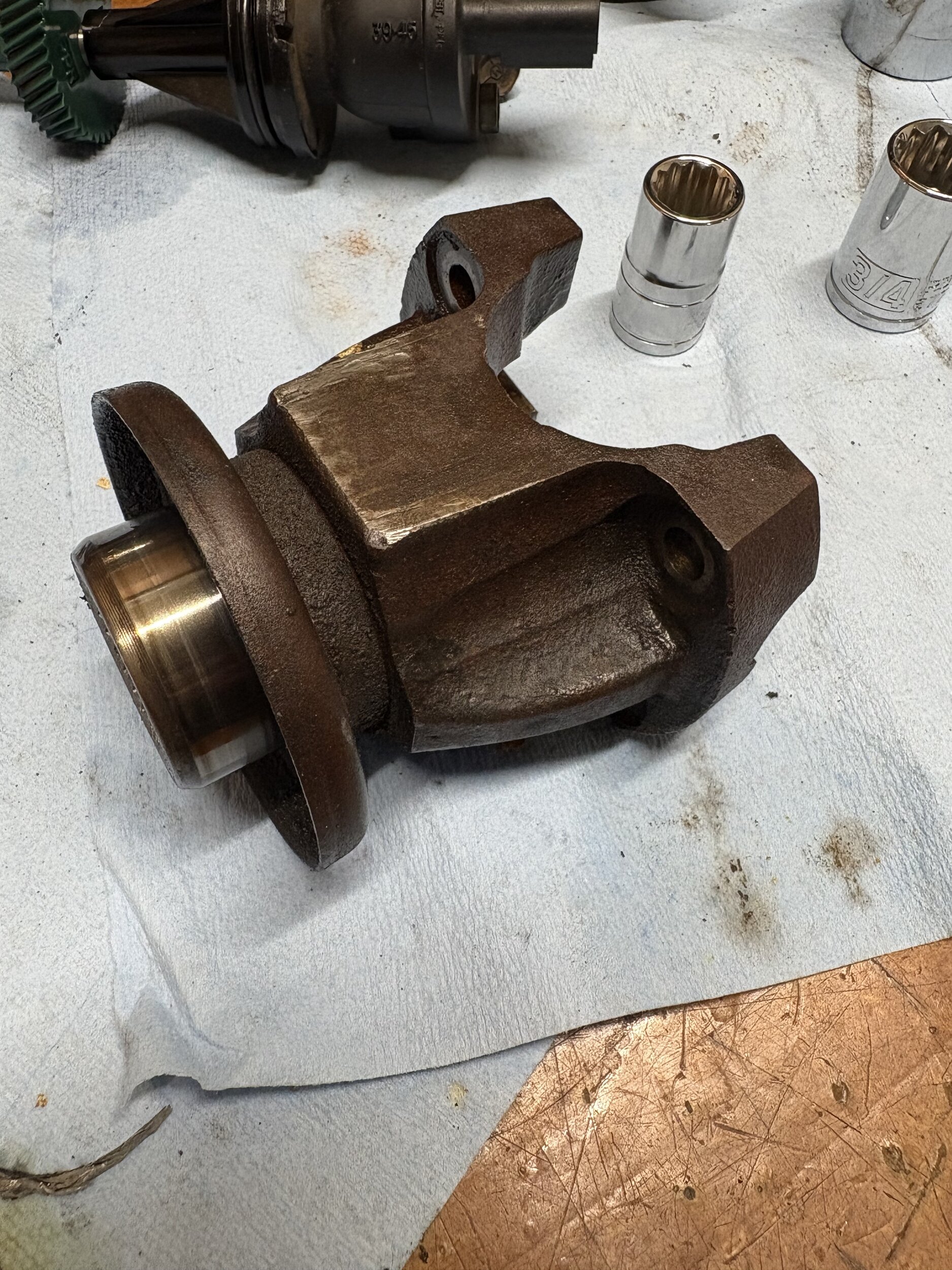

Well, got the nut off the front yoke. Took the yoke off and part of the seal appears to have come with it. Does this look normal? What do i need to order?
Reactions: Siwash89
That's just a dust cover that is a press fit. It is not part of the seal. It can be removed with some gentle tapping using a wide punch.
Does not need to be removed though...
I really would have cleaned around your seal/yoke better before taking things apart. Try to wipe away and vac out all the rtv and trash, be careful prying out seal to not scratch bore and drive your new seal in.
Reactions: NashvilleTJ
Might want a thin schmeer of RTV on the outer ring of the seal where it contacts the bore and don't forget RTV on the threads of the yoke nut. Ultra Grey works great here. Black is good too but it really glues things together making future disassembly fun.

Thanks for the help. I will probably tape over the seal, and clean around it better. Then get all the old rtv off.
Going to start taking apart the case tonight.
