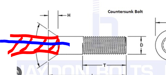

So, this is crap mock up of what I'm talking about with the blue being a pilot bit and red being the "cutting" drill bit. On an M8, a 3/8" drill bit should be just larger than the shaft of the bolt (if you hit it dead nuts center).
You can then attack the shaft which should be easier to get out, sometimes as easy as hitting it with a bit in reverse after it catches.
If you have a welder, the nut method is probably faster and probably kills the bond of the paint at the same time.

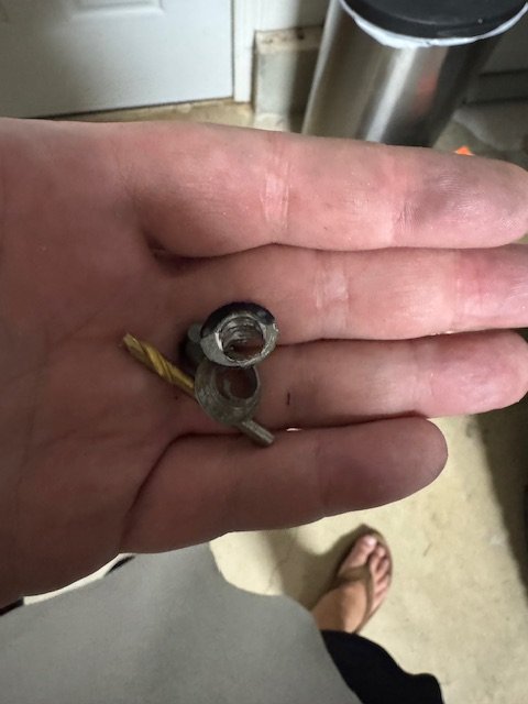

Thank you so much for this and @mrblaine . drilled them all out very careful and got one side done will have to tap and die one of the last remaining bolts and accidentally drilled all the way through it . No big deal for me will just have to take extra steps when I work on it next .
