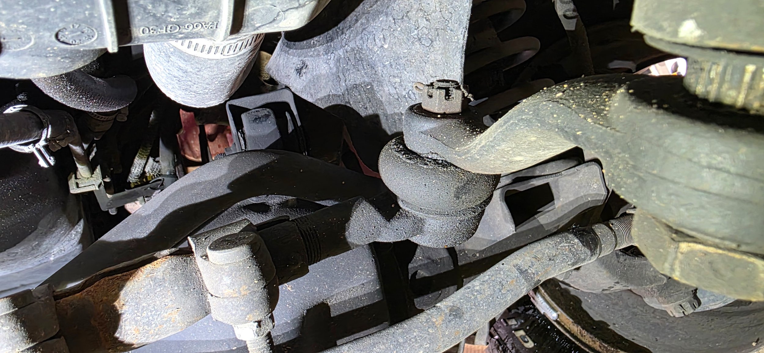

I looked around and I think maybe too much play in tie rod? I replaced those a few years back. There shouldn't be this much play should there?
Guess i can't post short video. But that castle nut moves a lot.

Or you could prop your phone up and start recording your front end while you do the dry steer test. I also like to turn to full lock left and right at the end of the test. When I did that it really magnified my loose track bar axle bolt and some other loose bolts
Well, I was out must if the evening, but came home and tightened that nut way up. Seems much better, so not sure what the deal was and why loose. I'll get a new end and replace.
Everything else looks fine. I upgraded everything a few years back to the ZJ, but had to replace the gear box, so maybe in that swap it for some reason wasn't put back as tight, but that was almost 2yrs ago itself.
So, I looked it up it was 2021 that I did the front end swap to ZY. A year or two since I did the gear box. Ran with Amazon ordered moog parts following links provided by thread on here dealing with the conversion.
Reorder, that tie rod is $30, right now, but a week or so out. O'Reilly is $50 for their master pro end. I can look elsewhere, but hard to find some of this local. Opinions on this?
I'm also considering loosening it and feeling for play, maybe it's ok? But something tells me if loose for any amount of time damage is likely done?!
Thoughts here?
I'm thinking the reason somewhat loose is i tightened it down and now the cotter pin is almost out of the castle nut. I went about turn, maybe just over. So, on install it might have seated, hit torque and aligned fits with cost cotter and called good, then things 'settled'. ;) I'll check torque specs tomorrow, was just curious tonight so played with it for 30 min.

I have not YET, I will. I tightened up last night kind of late and then ran it around the neighborhood hitting the brakes hard and doing various turns, etc. Everything felt tight and she had somewhere she wanted to be this am, so I let her take it to see her thoughts.
When she returns, I'll crawl under pop off the tie rod to see if it feels like it's got excess play and either re-install or re-place it going to torque. I have noticed torque doesn't seem to 100% align with cotter pin alignment. Meaning either way to high or too low for pin to do any good.

No need to remove it to check.
Take 5 min to pop it loose. Wouldn't that tell me more about looseness and ability to feel if something on the joint feels off?
If on how do I know? I did the dry test and no other movements with everything tight.
Where would popping come from also?
Maybe ball joints?
It may tell you less if you remove it, because you can't put as much pressure, sideways, on those joints.
Just do a dry steering test. Have your daughter rock the steering wheel back and forth slowly and firmly while you watch each joint closely (or take a closeup video of them to watch later). Look for movement between the two components.
Will do. Spoke with an uncle who's a retired mechanic, he agrees to just watch it and see over few days.
I'll double check torque as well and it needs new cotter pin.
I just know some of the steering issues in these jeeps are a bit different than other cars it seems. Just a week or two ago, she had it on interstate for 1-1/2 each way to visit a friend at her school. Said it handled great at 75. I'd have thought if that tie rod was that loose to show now it should have shown then.
