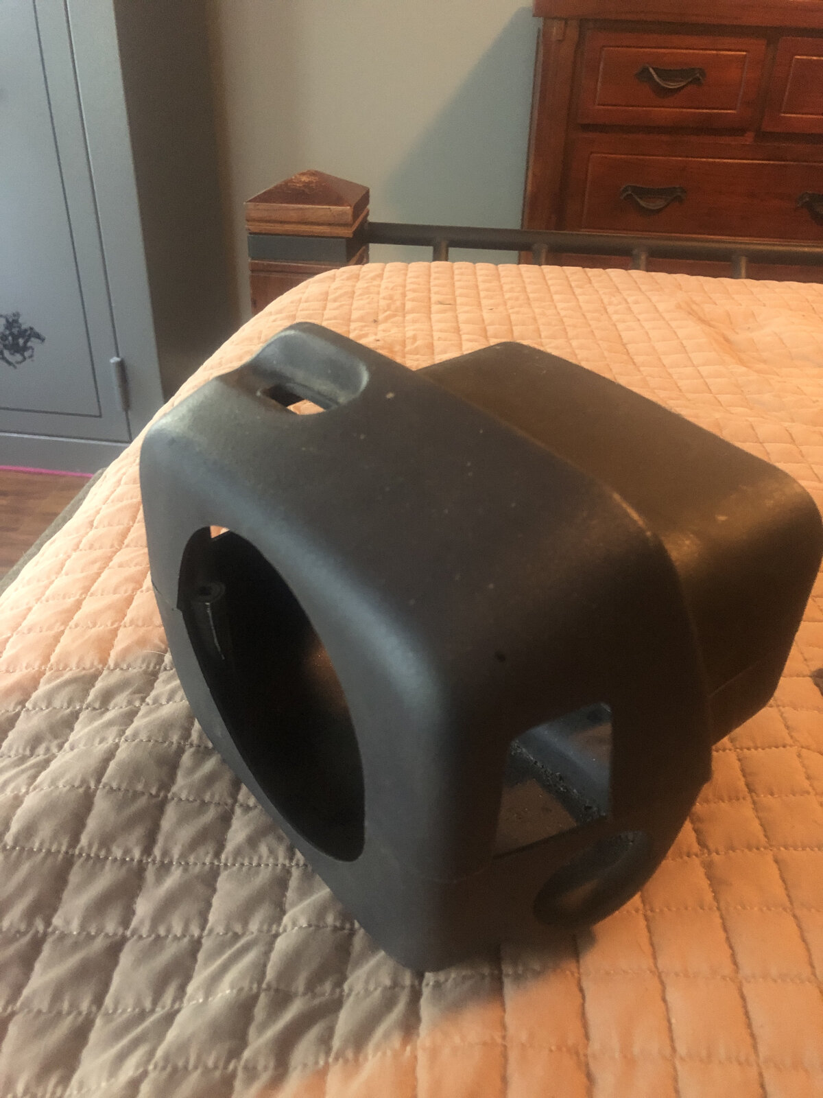

I purchased a 2002 TJ that was missing the steering column shroud cover. I purchased the part online and am having no luck getting it installed.
I have checked and double checked to make sure I have purchased the right part for my jeep model.
is there any tricks for what should be a simple install ?
It’s two pieces. The bottom piece seems okay but the top piece doesn’t want to fit down over the flasher knob
couple things..do you have a tilt wheel? does the cover match that? they do require a little finesse to get in place..if you have tilt place it in the lowest setting to give yourself more room. do you have the 2 screws to attach the halves?
