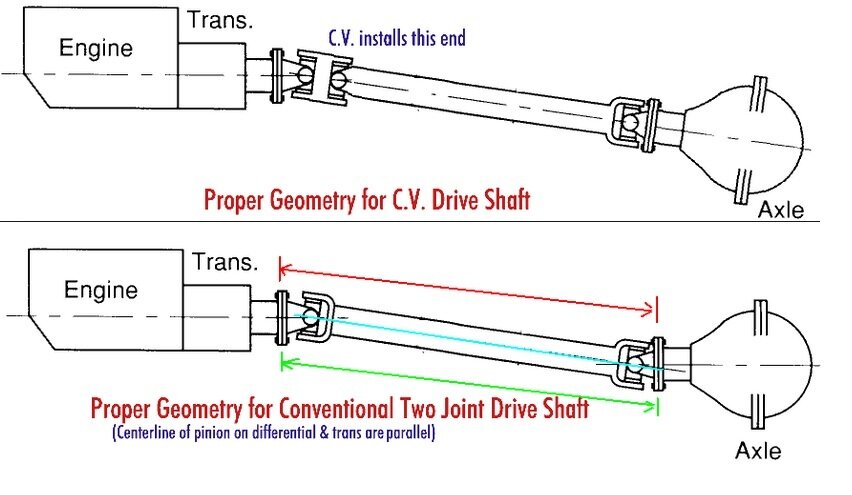

Sounds like it would be the wrong driveshaft angle. Take a look and make sure that the pinion appears to be pointed at the transfer case output. If it wasn't set properly for ride height it could be off a couple degrees causing vibrations.

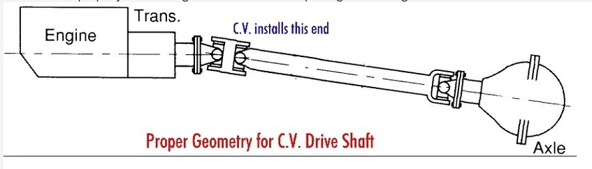

Rear drivetrain is theoretically setup correctly per the CV illustration, but I have not personally measured/verified the pinion angle. Would be a good sanity check to do to confirm it is correct. I do know there has been some adjustments since first install.
