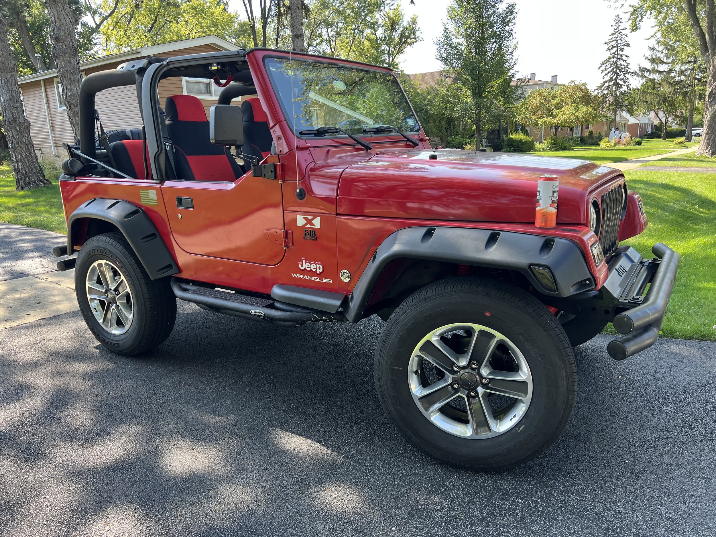

Idk what to do anymore on this pos
The previous owner did the frame repair kit on my TJ, which is why I got it so cheap, but in doing so they technically made the frame twice as thick RIGHT where I need to drill holes to mount OEM side steps.
I drilled and I drilled for over an hour to get two holes to test and the crappy u-bolts that mount the steps doesn’t even fit because shocker-the frame is too skinny now to fit the u-bolts
So next plan- I get body mounted steps without checking here first. First bolt I go to loosen goes POP and breaks with no real effort.
How do I mount steps without drilling into the body and doing tub mounted ones? Has anyone welded or mounted steps on a repaired frame? I’ve about had it with this jeep as everything I’ve done on it is 10x more complicated than it should be. That’s coming from someone that’s drove Audis for 10 years…

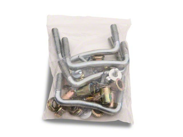

Are you saying the nut bottoms out on the U-bolts before becoming tight?
If so I have 2 solutions. 1) backer plate 2) cut more threads on the U-bolts.

So the kit uses these instead of nutserts. The issue I’m having is that my frame is too skinny now and when I try to fish these in as they do in the video, the ubolt is physically too long to get it turned around in there. Kinda hard to explain and I am not near the jeep currently to show it
9:45 into the video shows the guy fishing the ubolt in. My jeep frame is too skinny now to fit the u bolt in there like he does. It gets caught on the back wall and can’t turn back towards the front where the other hole is.

Are the holes you drilled through the frames safety cap? Nothing you did changed the INSIDE dimension of the frame rail. All you did was add thickness to the outside of the frame. I suspect the combination of the hole size and new wall thickness at the safety cap is preventing you from making the turn with the u-bold.. binding in the first hole. Maybe make that hole a little larger?
I think my strategy now is just to thread the hole I made and throw some grade 8 bolts in it and forget it. If it comes out im just gonna weld it to the frame lol
