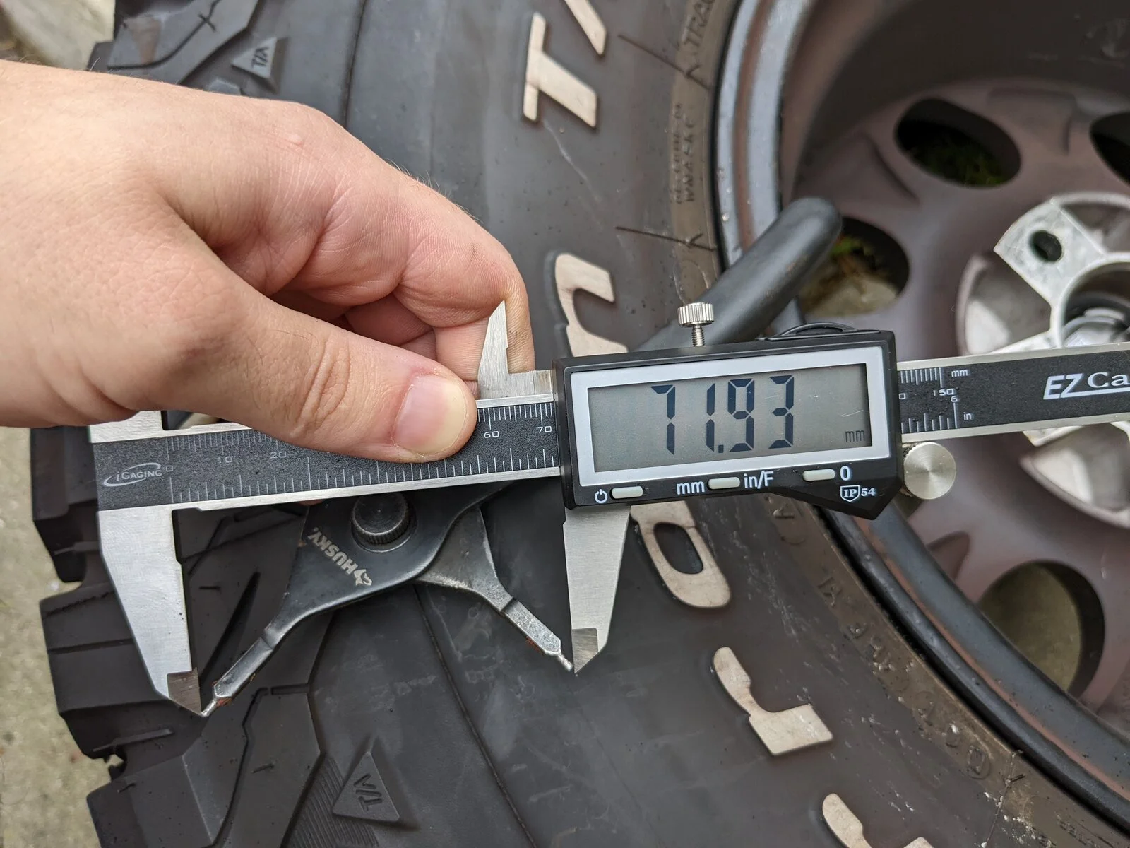

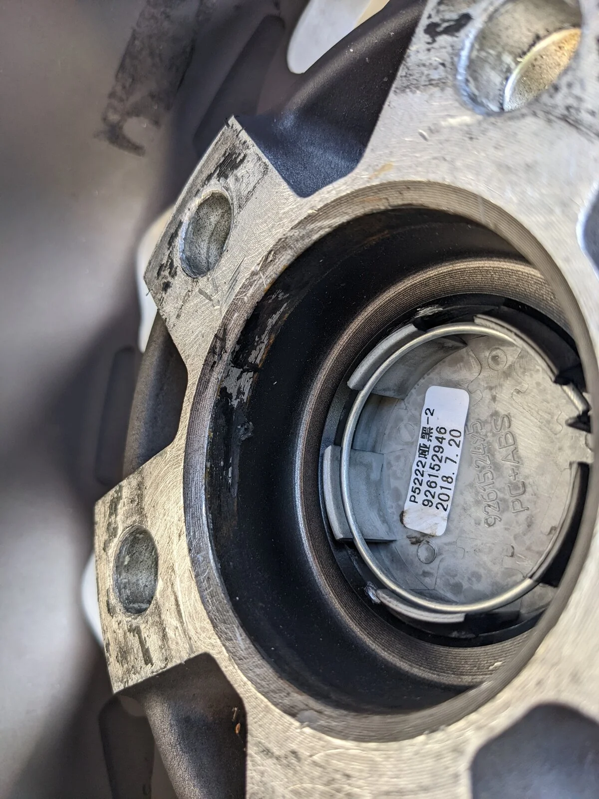

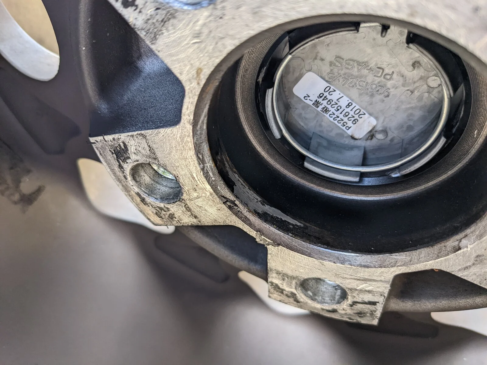

I forgot to include this response to a question from their website, this is why i am so focused on measurements and fitment of this rims.
Hub centric - snug fit - close tolerances (but not super precise)
There is plenty of wiggle room in center bores when i set dial at 71.5mm.
I have dealt with hub centric wheels before, they had centric rings/ spaces that assured a proper fit, and they had a snug fit - just enough to be mounted without a need to use a mallet. In comparison what i have is a loose fit, not snug.
