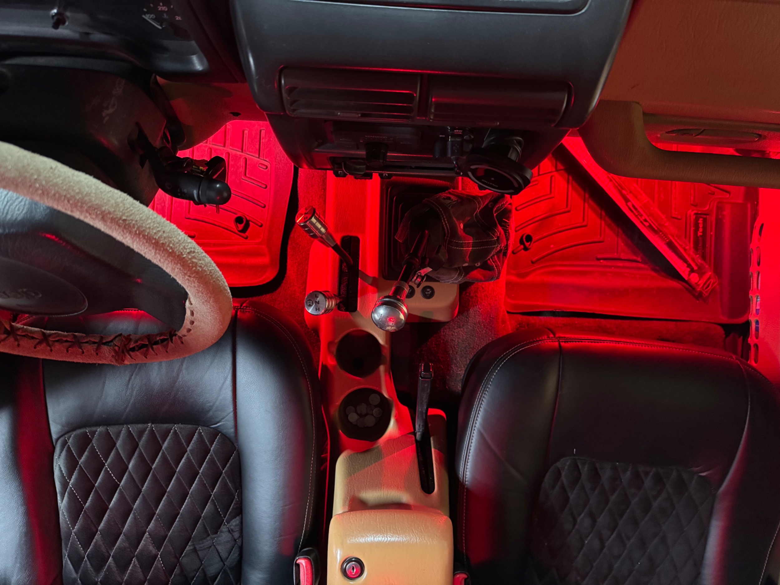

Just installed new seat foam on driver side. Reinstalled the seat and noticed it is pivoted slightly outward, away from the center console. Passenger seat also, but not quite as much.
I can’t think of anyway I could have caused this during reinstallation, so perhaps I never noticed it before. Anyone else have the same pivot angle to their seat?

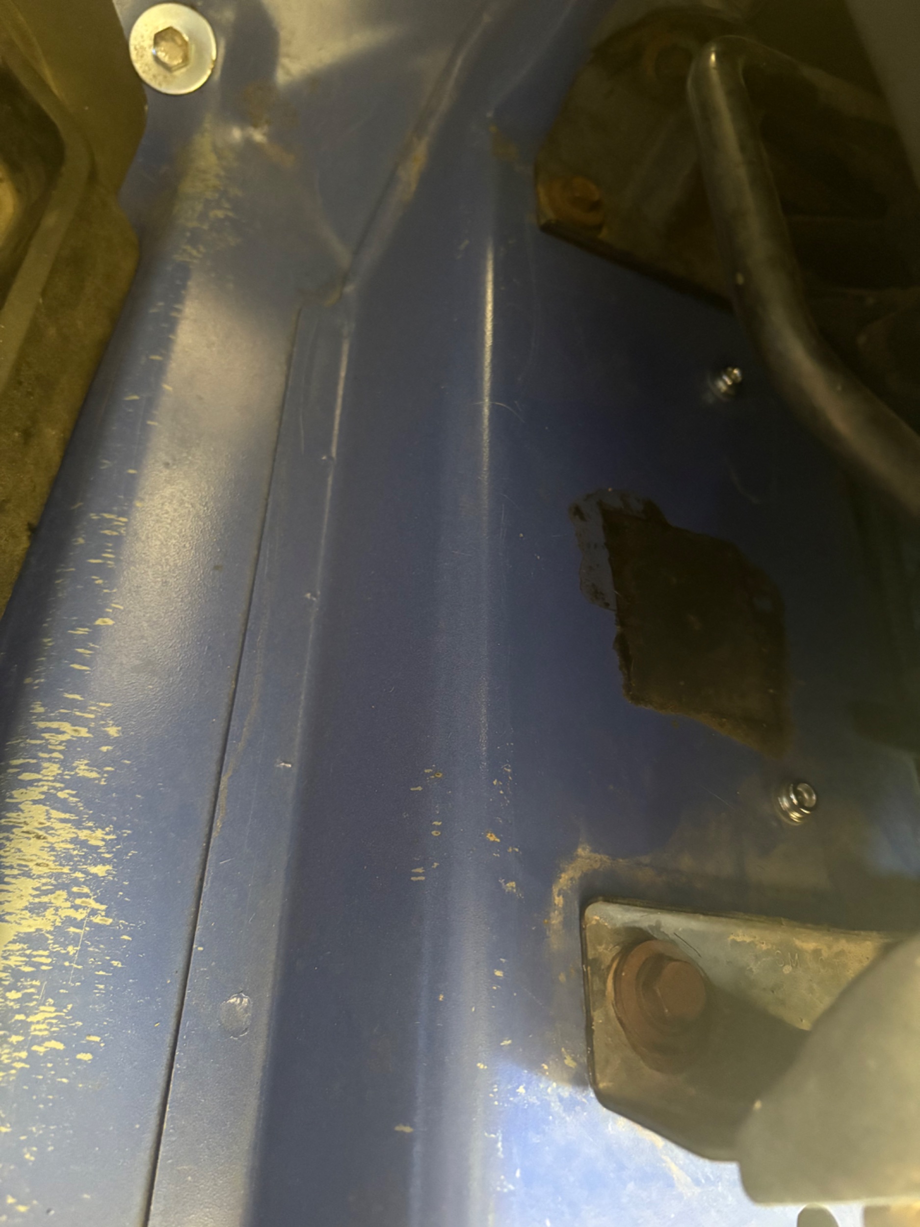

I just looked at my 97. It’s kicked out in the same way as yours, but I noticed there are witness marks where the frame bolts to the floor showing I may have not tightened it down square.
I'll check that. Did not realize those bolts had any play to them. I wonder if I did the same.
I took my seat out a few times trying different combinations of lowering brackets and big boy brackets. There's a LOT of play in how the brackets bolt in, at least on my TJ. I had my seat looking like yours (crooked) before I loosened it back up and straightened it out.

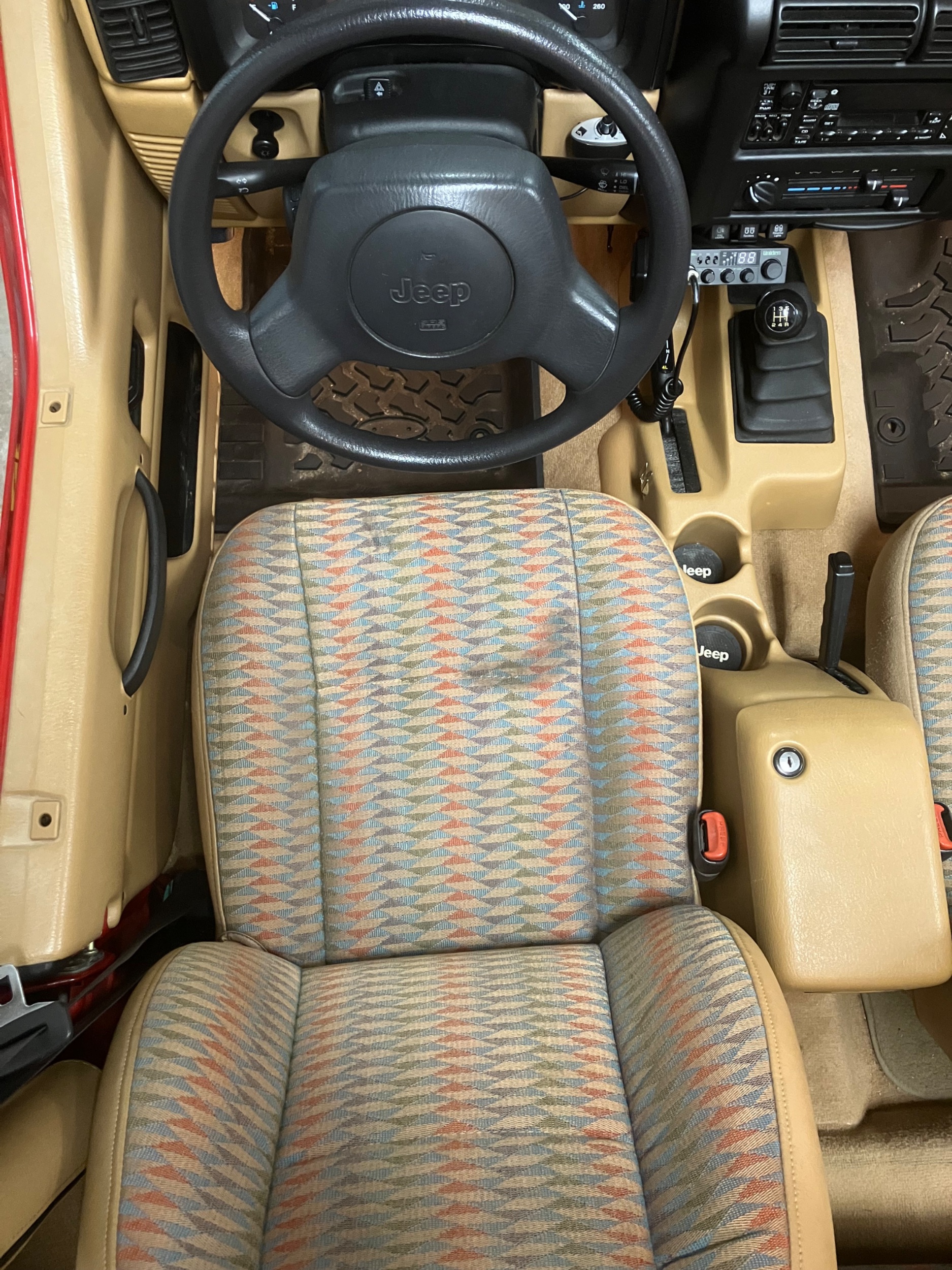

Best shot I could get quickly but I think you can see both the driver and passenger are slightly rotated outboard. Mine is a ‘97. Seats and frames are stock, just recovered. Always been like this. They have been in and out many times.
