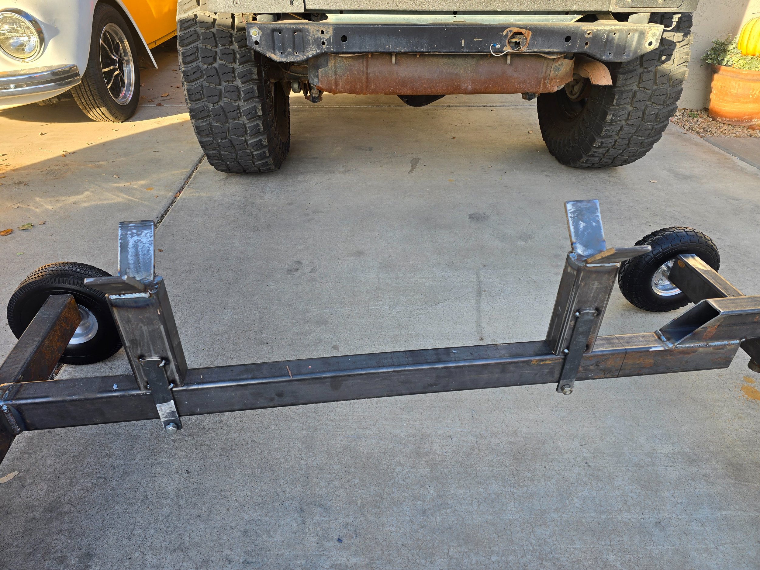

Well as any Jeep owner knows you end up with a surplus of axles from browsing Facebook marketplace 😅😂. Got sick of trying to move them around with an ATV lift so decided to fabricate this heavy duty cart to move them from the backyard to the garage where I can work on them. The axle tube perches are adjustable to fit any size axle and will work with Dana 30s up to one tons(disregard the track weld holding the axle perch clamps, they are fully welded now) . The tires are non pneumatic with 300 lb weight rating per tire on 5/8" axles. The steering tube is double Timken bearing on inch and a quarter axle.
Was a lot of fun to build and will really be helpful around the shop.
