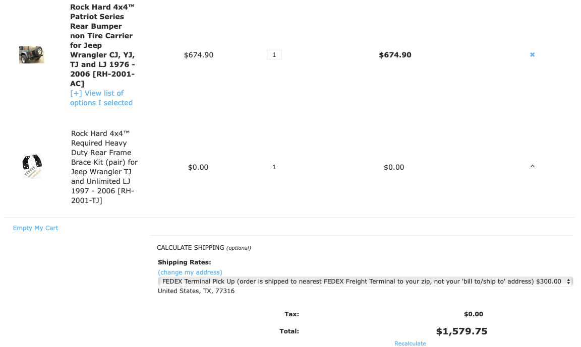

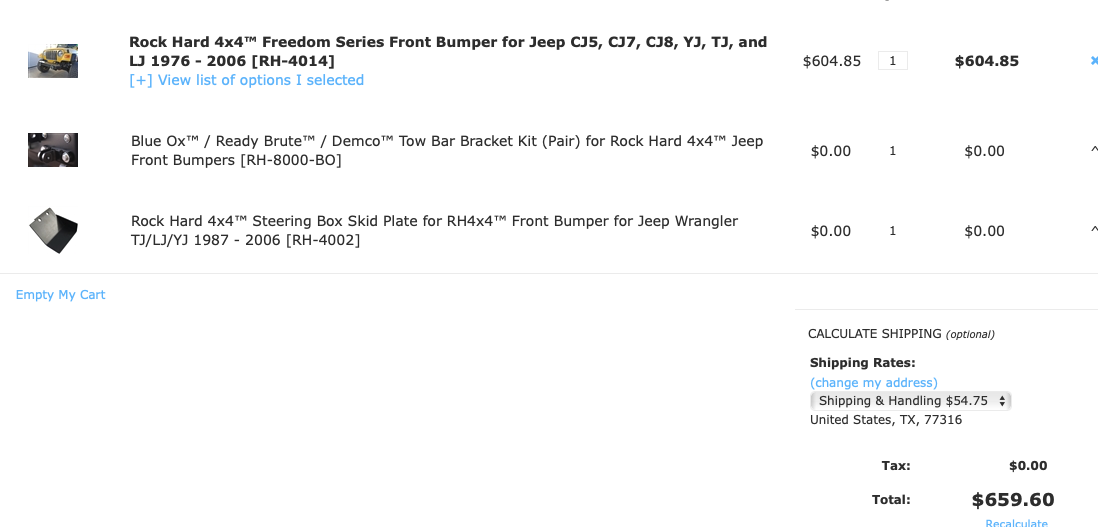

I decided to place an order. The first thing that struck me as odd is their shipping. When I put the front bumper in my cart with the tow brackets, etc..., the shipping was about $55. Pretty reasonable for a heavy steel bumper.

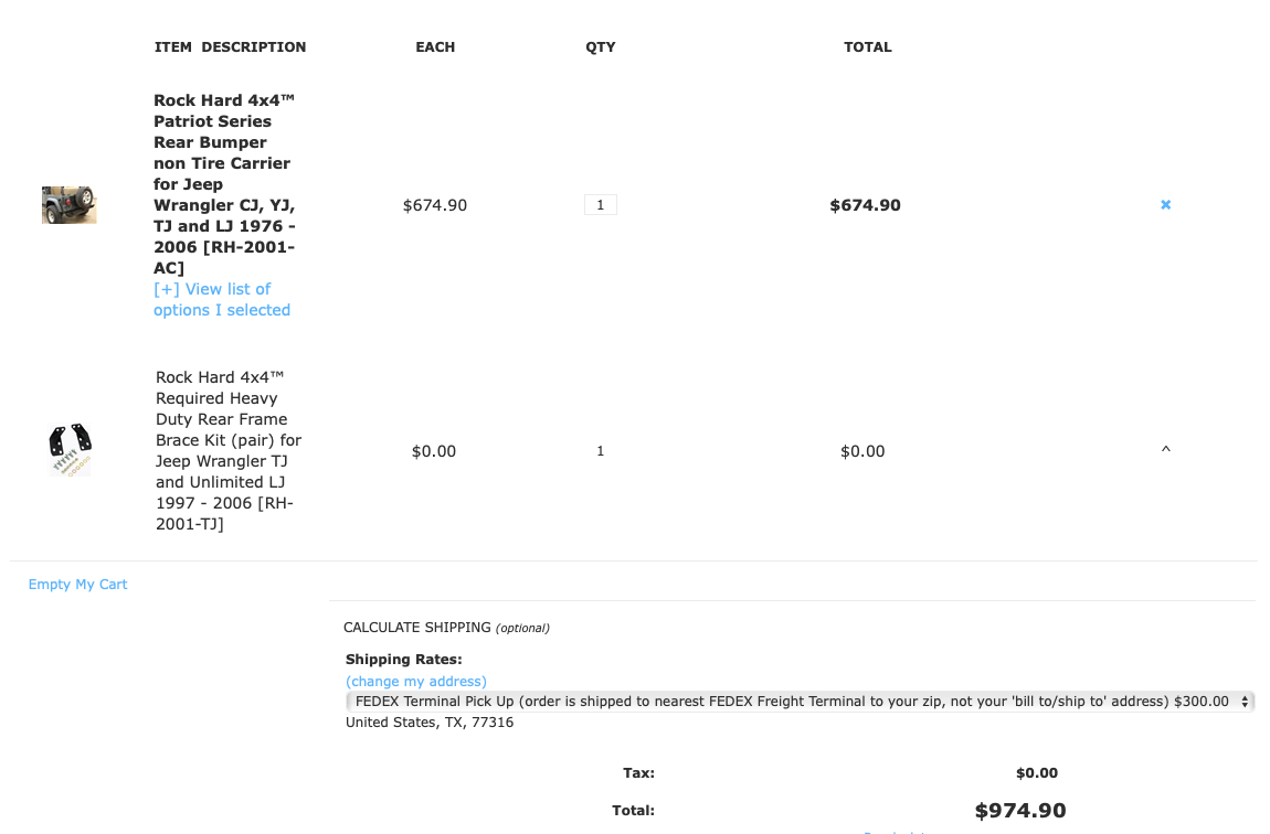

Now when I added the 55 lb rear bumper, the shipping jumps to $300 flat FedEx freight to a local terminal.
At this point, I checked to see how much it was for just the rear bumper, and it was also $300.
So I made a phone call and spoke to a nice guy who basically told me that shipping was expensive now and that FedEx freight was the only way they ship...strapped to a pallet. (Remember this for later)

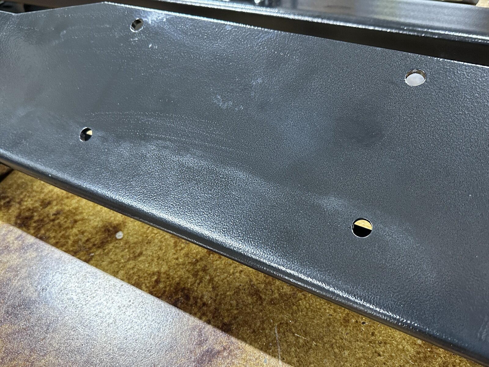

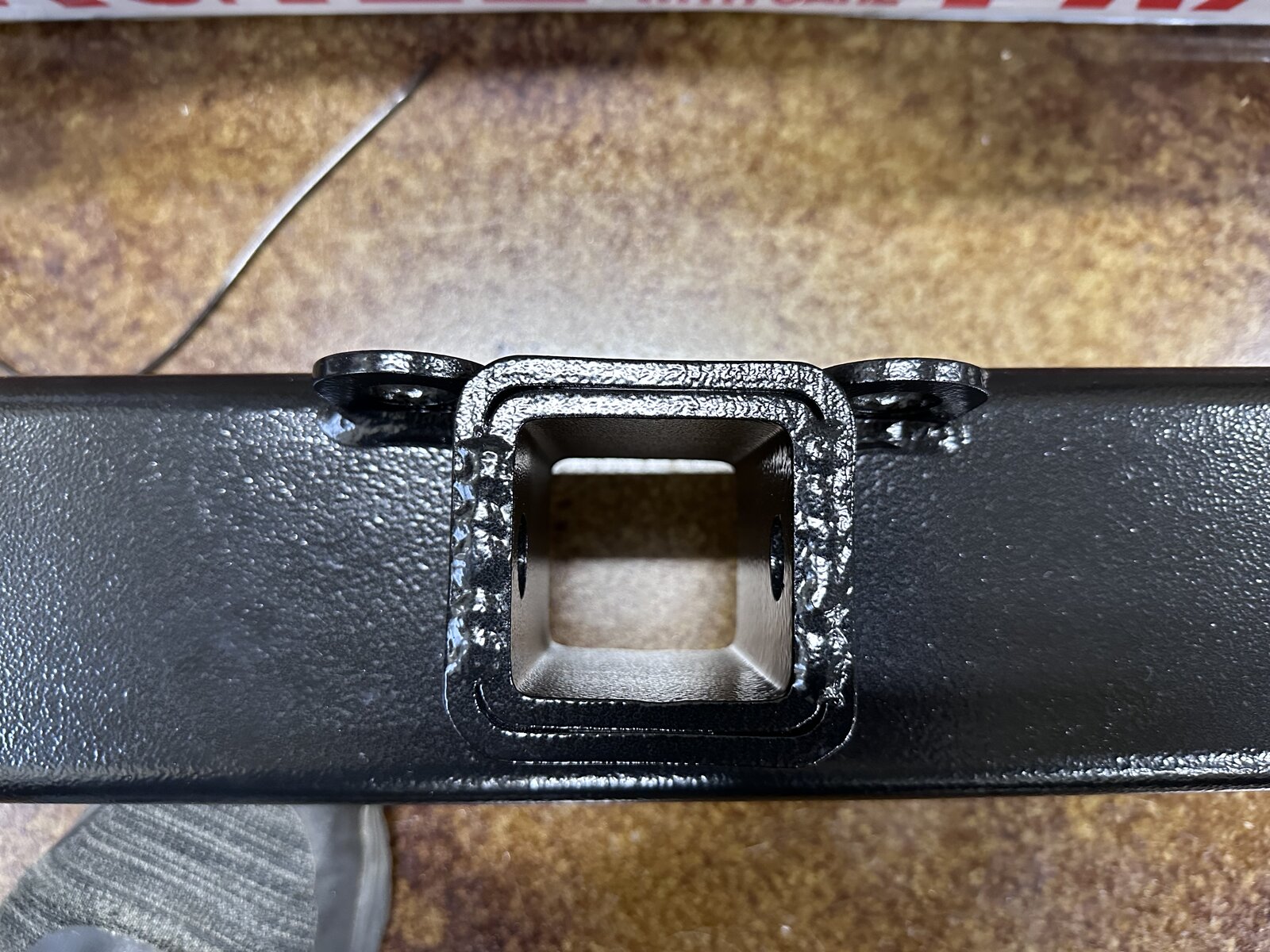

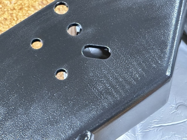

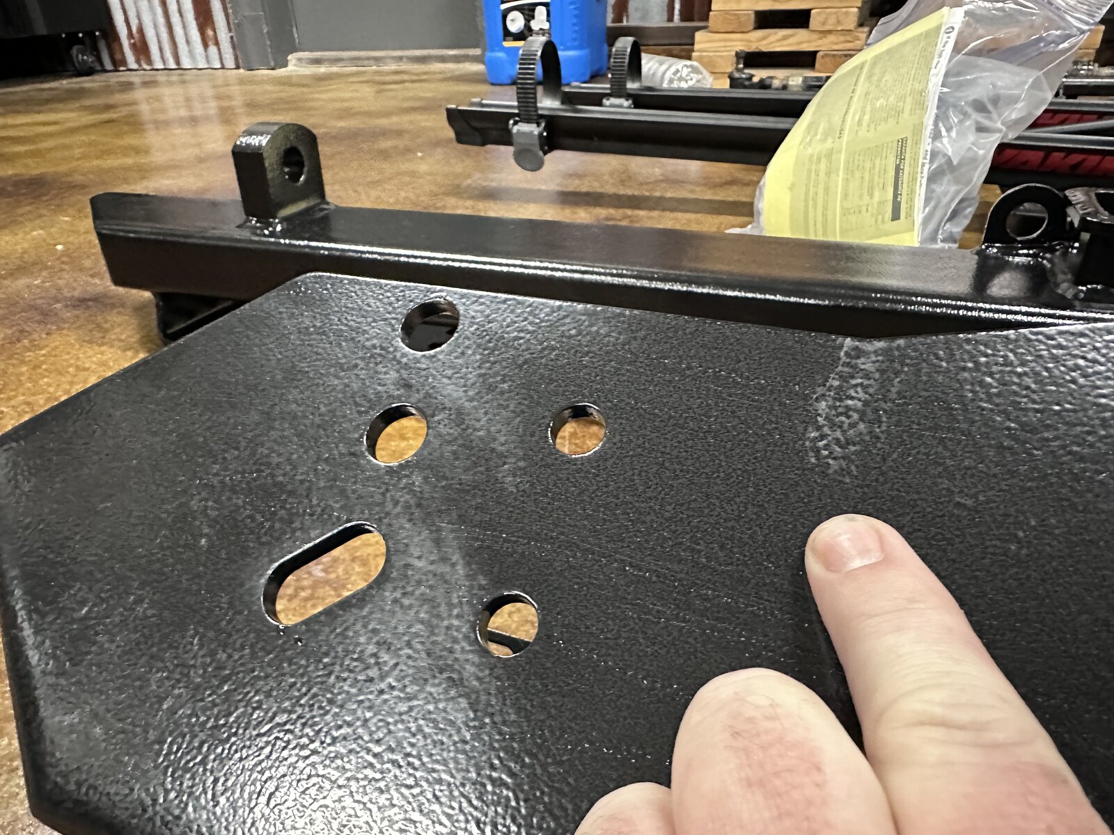

I ultimately placed the order and to my suprise, they arrived at FedEx within a few days. I expected longer. I went and picked them up. When I got home, I unloaded them and opened up the boxes on the garage floor and was immediately disappointed. On the rear, it was immediately apparent that the hitch had been welded in crooked. Not a big deal with a trailer, but a pretty big deal when you have a vertical bike rack off the hitch. Then I started to notice how thin the powder coating was. I could see the lines in the metal from the milling process through the coating.
The lines aren't too bad, but they're there. Then I opened the front bumper box and I was disappointed again. More bad powedercoating.

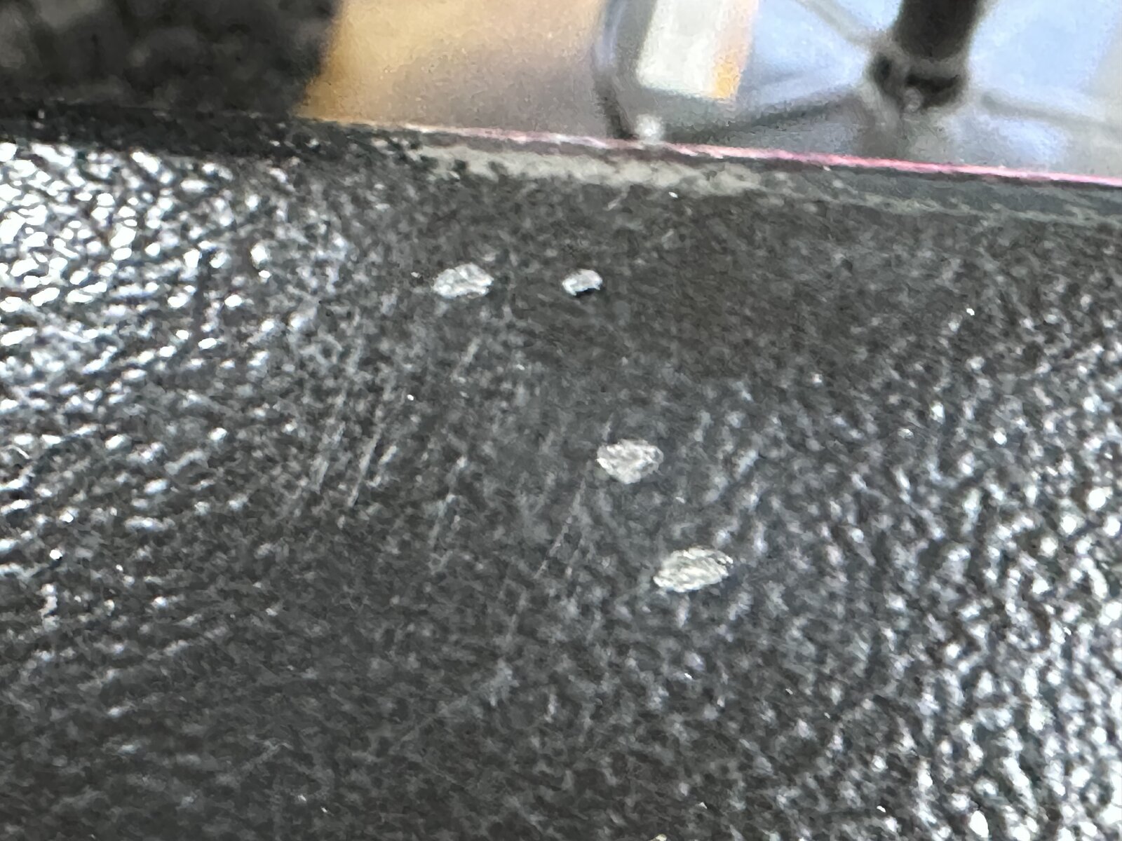

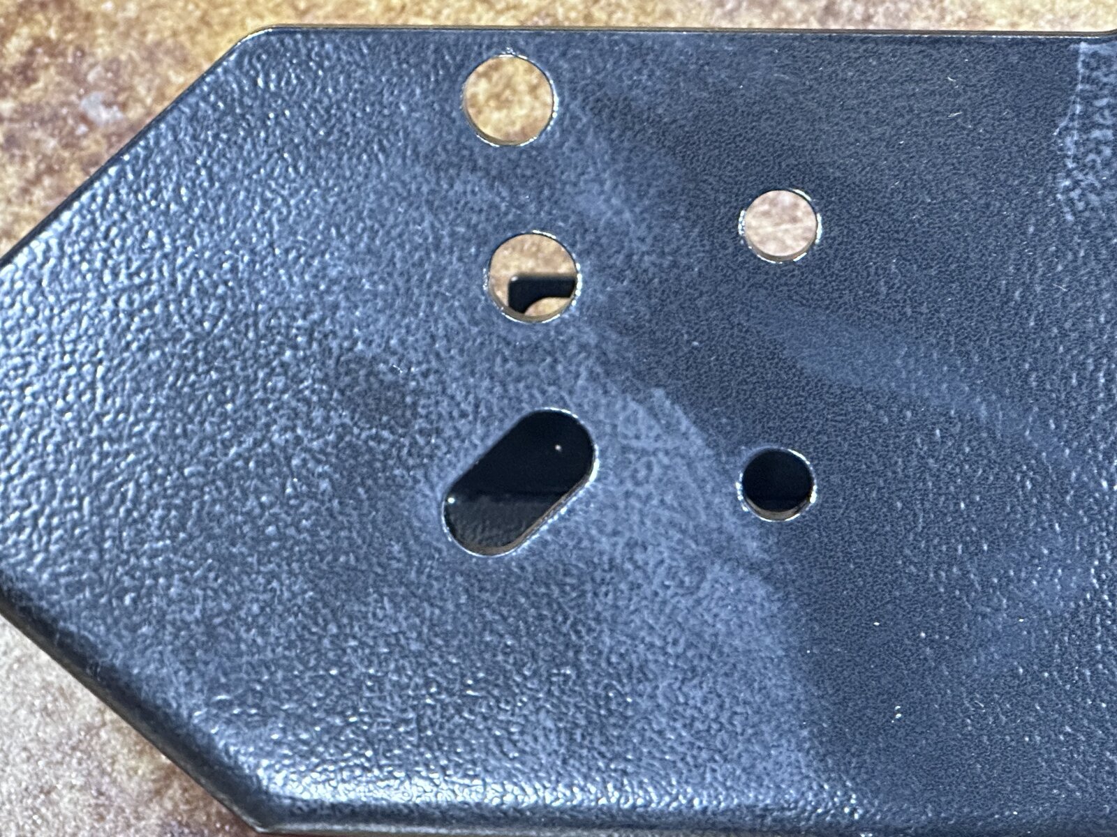

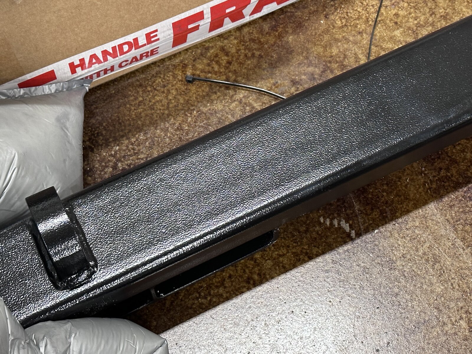

Today, I opened the boxes and guess what......more horrible powder coating. The front is even worse than the last one. The back is better, but there are four chips in the new coating right on the outer face of the bumper.

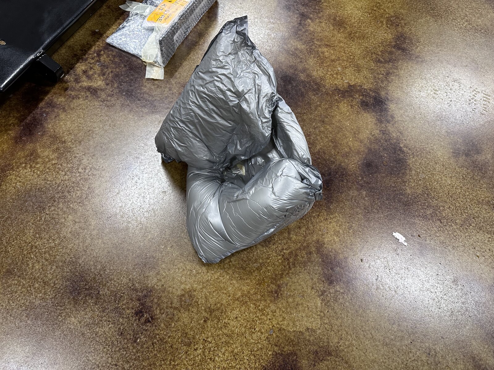

I think I figured out what the problem is. They use that chemical foam in a bag packing material which I believe is discoloring the finish in the box. The areas that are screwed up are where the packing material is touching the bumpers.
