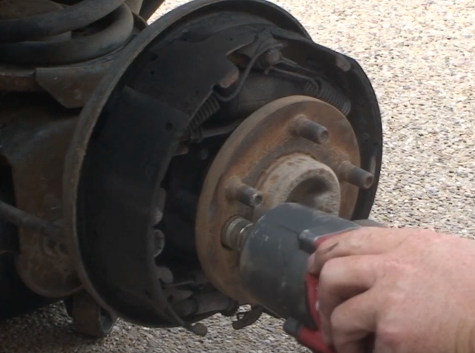

4. Using the hole in the axle flange, remove each of the four 3/8 nuts with your 9/16 socket. You'll want to get new stover or nylock nuts. Don't re-use those nuts if you can avoid it, but if you do end up re-using them red loctite is advised. Lining up the hole for each of the bolts is easier if you have a helper rotate the other wheel.

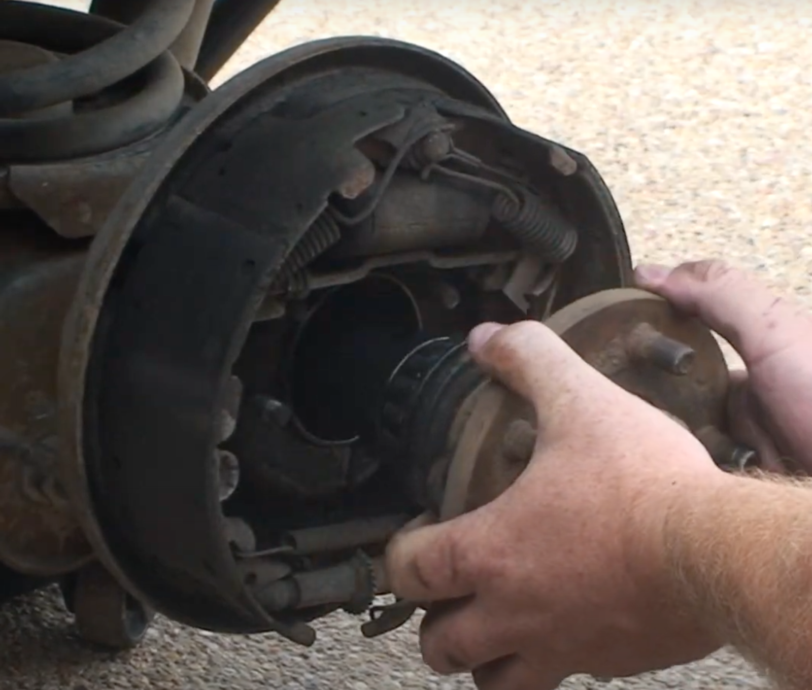

5a. Yank out the axle. I didn't have any problem with this, but I've seen where people needed a slide hammer to get them free. The retaining plate likes to get hung up on the backing plate bolts, so you may need to caress it a bit. The brakes & backing plate can stay in place during all of this. But it's also not a terrible time to consider refreshing your 25 year old drum brake parts.

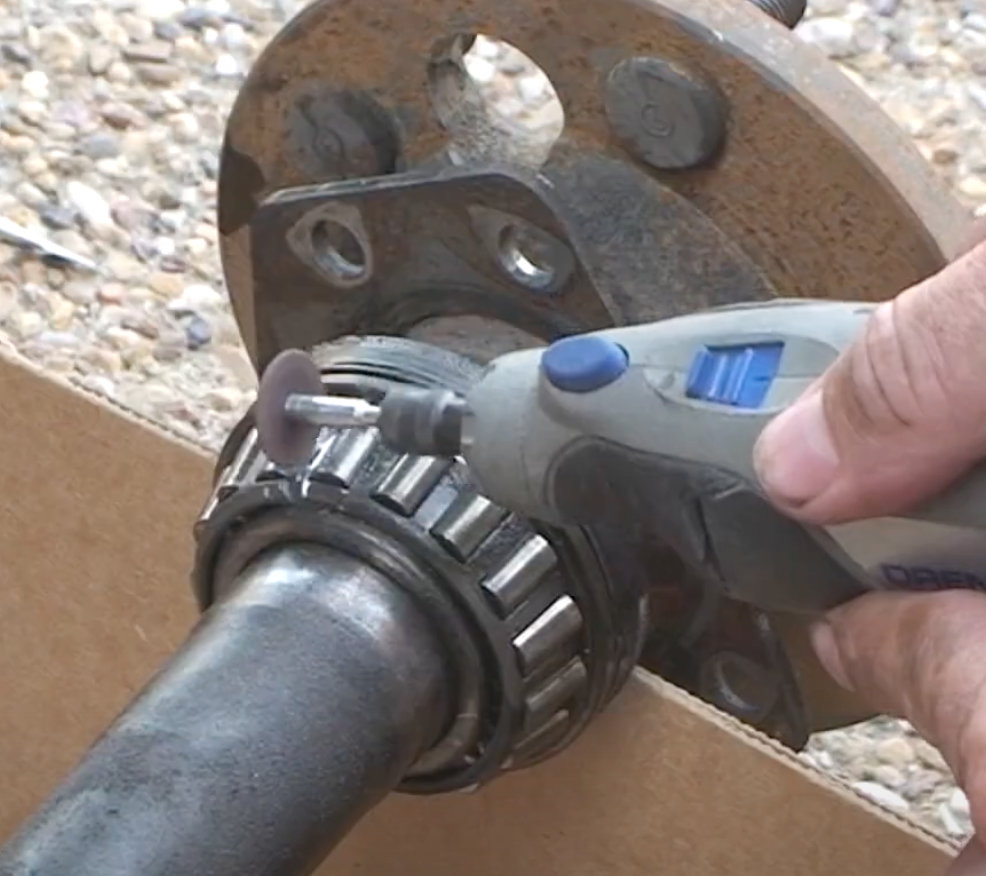

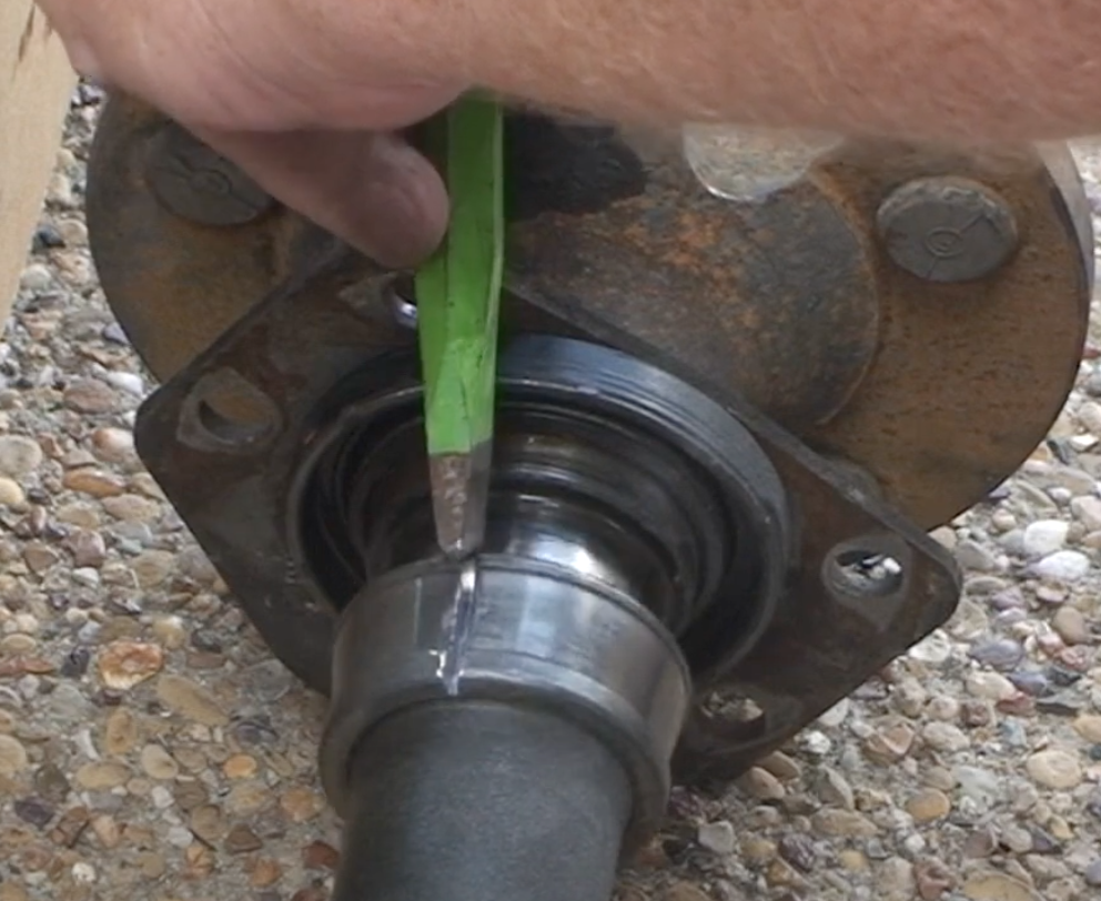

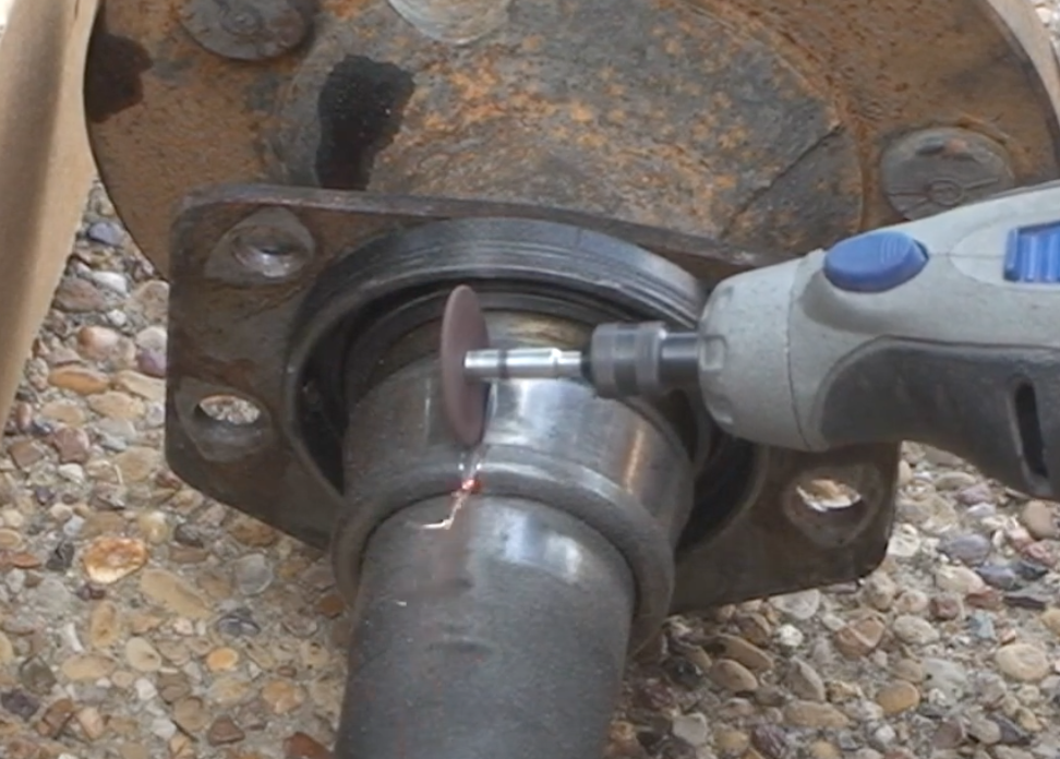

6a. Remove the bearing retainer collar. It's the thick steel ring. There are several ways to do this, including probably just pressing them off if you have the right tools. The most common method is to cut them off with a Dremel or equivalent, and then crack it with a cold chisel & slide it off. You'll want to avoid cutting into the axle surface, so cut down as close as you can, then stick your chisel in there and hit it with the sledge to crack it through.
6b. Remove the bearing cage. Again with the Dremel, although you don't have to crack it off. Usually a screwdriver or pliers will help wreck that thing.
6c. Remove the inner bearing cone. Same as 6a above, only this time you also have to contend with the shoulder that the bearing is pressed up against. Get as close and as deep as you can; it can be hard to tell if you're through the bearing & into the axle......don't cut into the axle. Just don't. Then it it with the chisel & slide it off.

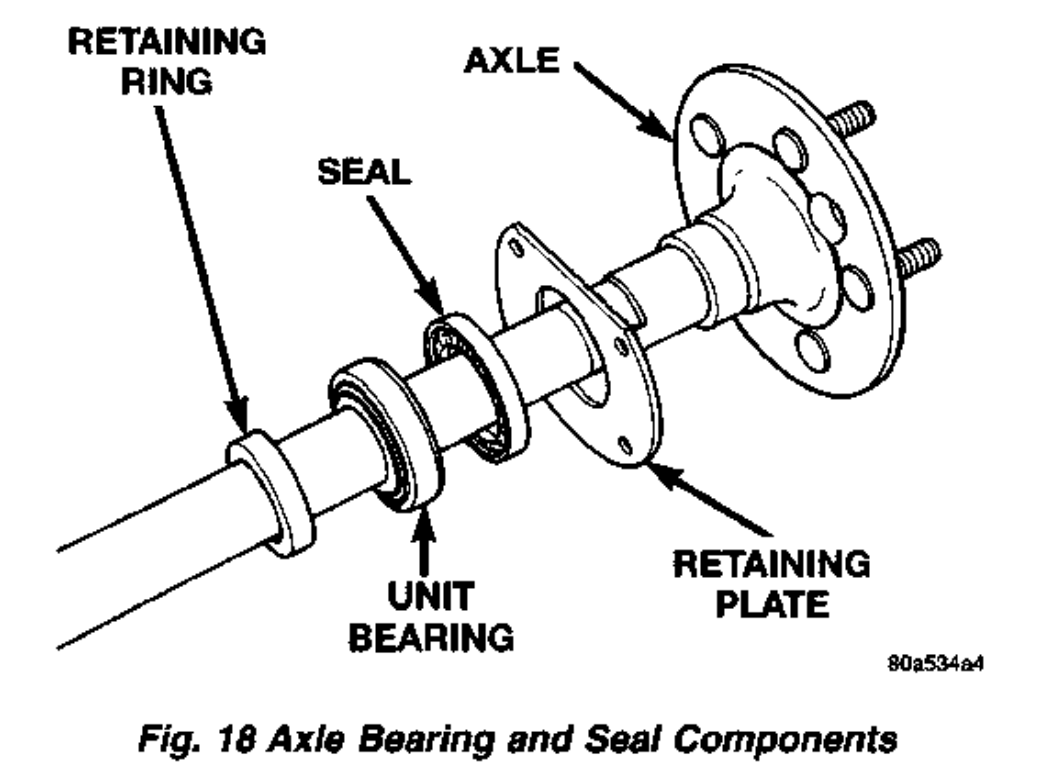

It's super important that you have your act together when you go to re-assemble everything. The retaining plate must go on first, and you need to have it in the correct orientation. Once the bearing goes on there is no going back unless you want to cut that bearing back off again. For disc brakes, your retaining plate will have a lip on it, and that lip faces inboard. For drums you can either face the lip outward or buy (or re-use) the non-lipped retaining plate. I ended up re-using mine flipped over since it deforms slightly on install.
7a. put the retaining plate on the axle

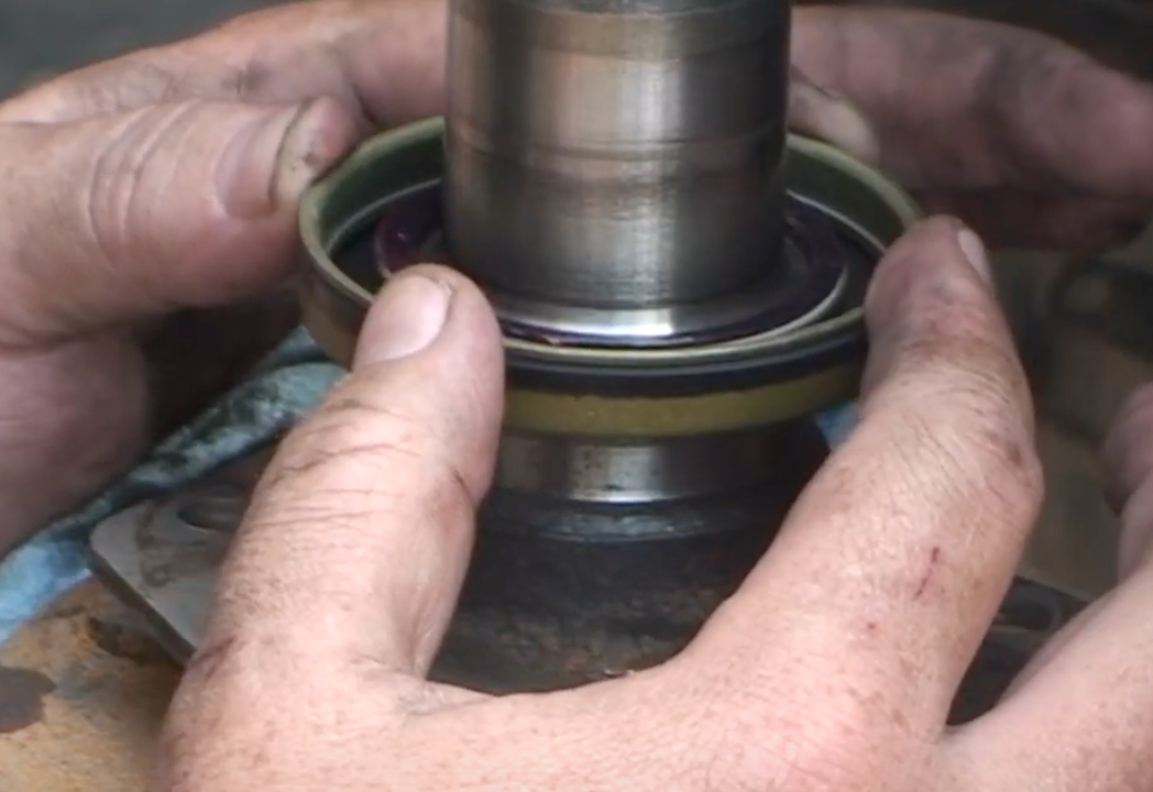

7b. grease the lip of the seal, and slide it on the axle, all the way over the shoulder that the bearing will press against. You can probably see a small groove where the old seal rode for all those years. The metal face of the seal goes outboard, the side with the tensioning spring goes inboard.

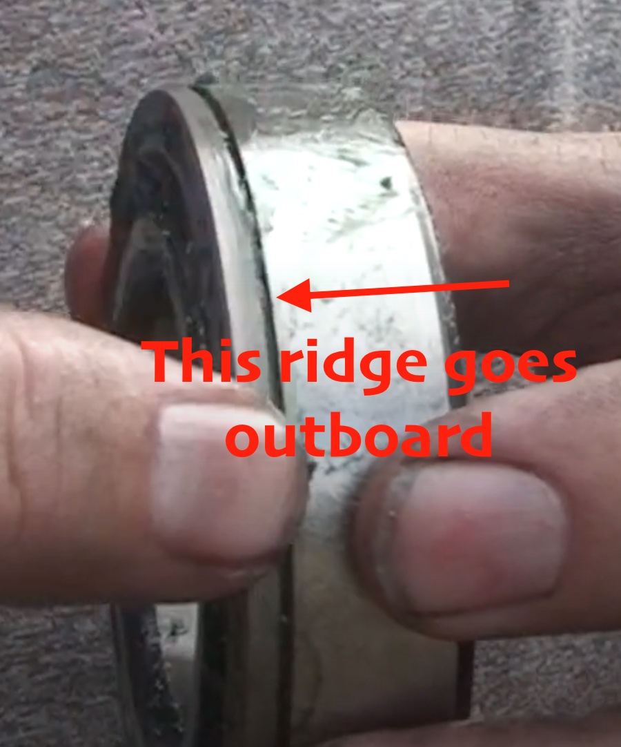

7c. Next comes the bearing. The orientation for it is that the cone should be tapered inboard. The race doesn't separate from the bearing so make sure you get this part right. There is a lip on the race, this is the outboard side of the bearing.
