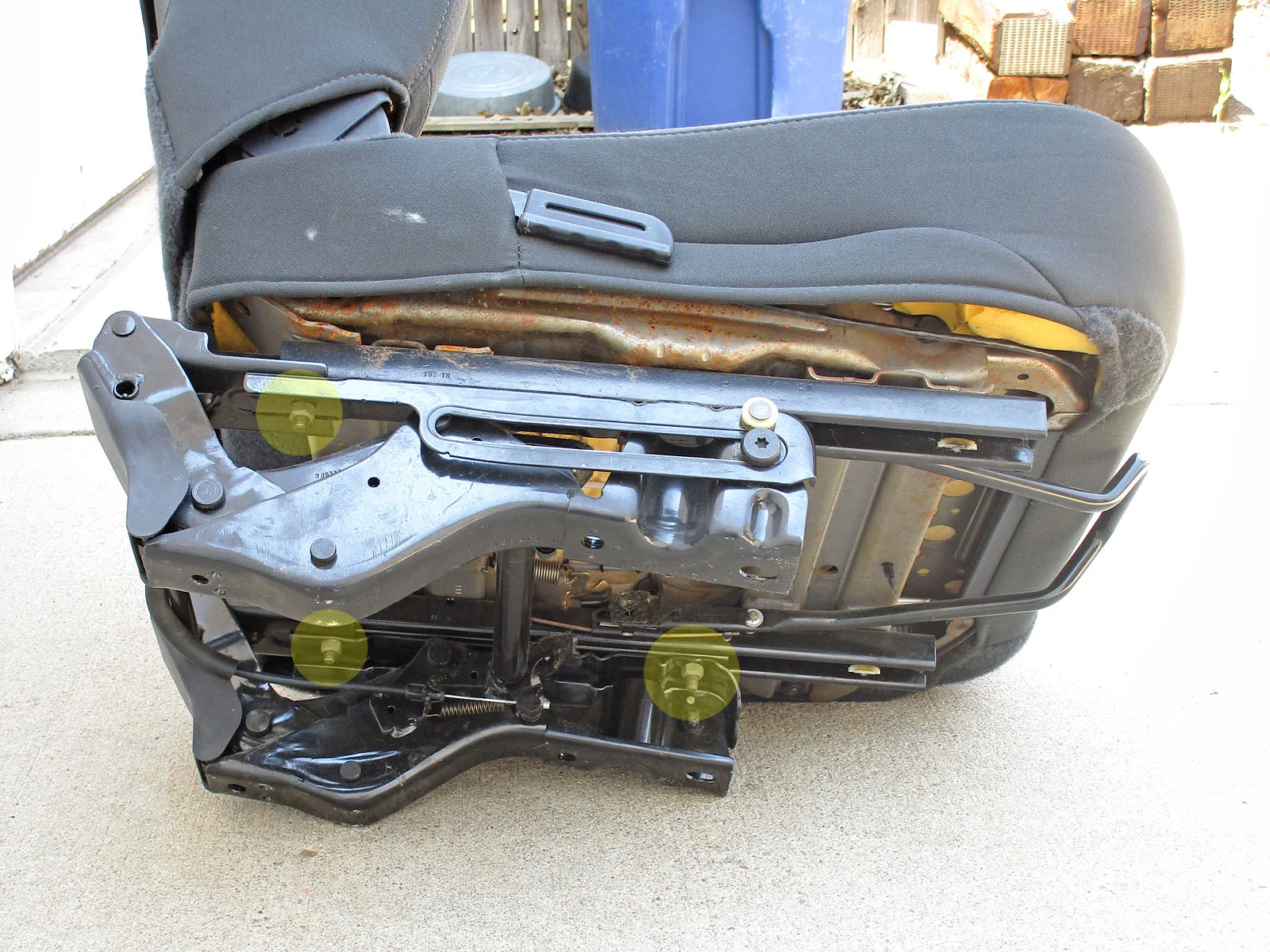

Four bolts to remove the seat, and the seatbelt corner is a bigger bolt.
Then it looks like these bolts underneath might be what you're looking for. I haven't disassembled mine any further.
