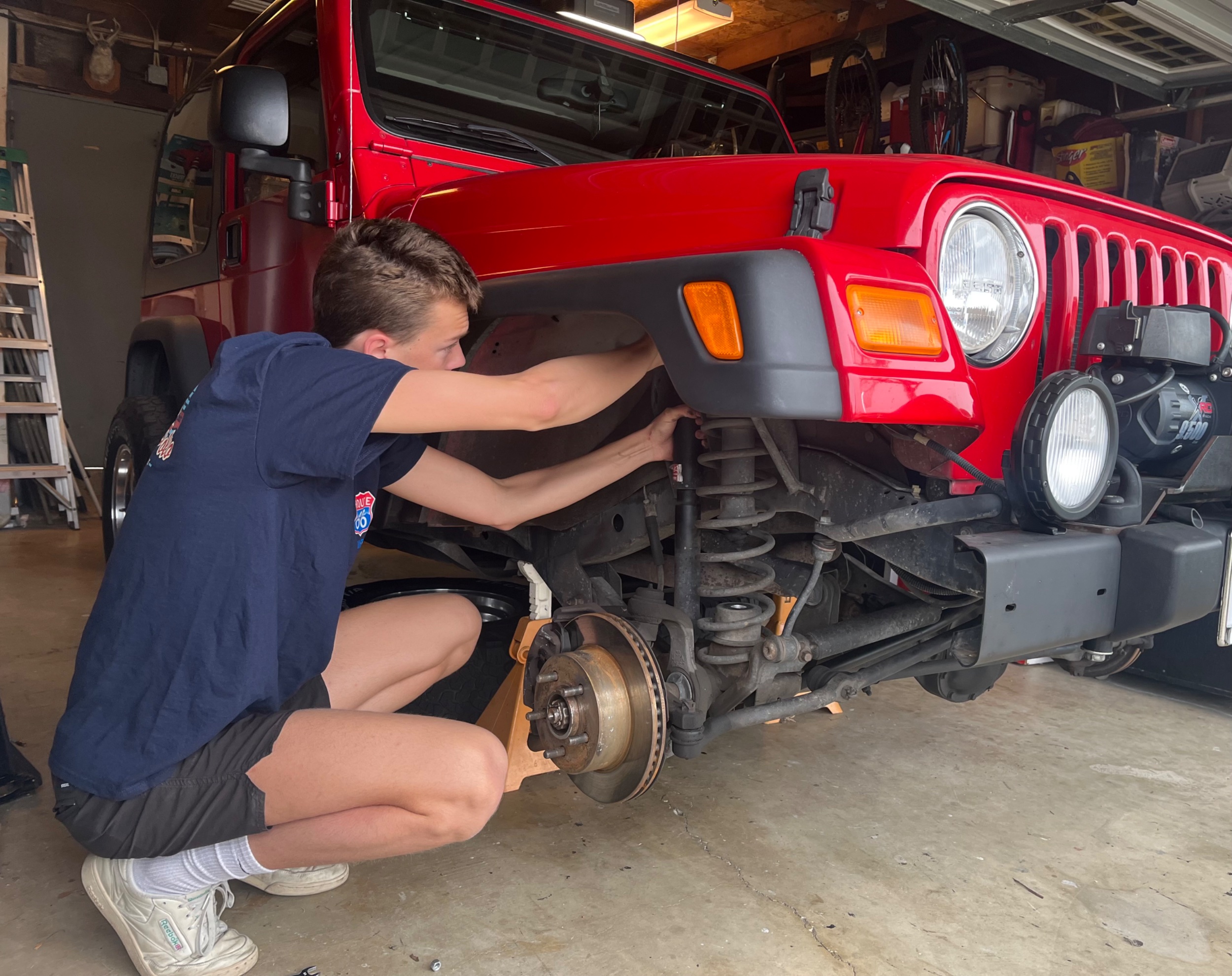

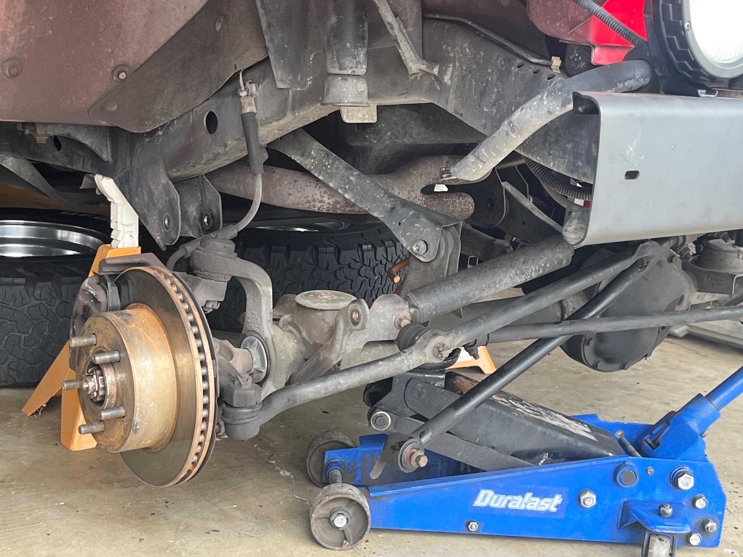

Started the front end today and it was great to have my son start getting his hands dirty. It’s his Jeep so I feel it’s necessary for him to see how this stuff come out and goes in.
Suspension looks stock height but I think it had a lift on it at some point. Had a 2 inch front bump stop on it which basically allowed 0 up travel. Also had a second hole drilled next to the original track bar bracket. Lastly it has the rear track bar raised on the axle end which explains why it would kiss the gas tank skid.
Gotta love these surprises from the previous owners.

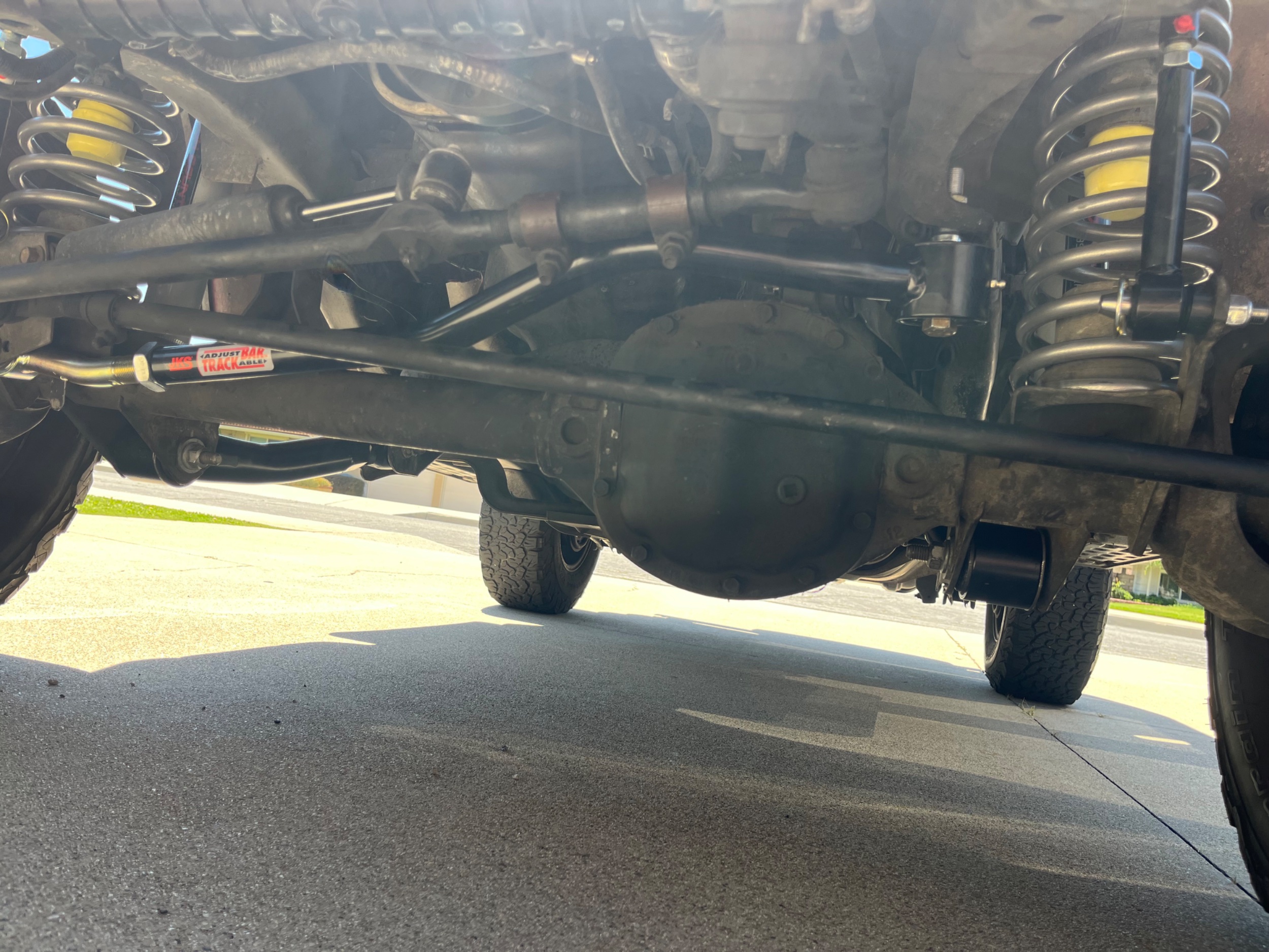

A bit more progress made.
With JKS’s lack of urgency for shipping things I panicked and went with RC 2.5 inch springs and shocks to get this thing driving. Normally I wouldn’t but my kid gets his license in a week and I couldn’t wait. I figured I could get phase one done with the arms and track bars done and change springs and shocks down the line as needed.
It snowballed backwards on me kind of. I couldn’t get it driving on a bigger lift without the higher springs, I couldn’t order the driveshaft without the springs installed, and thus I couldn’t run the SYE without knowing my final ride height so…….
So far it’s on the RC springs and shocks, JKS front lower arms, track bar and sway bar links (which are less than impressive).
Still waiting on the rest of the arms but it drives much better with no vibes up to 50 mph. Next step will be to replace all the arms and get tires.

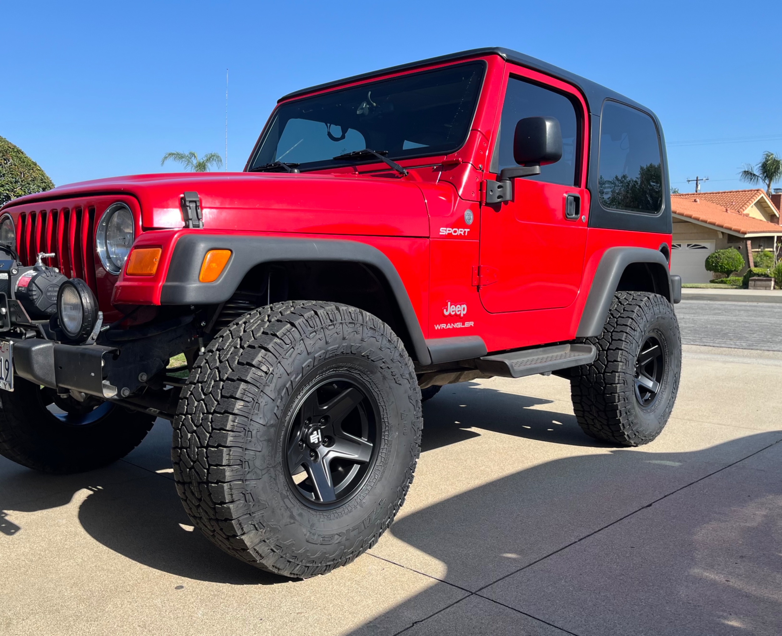

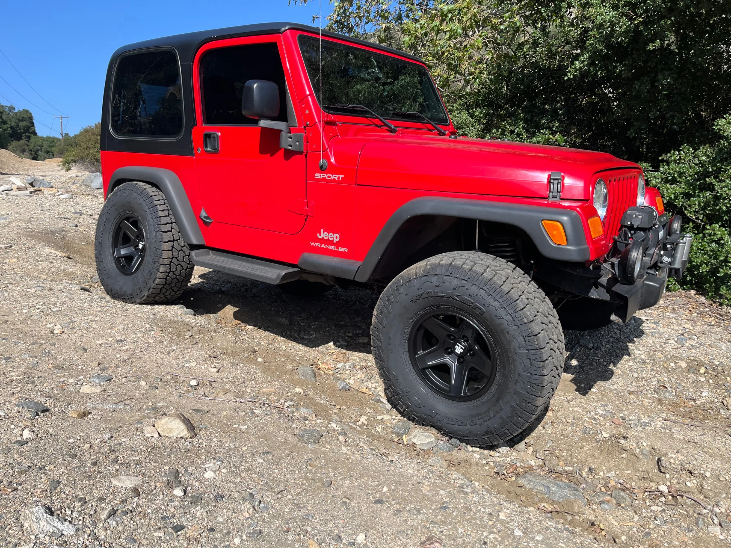

Slowly coming along but still waiting on some more parts. Just put on some Falken AT-4 in 33x12.15 on some Mammoth 15x8s.
Tried to flex a bit near my house just to see how the 33s would clear with the 2.5 in springs.
