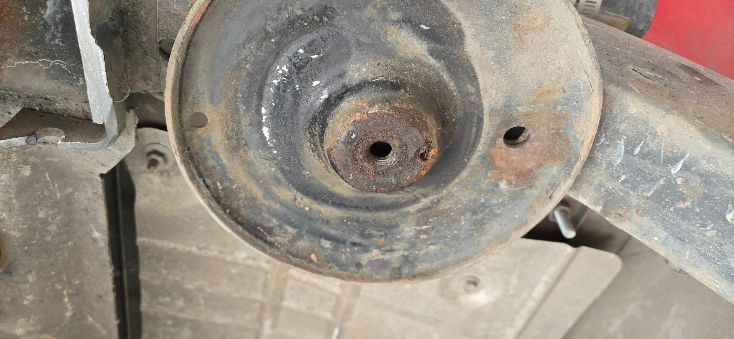

Rear upper spring perch

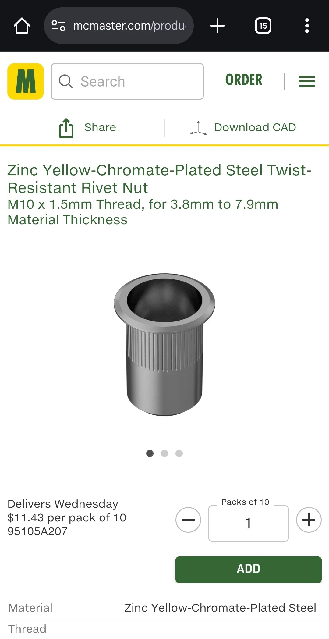

I'd opt for the most rigid option. Water just pools there and corrodes whatever you have - so even with any sieze mine have been a bitch to remove more than I care to admit.

Closing this out. Drilled next size up and tapped. The aluminum retainers also had to be drilled to the next size up.
The upper uses the aluminum retainer, the lower uses a large washer.
Got it,those don’t look large diameter enough,but I guess it’s a see in person thing,right now I’m stuck with the rear air lift bags,so I’m only using a small energy studded bump on top.but when we get rid of the rtt and start towing,I will use these rock jock bumps.
