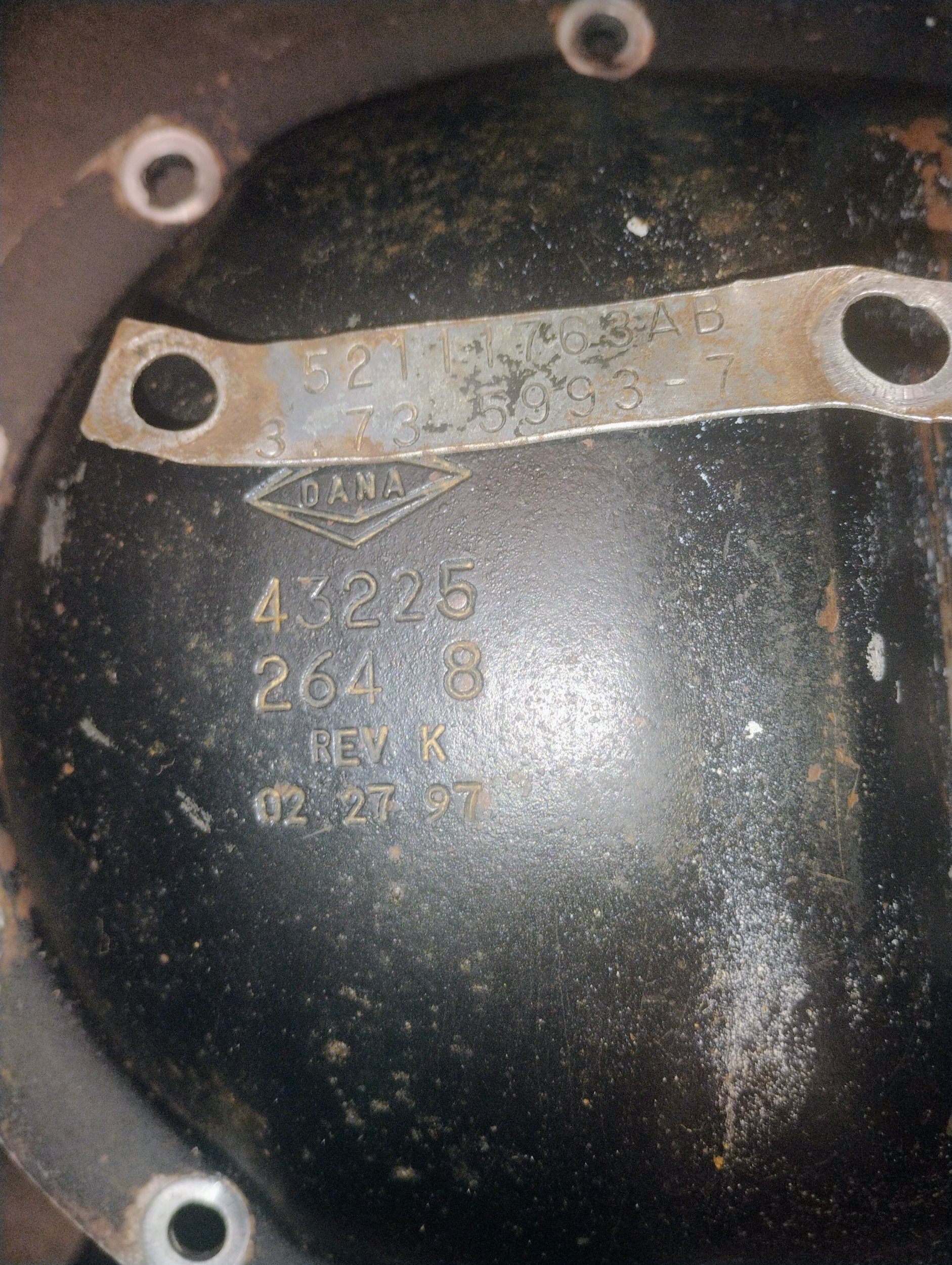

Hello All, I'm a newbie to the Jeep community. I just purchased a 1999 TJ with the intent of doing a full rebuild and have an issue with trying to identify the rear diff. I suspect it's been swapped out. I have the Dana Spicer parts catalog for 1999 - 2011 but the numbers don't match up...they do for the front but not the rear. The rear diff cover has the following: 43225 264 8 REV K 02 27 97 and the cover bolt tag is 52111763AB 73 5993-7. Am I right that it is a 1997 Dana 35 with a gear ratio of 3:73? I sure hope it's a 3:73 because that is what the front is which I've confirmed. Any links to sites that can help identify would also be appreciated. Thanks!! If anyone wants the link for the Dana Spicer catalog let me know and I'll provide it.
Unlikely to be a 97 diff unless it came out of a 2.5L 3-speed auto. But it doesn’t really matter what it’s from as long as you have matching gears.

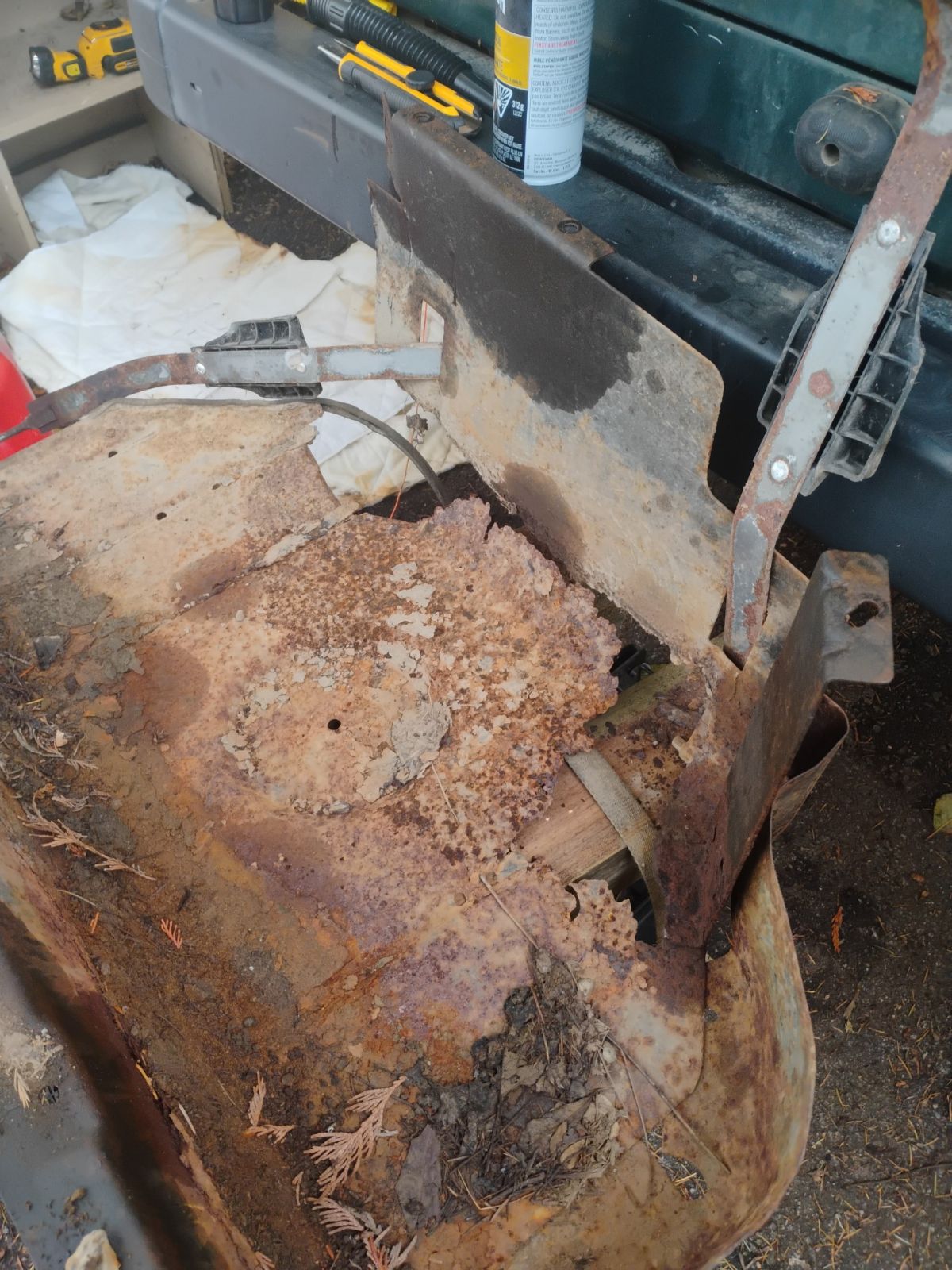

The frame and tub are solid but, what is a good product to stop the rust and then what to use as a coating to preserve? The fuel tank skid plate was rotted out as you can see in the picture but everything else is solid...pictures to follow.

Oofta on the rust! Glad you swapped it out. Most folks think the original Mopar fuel pumps are the holy Grail. I'd stick with it and run with it...now that you've dropped the tank it's not hard. The resources section has a how to on taking apart the pump assembly to individually swap the pump and regulator since a new Mopar is no longer available. My pump cage on my 97 was so brittle from age I bought the cheapest pump assembly on Rock Auto...a Brute Power for $85. Been good all summer through a road trip from Oregon to the Rubicon Trail and home and plenty in between.
