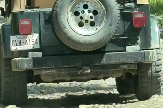

Rear bumper
Best shot I have on my phone of my bumper and hitch now
The bumper you linked has a hitch receiver built in that wants to be in the same space as your frame mounted hitch. Almost any rear tire carrier bumper is going to have a certain amount of real-estate it needs to occupy, and they will all most likely have interference issues with your frame mounted receiver.

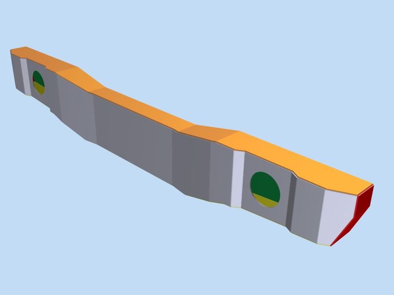

I'm in the final stages of designing a new set of bumpers for my '97 and was planning on incorporating a swing-away carrier. Considering the warnings about noise and such, I'll forego adding the feature on the rear bumper and instead, modify the existing tailgate spare tire mount to fit better.

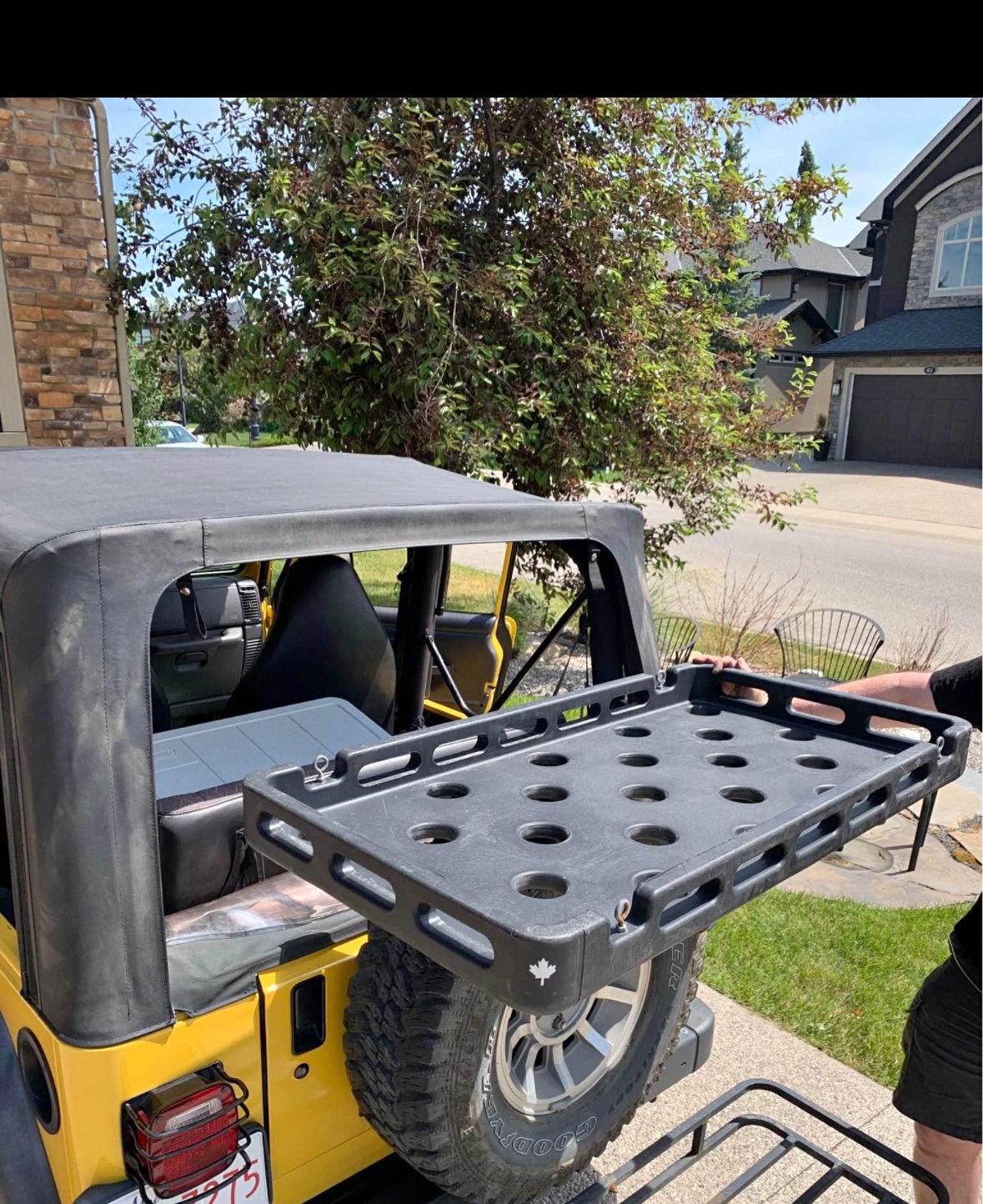

This I what I wanted to add to the spare for gear and maybe a deer if it would take the weight. Can a factor spare tire mount hold that weight
