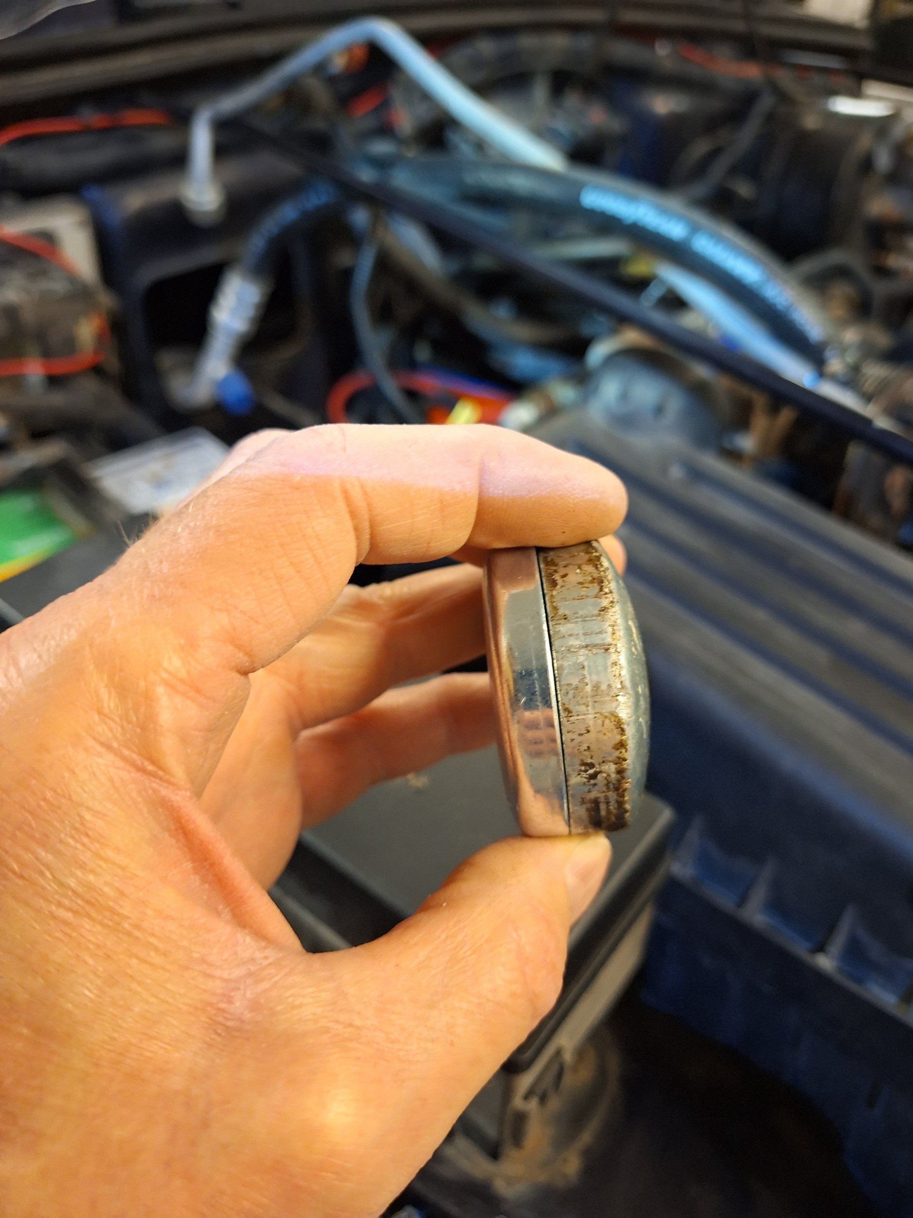

So I had my '99 2.5L rebuilt by a local machine shop. Got it back, assembled it, put it in, filled with antifreeze and noticed a drip at the back of the motor. The core (freeze / expansion) plug on the back of the head was dry, and the head gasket was dry. Borescope showed it was the core plug on the back of the block that was leaking.
I pulled the trans/TC and clutch and the machine shop came and replaced it, but with a different 'style' of plug. They say they always use a thin film of Permatex aviation form a gasket on the bore hole and have never had one leak before. Does anyone know if it is a bad idea to keep the new one they used (the old one they installed that leaked is the thicker one on the right, new one is now in the motor is on the left)? They measure about the same in diameter, I'm just trying to avoid more problems. Thanks for any input.
