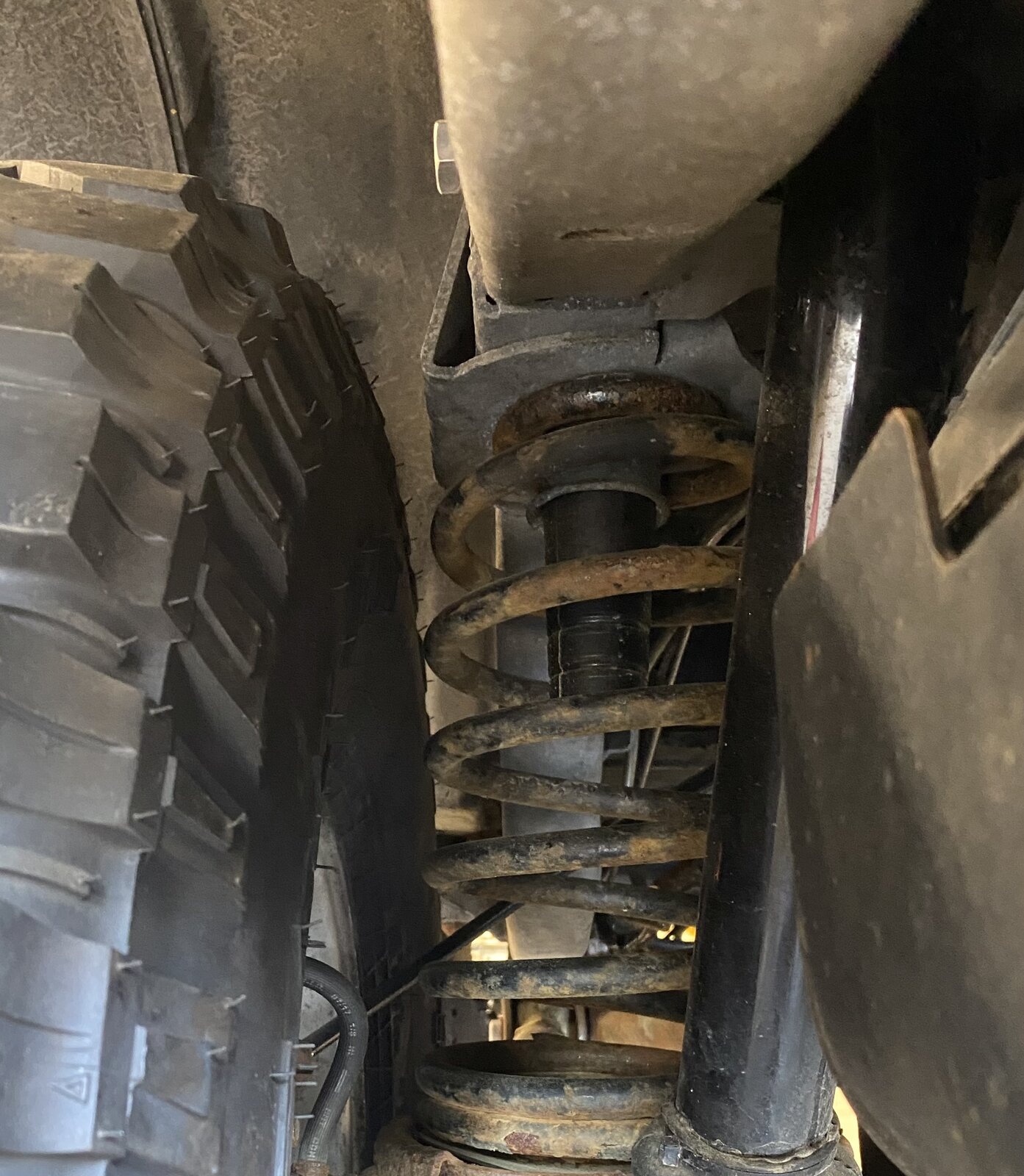

I reccome d running a rear spring relocation perch because it gains a lot more room. For the backspacing..
