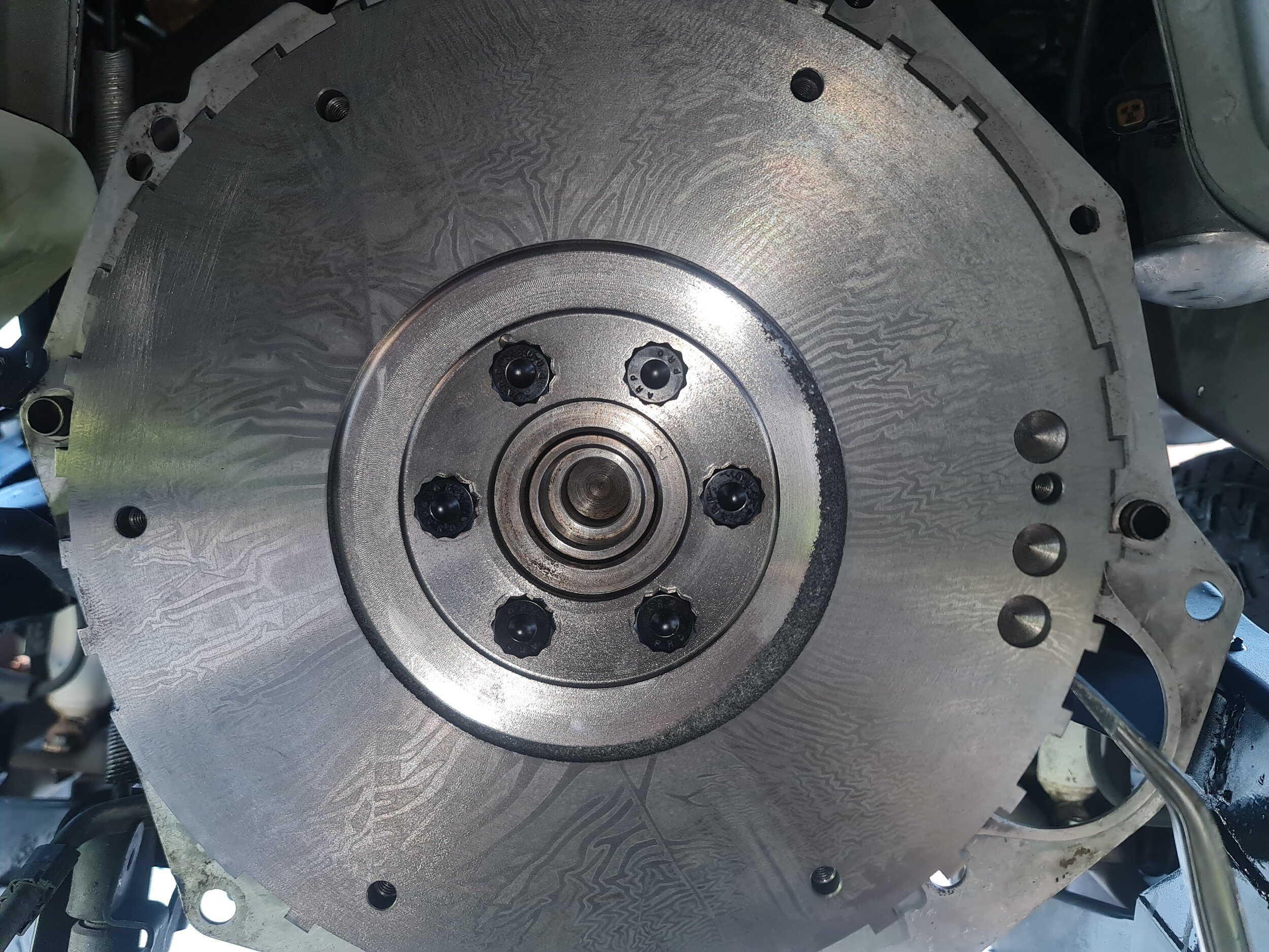

So,I'm doing a 42rle to Ax15 swap and I wanted an opinion on weather this truly matters!
I got the whole catalog from Novak for the Ax15 stuff and I got a pilot bushing
Any real advantage on either?
I'm going to summit racing later on today (again) so I wanted to see what yall think?
Pilot bushing vs Bearing

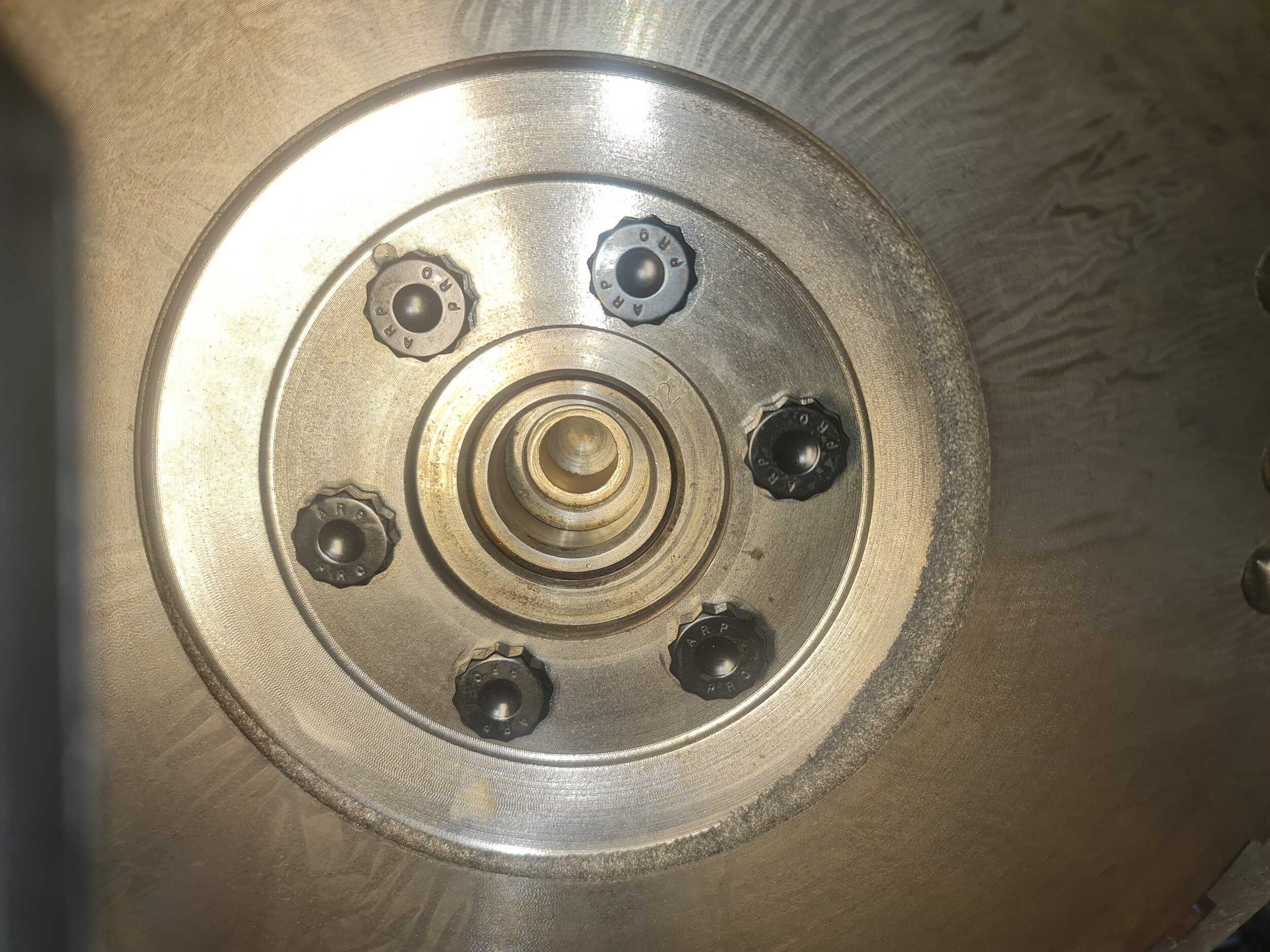

Just got done bolting on the Luk flywheel with some ARP Hardware 😁,Red loctite too.With my driving style I don't want these coming out !!!

I drive my jeep 72 miles a day,I'll see how this pilot bushing works out! Don't feel like taking it out for a bearing just yet.....
One I experience my AX15 and put some miles on it I'll take it out again and do some marlin crawler upgrades like the shift forks and Chromo. Bearing retainer.By then I'll see the wear on the pilot bushing!
It's the one with the ARP hardware,I was gonna upload a reference pic of the other style of pilot bearing but i thoght i deleted the pics (the type that goes on the bigger bore of the crank)

Edit,Got off the phone with Novak and I got told that the bushing goes on the smaller bore and that it will fit,took some rough measurements with a level and caliper and I can see that it will go in deep enough!
