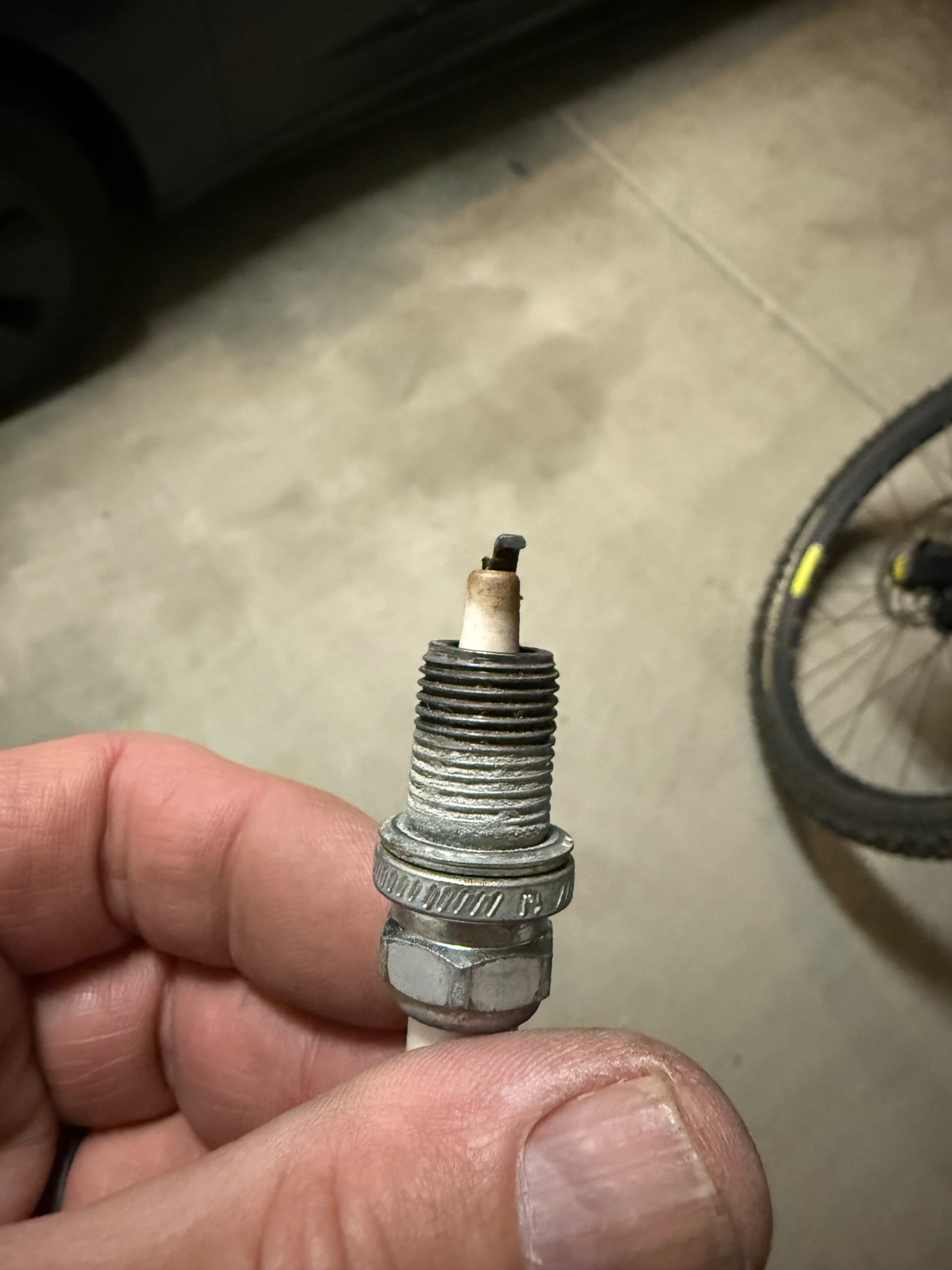

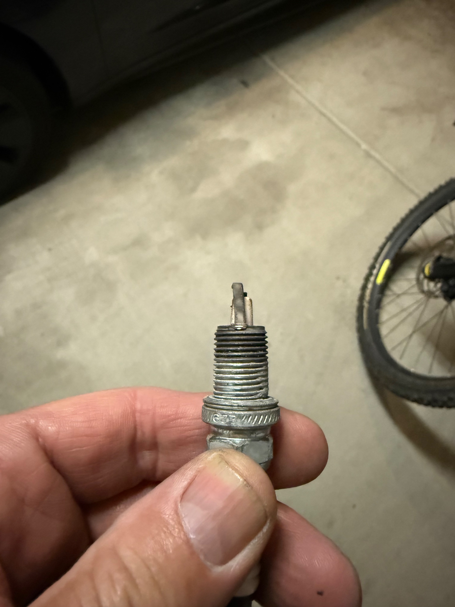

So, pulled all plugs and found one installed by engine builder. Thought it might be the problem.
Installed all new plugs and it ran smoother. Threw a Cap and Rotor at it as well with a new Coil. But still had intermittent PO300 CEL. Tried three different NGK brand CPS. Each time i installed with the new paper distance gauge on the tip, it would idle rough and threw a CEL just going around the block.

I'd watch that broken spark plug and check it again shortly...might have valve/piston clearance issues...or just a cheap spark plug.
-Mac
Yea, firgot the brand but it was the cheapest plug they make for tge 4.0. Engine builder probably saving money. Shame to see that since the engine feels really strong after the zero mile rebuild. Like new engine, which it basically is. I ended up throwing in a set of Autolite XP985
