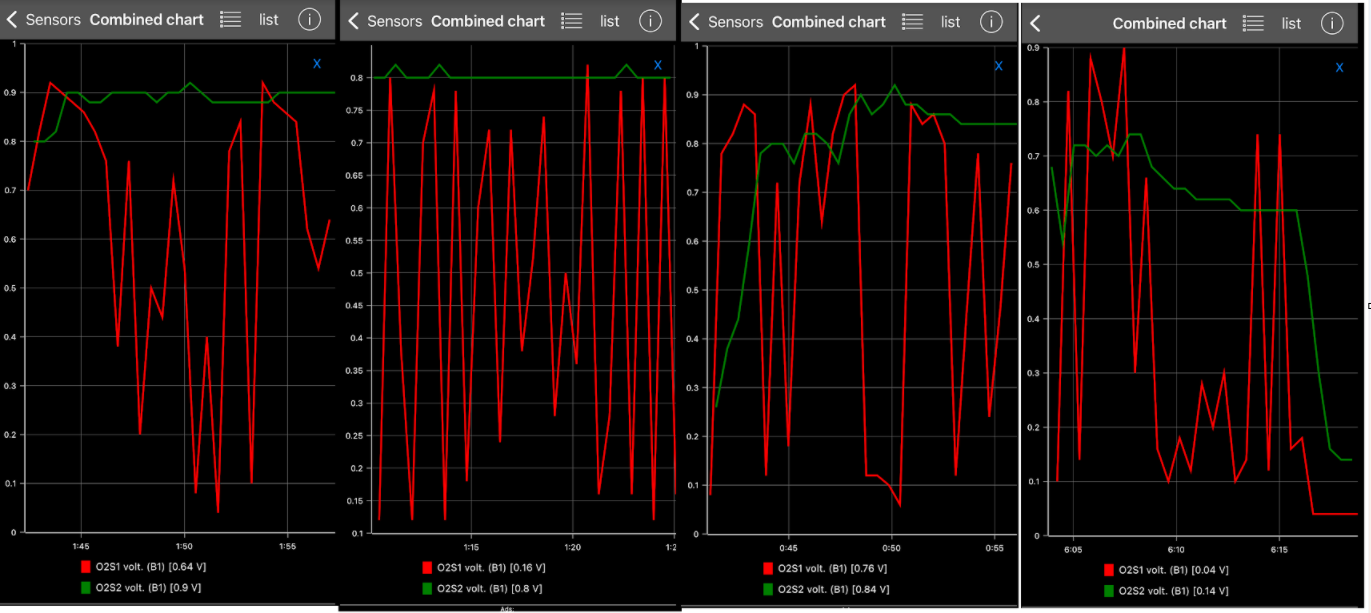

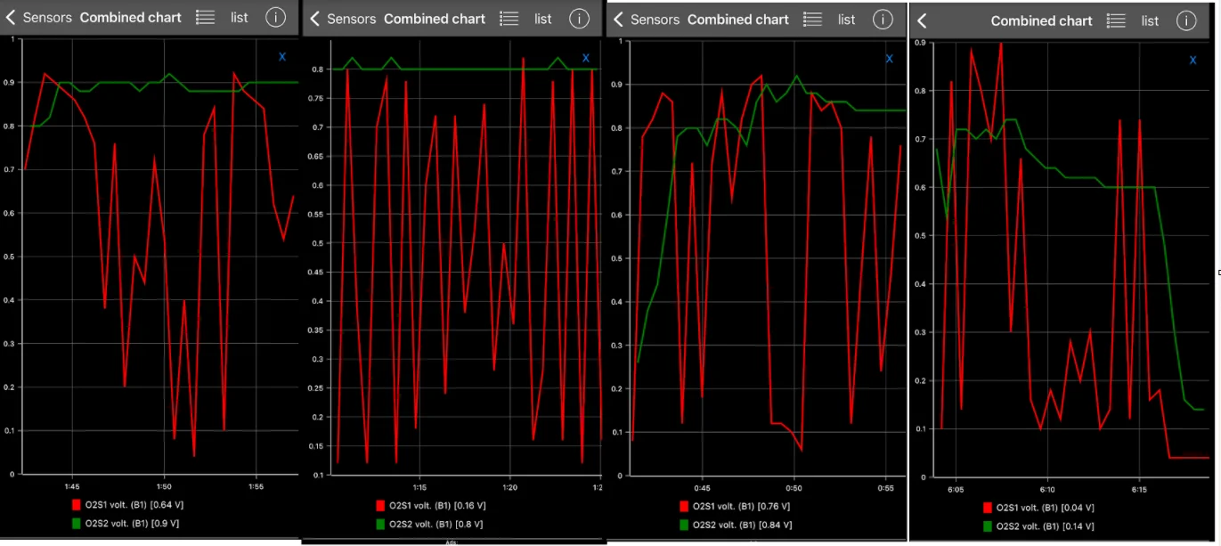

Hi Folks, I'm trying to interpret some oxygen sensor reading for my '99 TJ Sport 4.0 auto. With the engine warmed up or cold, the bank 1 sensor 2 reads close to 1.0 at idle and is consistently much higher than sensor 1, The attached images are the readings at idle and when revving. Is it possible that sensor 1 is not reading right, causing a rich condition which is showing on the sensor 2 reading? Or could sensor 2 be faulty, causing some other issue?
The TJ runs OK, but feel a little sluggish, and has a little more vibration from the engine than I'd expect. 12 MPG currently.
