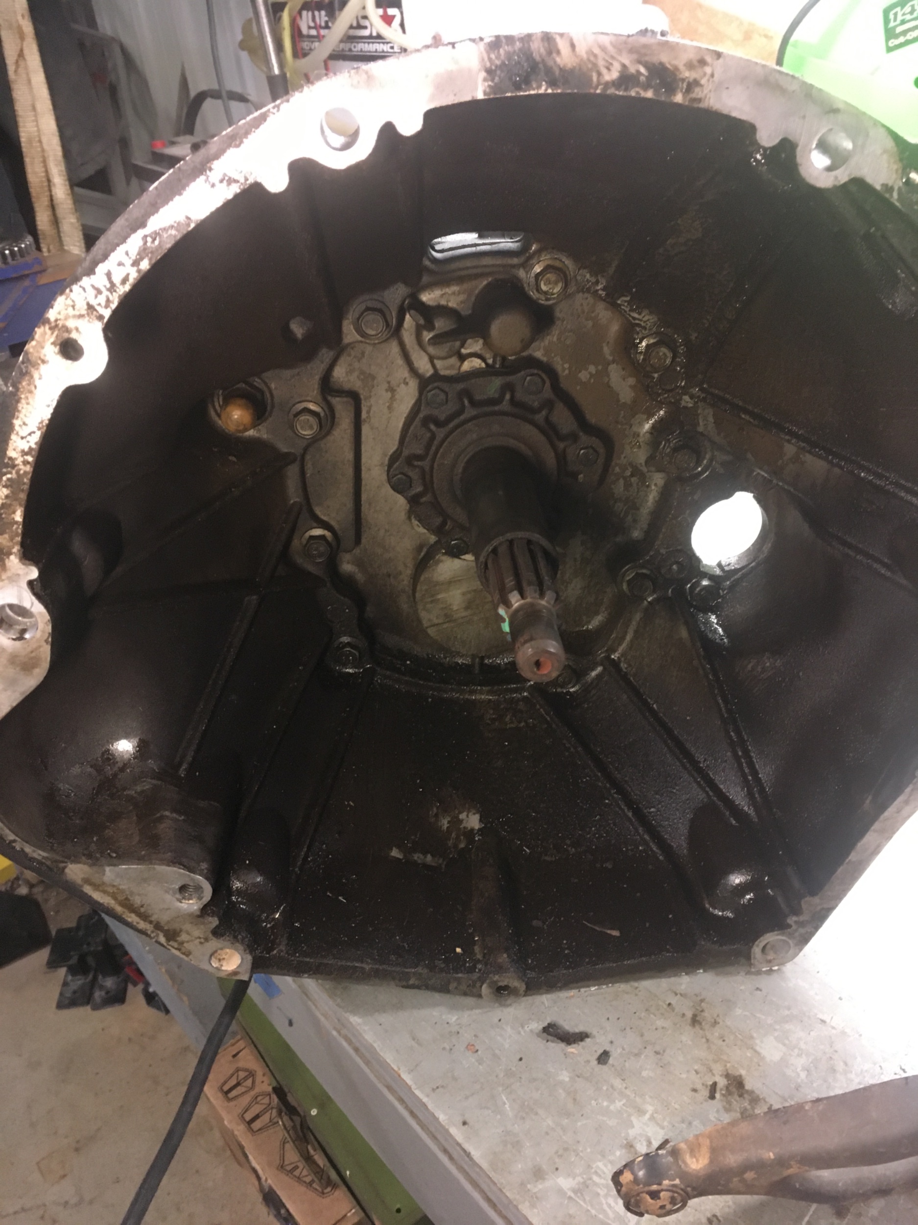

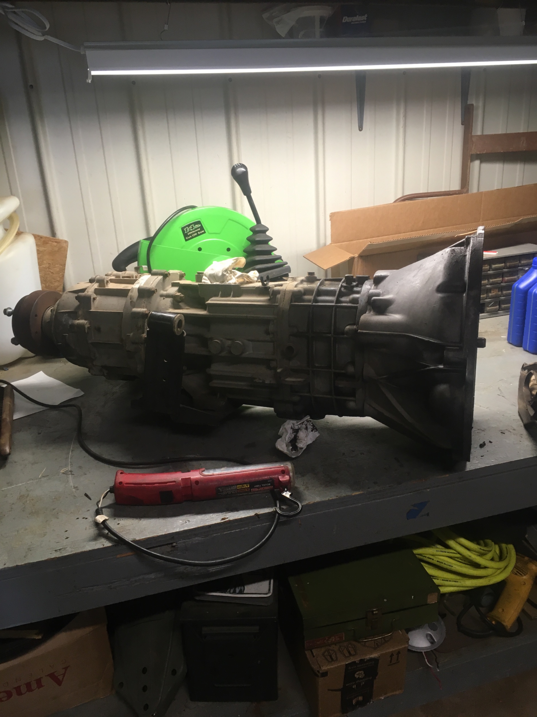

I pulled my NV3550 to investigate a noise. Discovered that the pilot bearing had literally turned into dust.
I went ahead and replaced the throw out bearing while I had it on the bench. The clips on the fork were broken. Found pieces of them in the bell housing.
After reassembly I have much less noise but it’s still a bit noisy like you described. No issues other than some whine.
I consider it to be normal for the NV3550.
I consider it to be normal for the NV3550. View attachment 628408View attachment 628409
