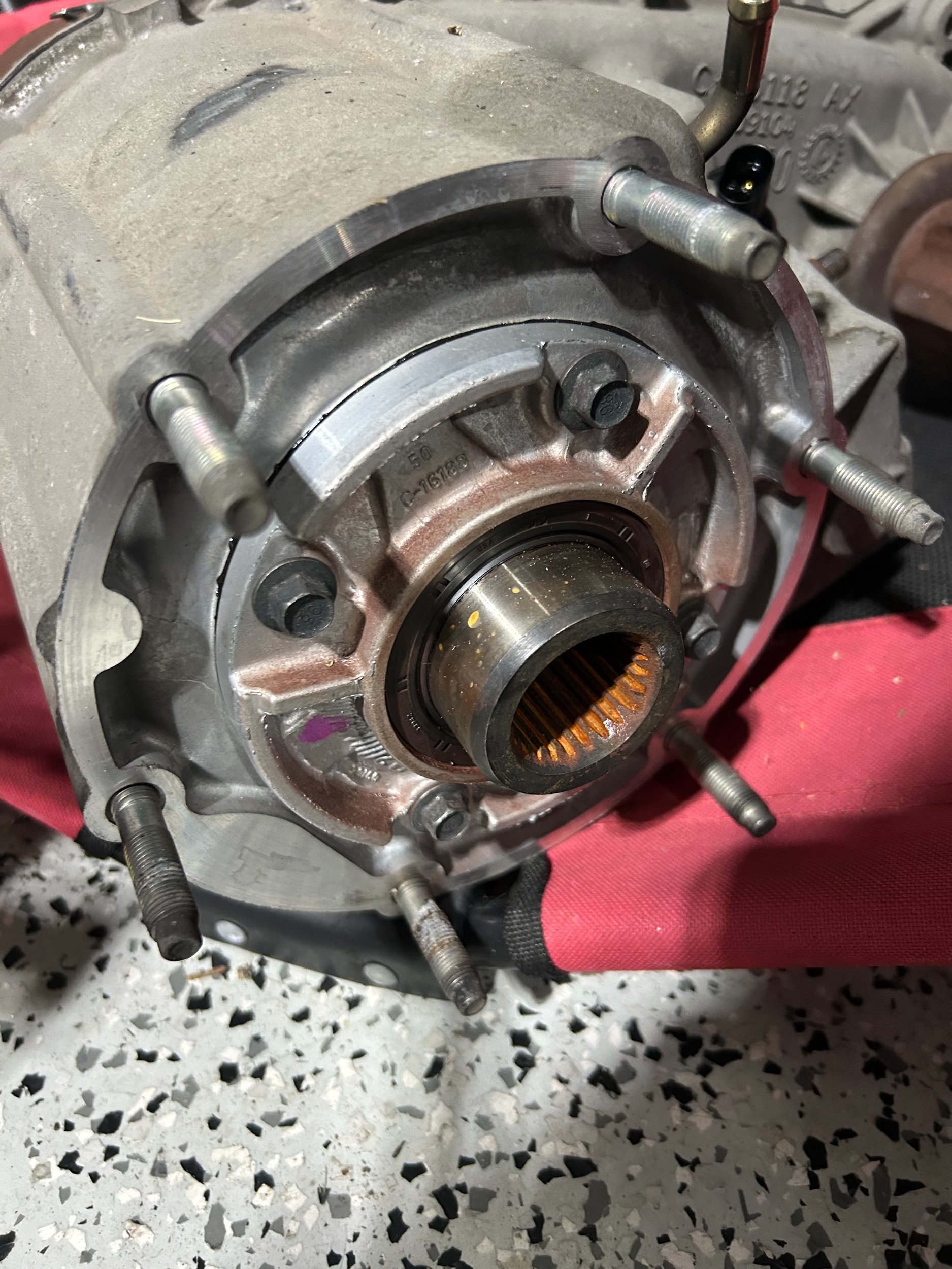

In the course of swapping my 3550 for a Novak AX15, it looks like I need to replace the input gear on my transfer case according to Novak. I had not planned this.... Question is, do I need to replace the input bearing since I was not having any trouble? Or is it one of those 'ofd it now since you're in there' sort of things?
Yes... as part of the kit, I was sent (and paid for) a 23SNLS (gear, input, new process 23x & 24x transfer cases, 23 spline, short, narrow bearing, late cut, Jeep). Having read a little here... I am curious if I need to... and how to find out if I do or don't.
