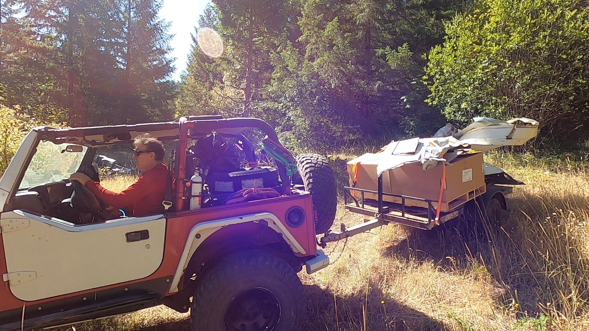

This '01 that I purchased had sagging springs with rotten bump stops and leaking shock absorbers.
I didn't want to install a lift just to restore the ride height, but since I purchased the Jeep during COVID; the parts were 8 weeks back ordered.
While I could have installed spacers to restore ride height; the new coil springs were more appealing,
Purchased 2' lift springs, new bump stops and found a set of Rancho 5000 shock absorbers to work with lifted height.
The ride height has been restored with a little added and the RS 5000s provide a reasonably comfortable ride.
I can tow a 16' RV. It just takes three trips!
