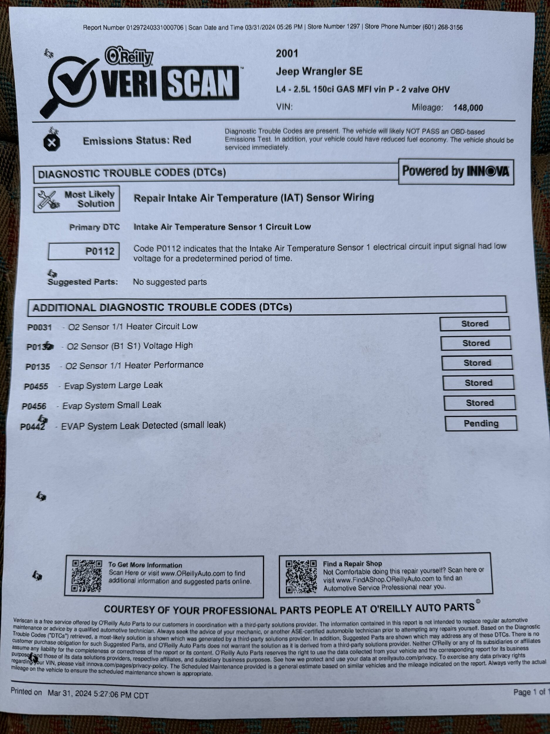

Could not get the codes to pop up with the key trick on the mileage but the parts house was open on Easter for some reason and you nailed it.
Evap leaks- be sure the gas cap is tight, clear the code and run it - if a code pops back it may be the cap and if one stays clear maybe it was ran with the cap loose.

I noticed my gas cap just spins and never actually locks in and removing it is more a matter of lucky alignment so I was going to have to replace it.

Yep, replace gas cap. For O2 sensors don’t buy anything but NTK/NGK. All the others suck! If I were you I’d replace all 4 since odds are you’ll just have to replace another one a few months down the road.
Update to an old thread for those interested. Replaced the O2 sensors, gas cap, and the Air Intake Sensor and all the codes seem to have remained cleared with the exception of the Air Intake code. I pick it up tomorrow from the shop and I'll put some miles on it this weekend and see how it does but if there's anything beyond the sensor itself I should be looking for please advise. Thanks!
