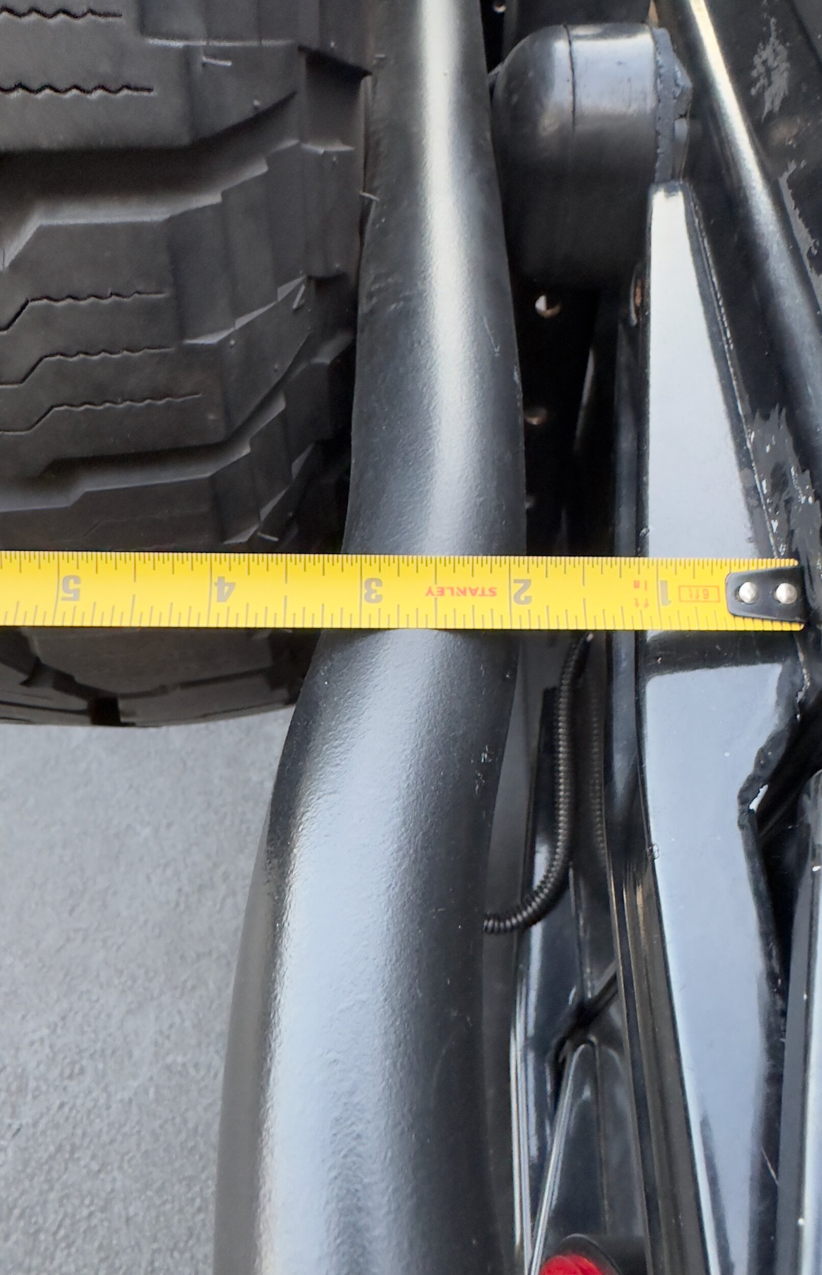

I have and love the Bestop HighRock 4x4 HD Tire Carrier so I don't need the full MoreRyde kit. Not sure if the MoreRyde hinges will play nice with carrier so need a clearance measurement. How deep are the the MoreRyde hinges.. tailgate to the outer most edge? Stock hinges are 1.25" at their widest.
The carrier has a bend in it to follow the taper in the stock hinges and looks to have about 1.75" total clearance. Not sure if there will be enough room for the MoreRyde hinges.

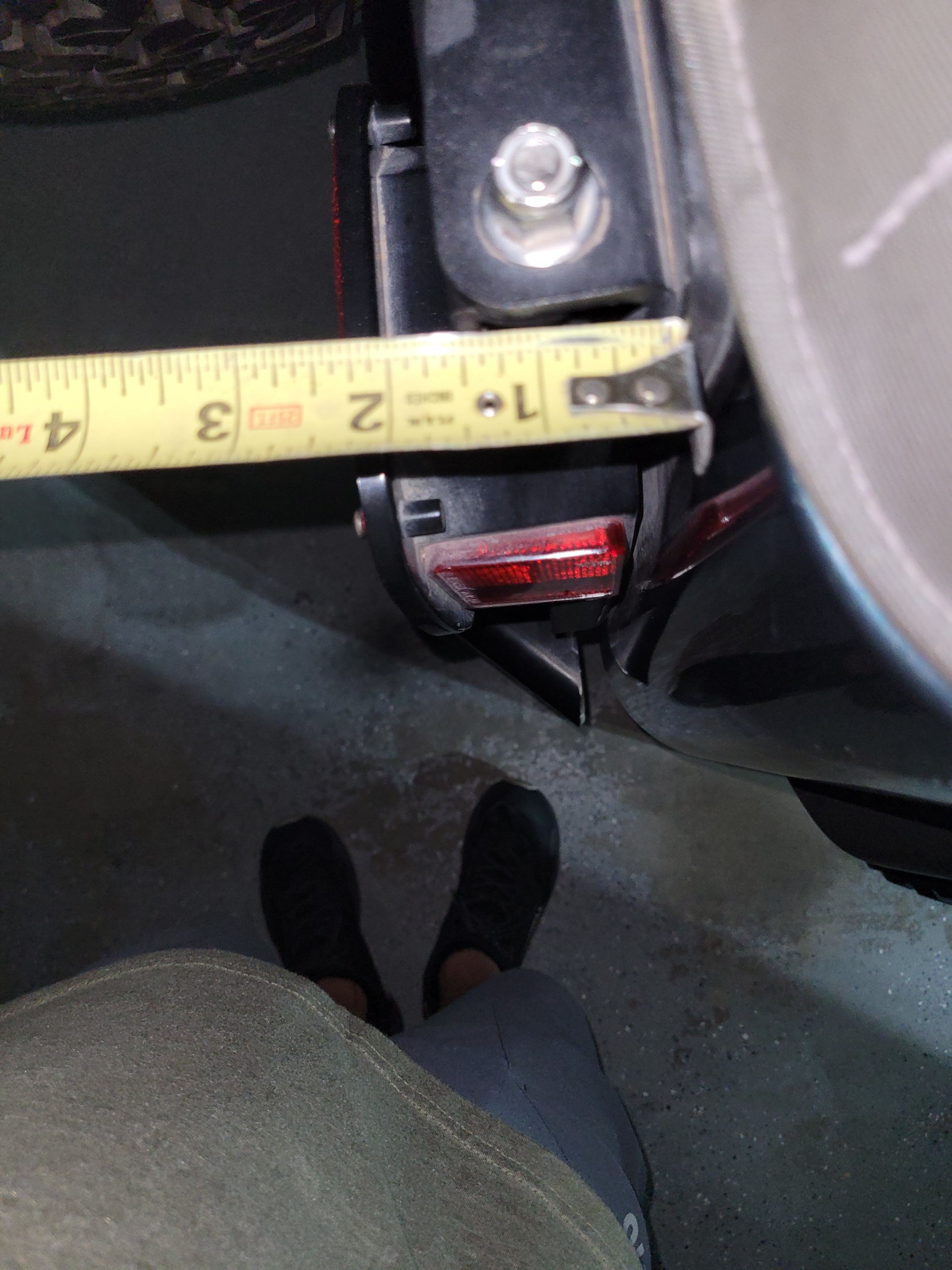

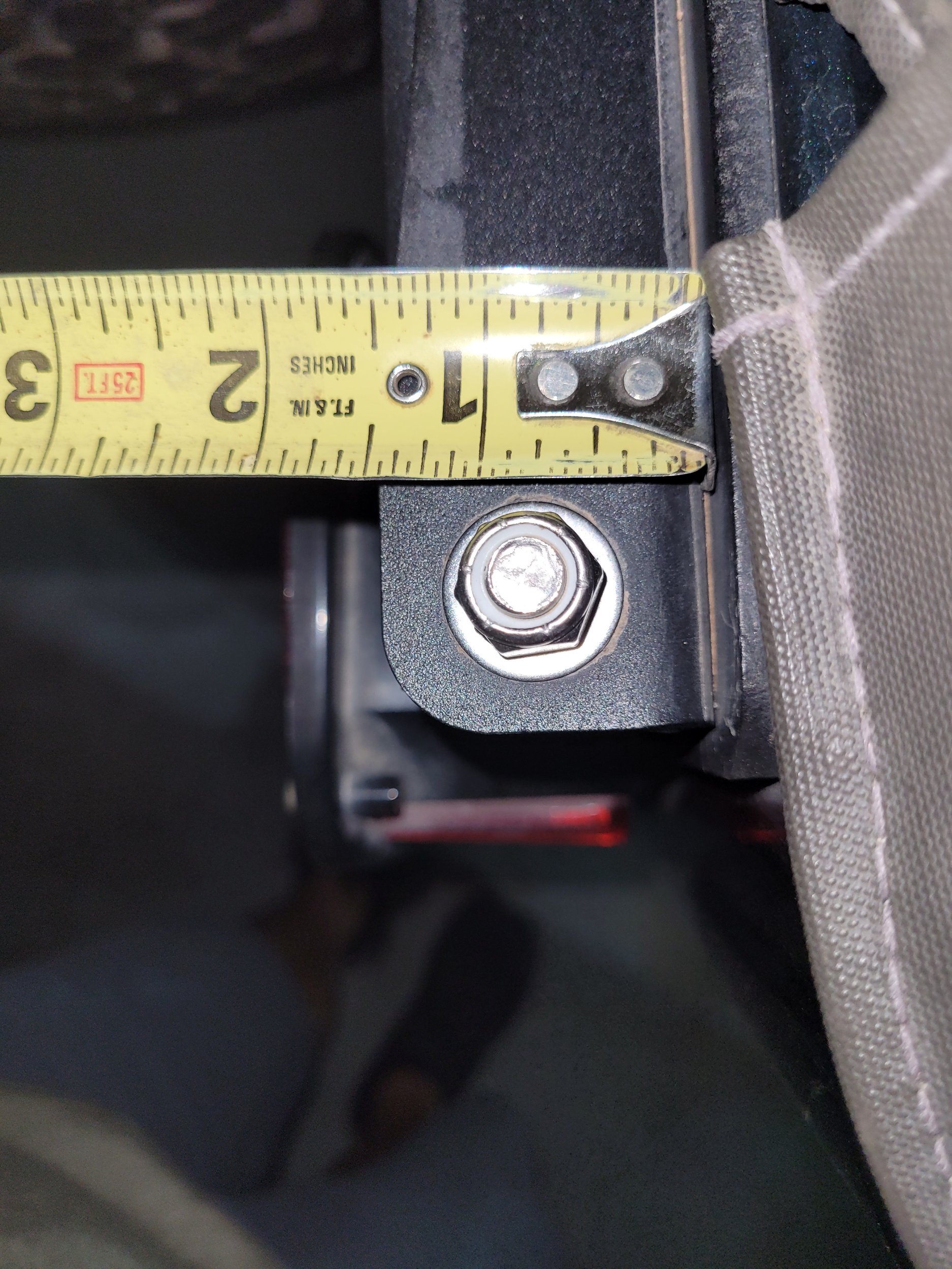

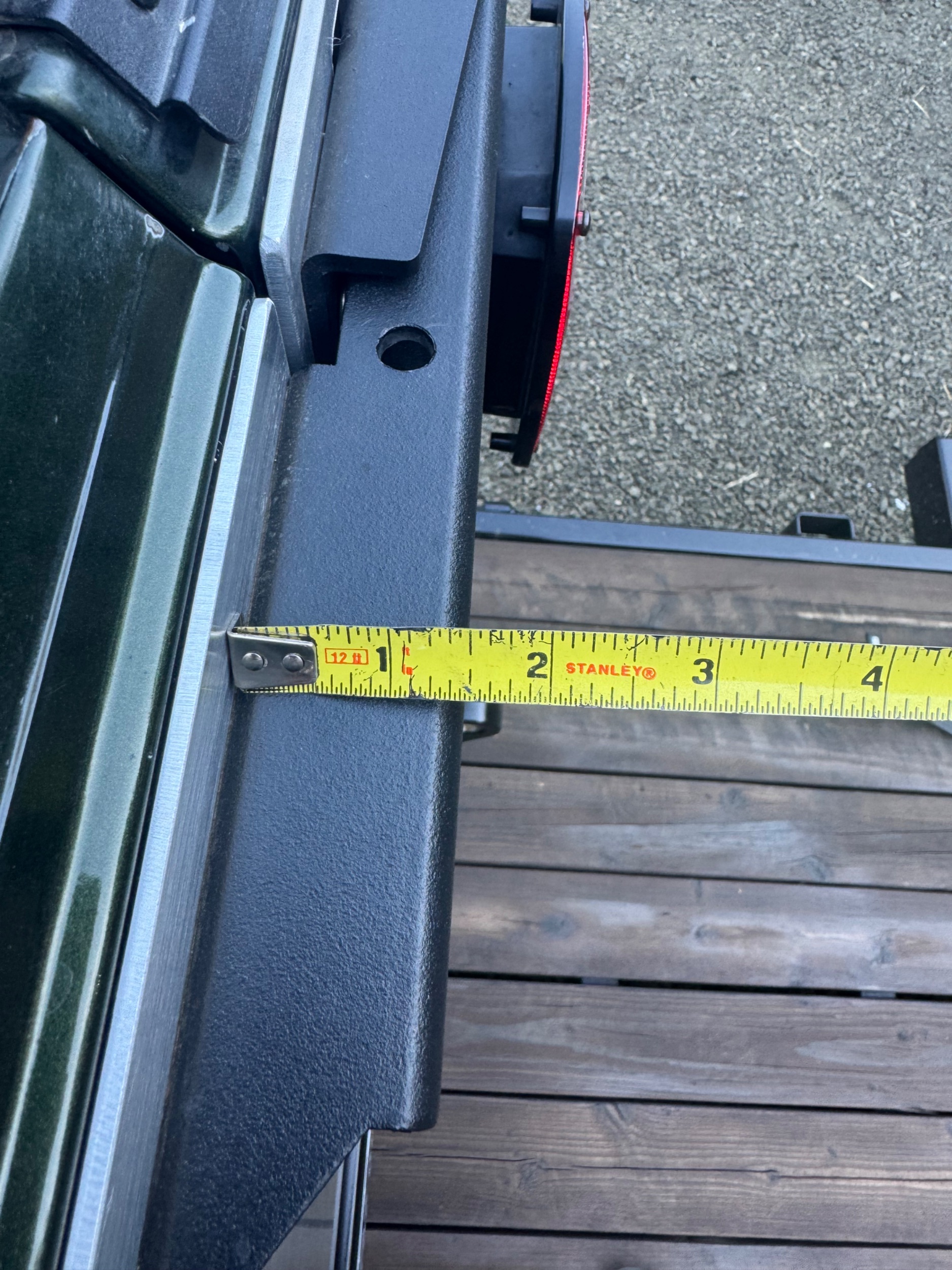

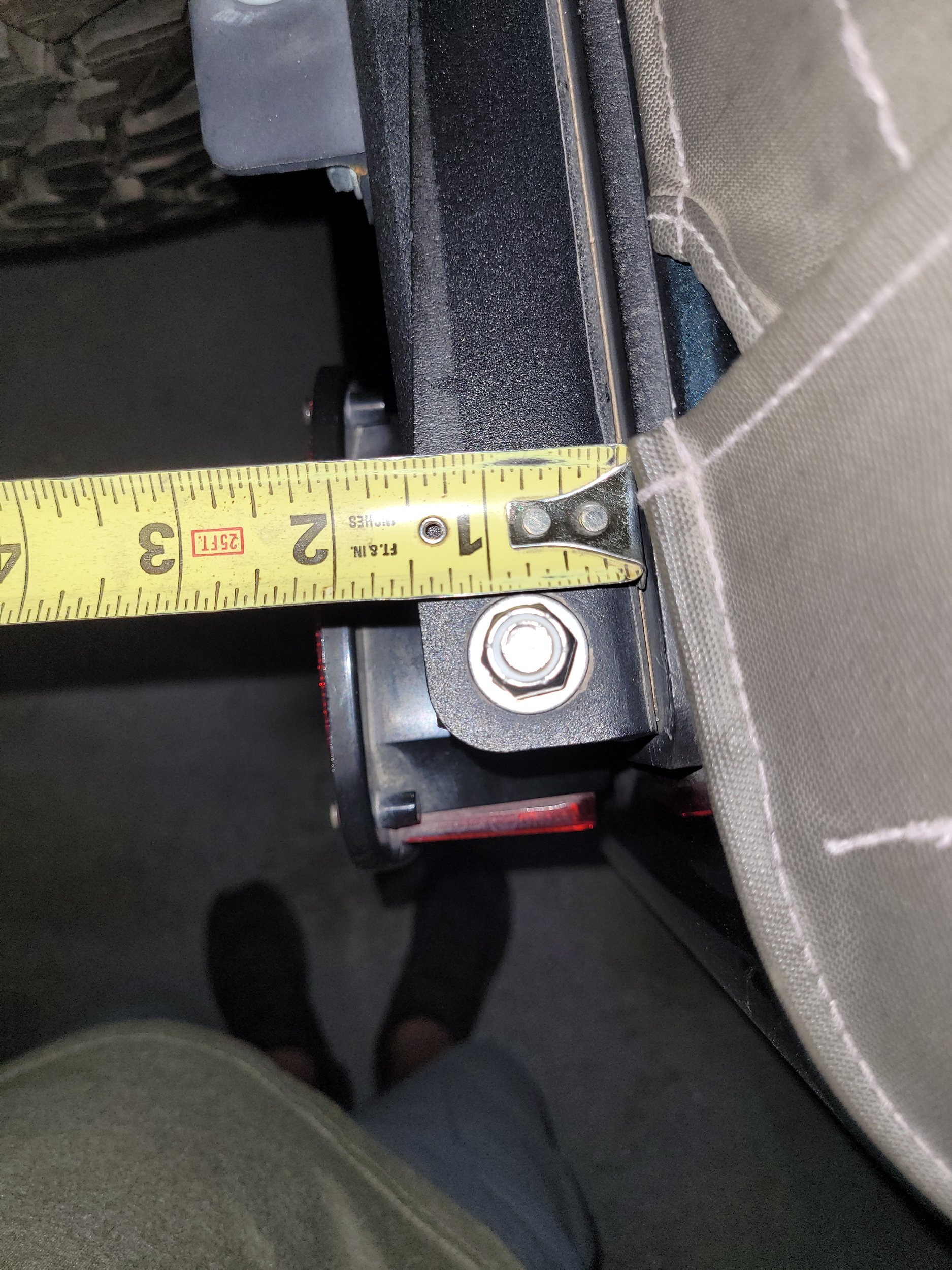

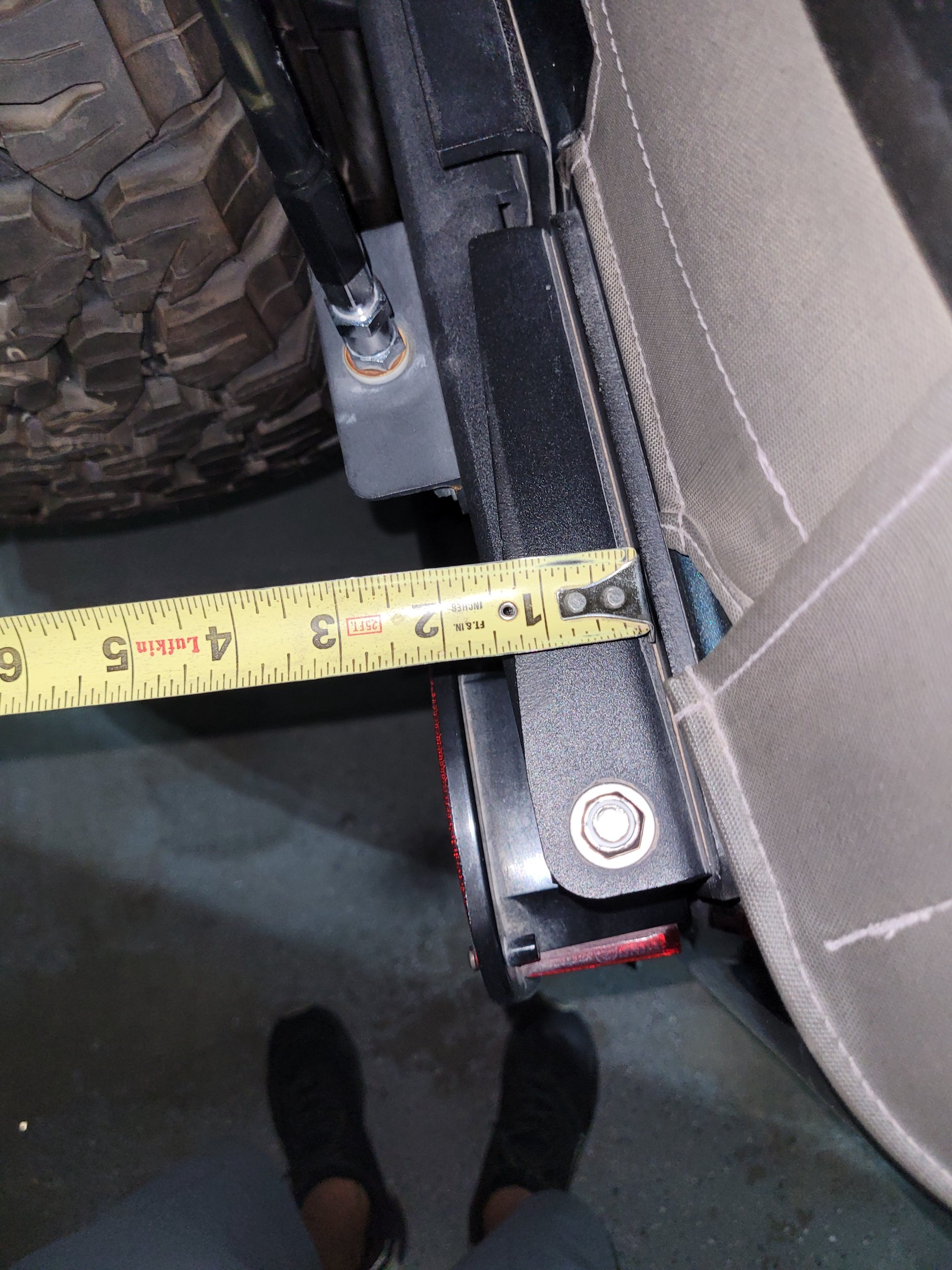

Those are cool. I think maybe @Jezza has some on his site too? Anyway, the Morryde hinge stands off the tailgate just under an inch and a half which I think would work for OP even where his tire carrier bends back in.
You can see my jeep is on the trailer Mac so I’m making some progress in packing.
Last one with the tape off to the side are from the tub itself. The others are from the MORryde plate/skin on the tailgate. View attachment 634378View attachment 634379View attachment 634380View attachment 634381
Thanks. Looks like I have about 0.25" to play with. Appreciate this! Thank you.
