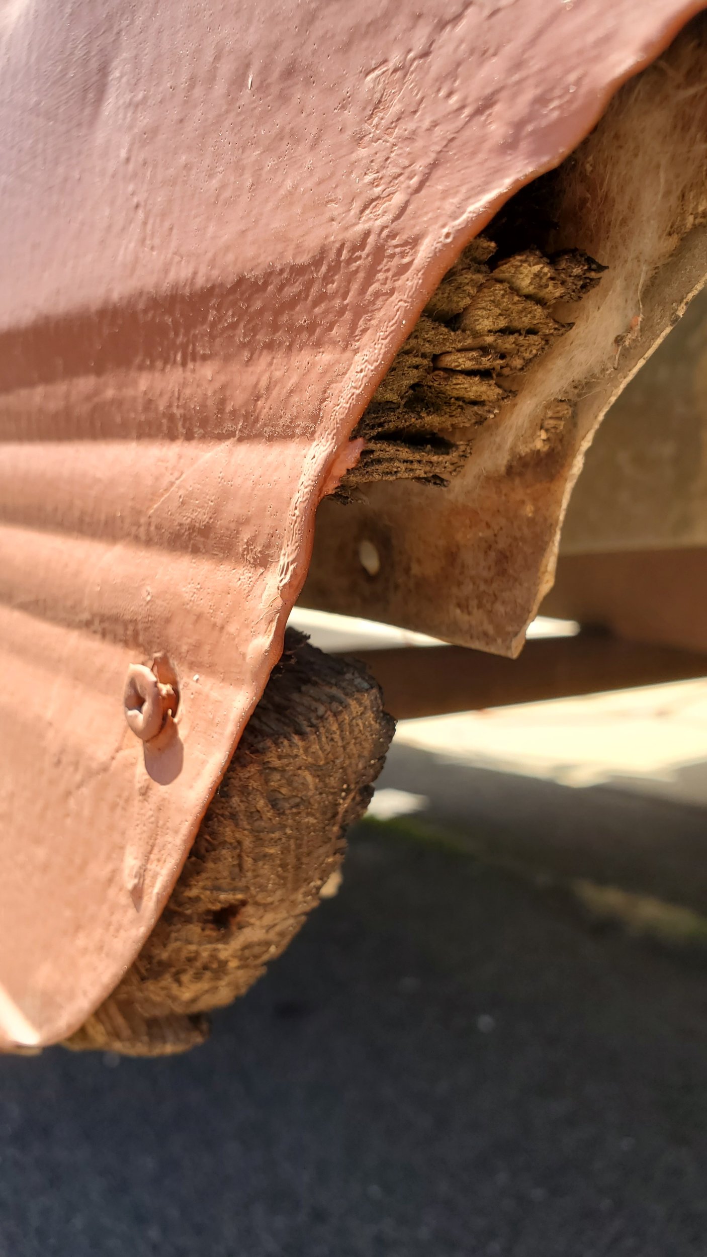

It tows nicely and doesn’t sway much for a 1200 lb, single-axle camper. The jalousie windows still function, the floor is solid, and all the lights work (including the interior ones when hooked up to a power source). However, it’s not without its issues. While the exterior isn't in terrible shape, it does have hail damage from several years ago. The rear jalousie window was shot out and replaced with a piece of plywood. The skirts are rotted, and at least one ceiling beam has succumbed to rot. The water tank was removed at some point, though I have no idea when. The interior has water stains throughout, so there’s going to be some fun discoveries once I start peeling back the skins.

We enjoyed using the camper as-is last year. It’s cozy and has been a lot of fun to stay in. But this year, I’ve noticed more interior water stains, the countertop is shifting, and the front of the camper can be pushed in quite a bit from the outside, meaning the structure is definitely compromised.
To get it in the garage, the axle will need to be removed, and the body of the camper placed on wheel dollies. Even then, it will be a tight fit under my 7-foot garage door.
