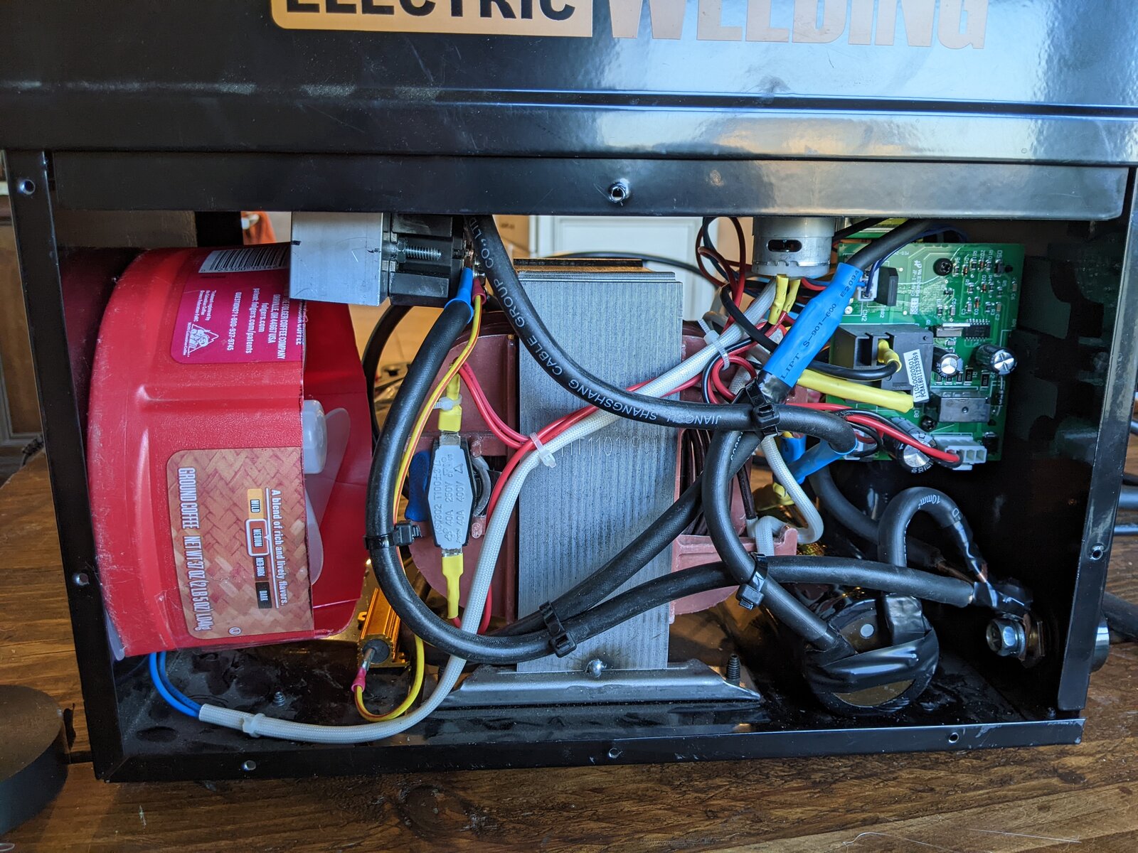

Final product.
There's a capacitor sitting upright on the left edge, and if you look down next to it you can see the bottom of the other one, laying down.
The gold colored thing in the bottom, to the right of the transformer with the yellow/red wire is the bleed down resistor.
On the other side you can see the top of the capacitor laying down on the right. The rectifier is hanging from the top, with the aluminum heat sink protruding down into the discharge of my Folgers brand fan shroud. The fan was previously in the open air, which is a horrible fan arrangement. It should actually move air through the cabinet now instead of just recirculating around the fan itself. I haven't actually used it enough to be able to perceive any improvement in the duty cycle, but my in laws sent the Folgers can home with my kids to play with in the dirt and I had the welder open, so why not.

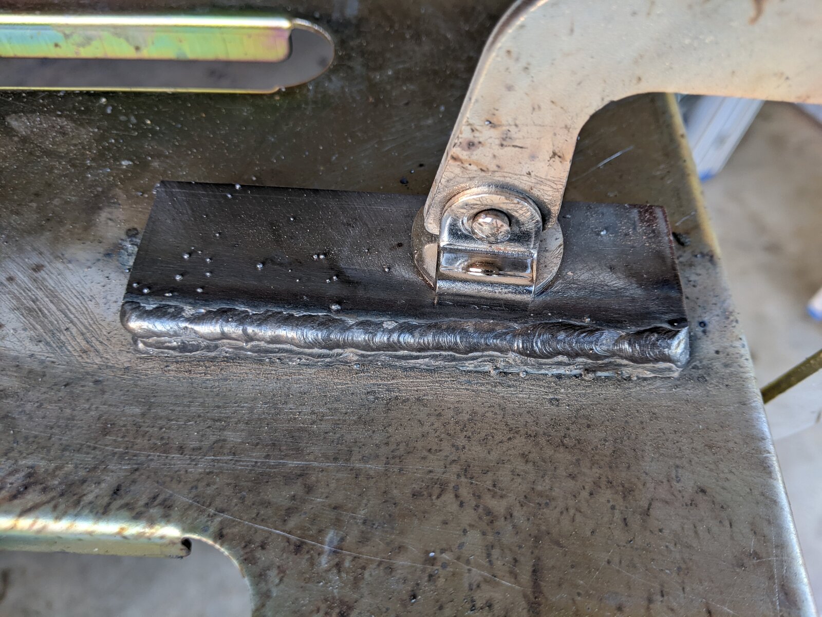

I definitely seem to be putting in more heat and less spatter. Don't have an oscilloscope so I can't say what the waveform looks like, but this looks better than the last job I did.

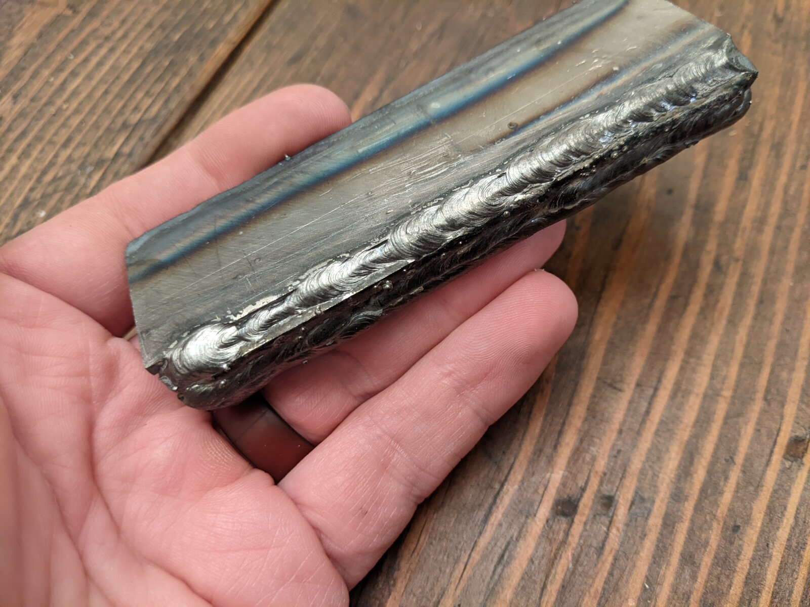

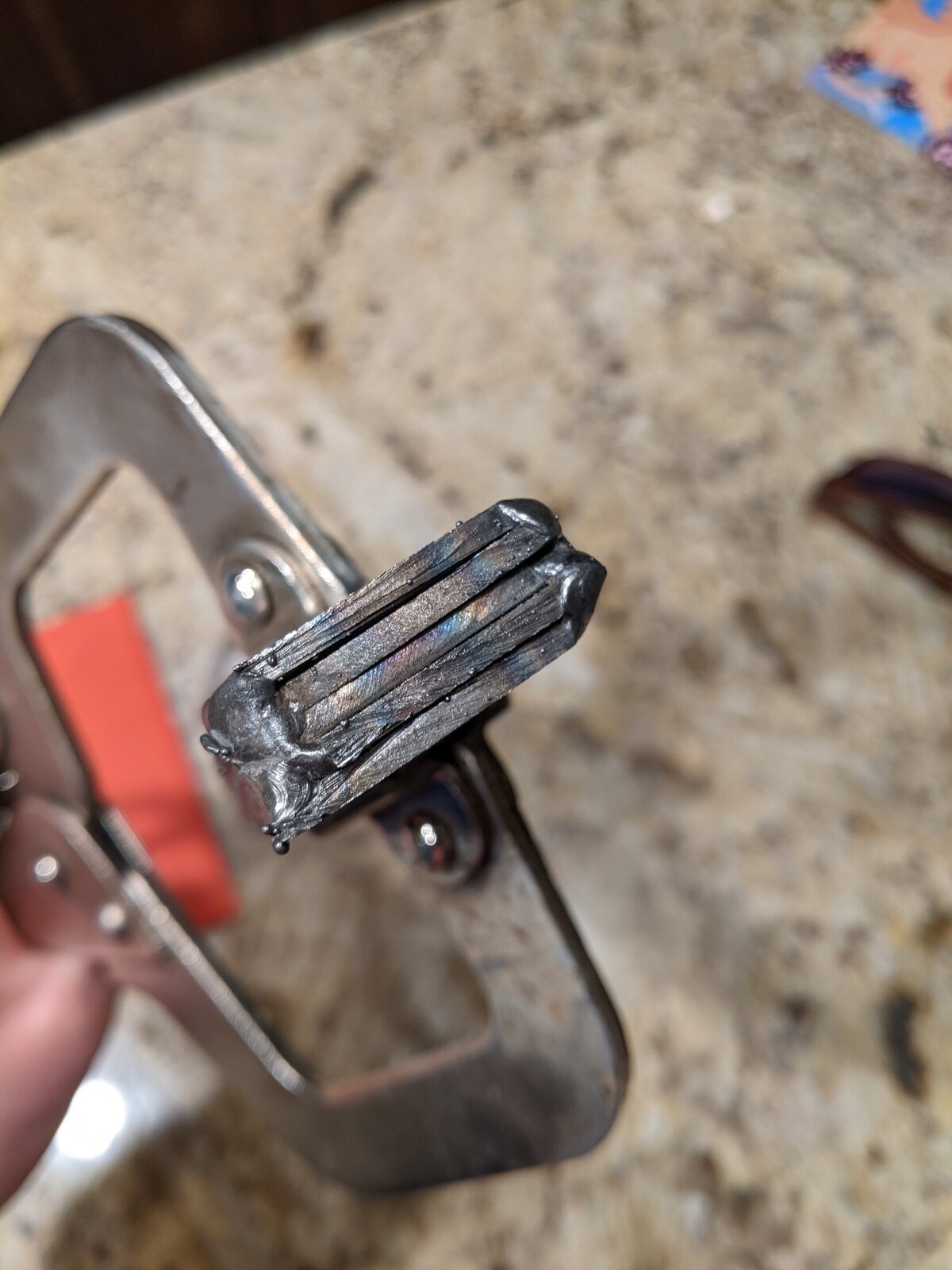

I'm working on a weight to approximately equal a 3" section of TJ frame so I'm welding strips of 1/8" x1.25" bar into a block. I started by laying two together, offset by 1/8", to do a lap joint. Flipped it over and welded the other side, then added another strip with a lap joint and then had a single bevel edge joint on the other side (the bevel being formed by the bead of a previous lap joint). Repeat until I had 5 layers and took a break for dinner.
My first lap joint had spots that were ok, but a spot where I moved too quickly.
My last edge joint (on the right, below) looks pretty decent to me.
What this is all for is I'm going to put together a strap to go around the frame and attach this to it so I can mount it on the passenger side behind the t case skid; to see if the weight of 3" of frame has any affect on the oscillating driveline vibration I've had since regearing. That's for another thread. I know there would be easier ways to do this but none that require me to do this much welding so I chose this way to make myself get some practice.
