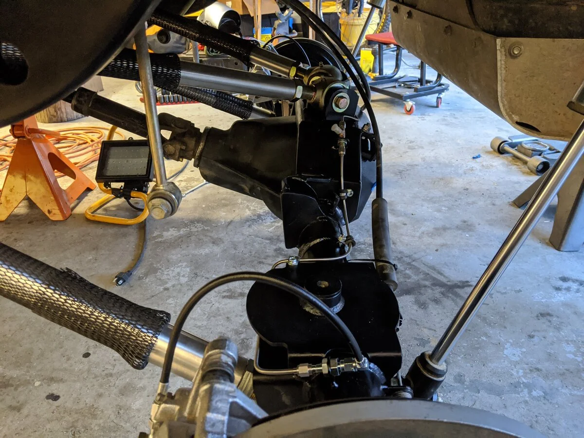

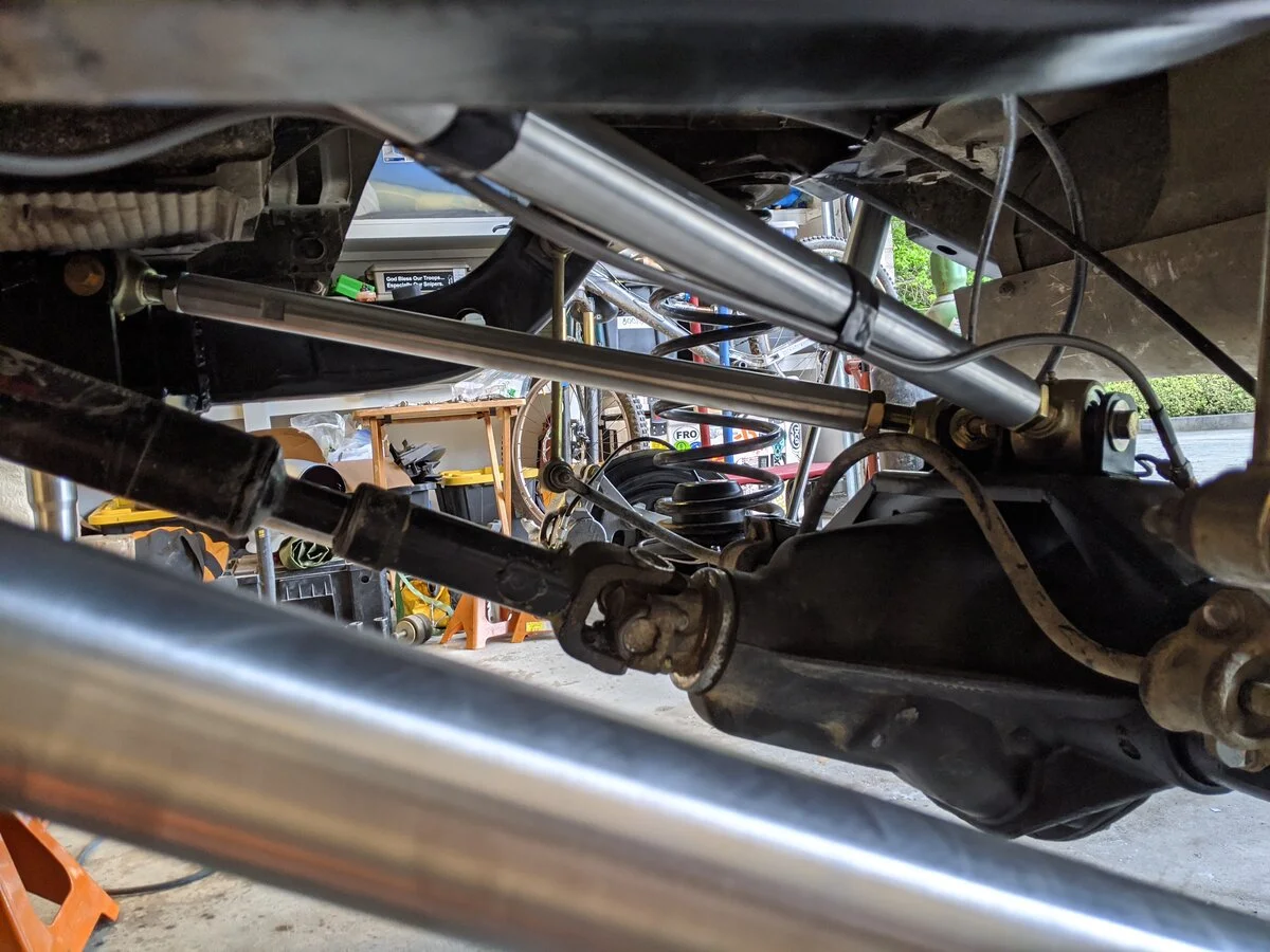

Followed Blaine's guidance mostly on this. Got everything from summit. After the OEM fitting changed to -6AN.
Reactions: TjSteve0305
