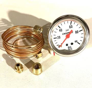

Install one of these temporarily. If you use a tee fitting you can use both and see what the pressure is compared to the electrical circuit
What is “one of these” and what is “both”?
