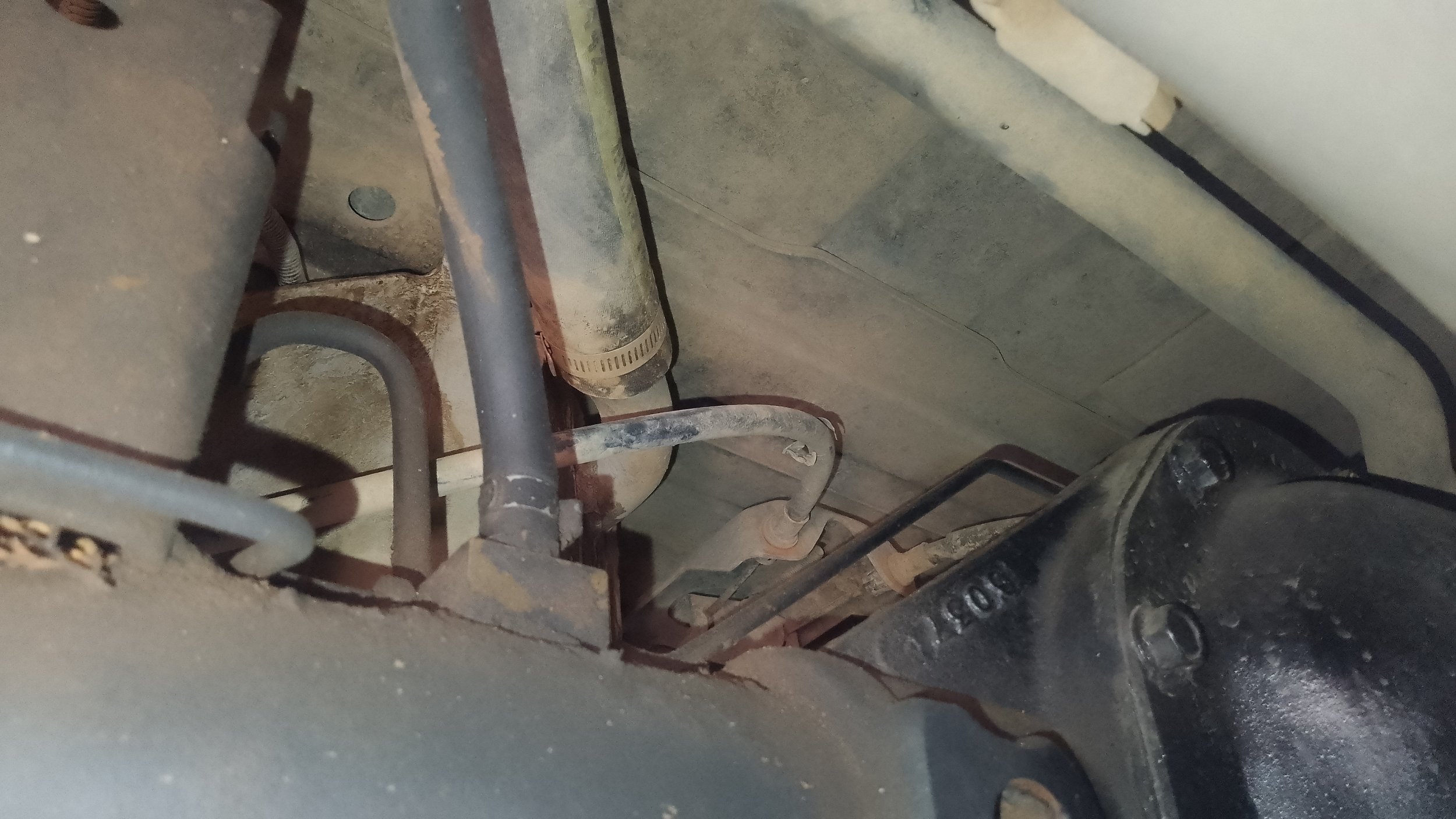

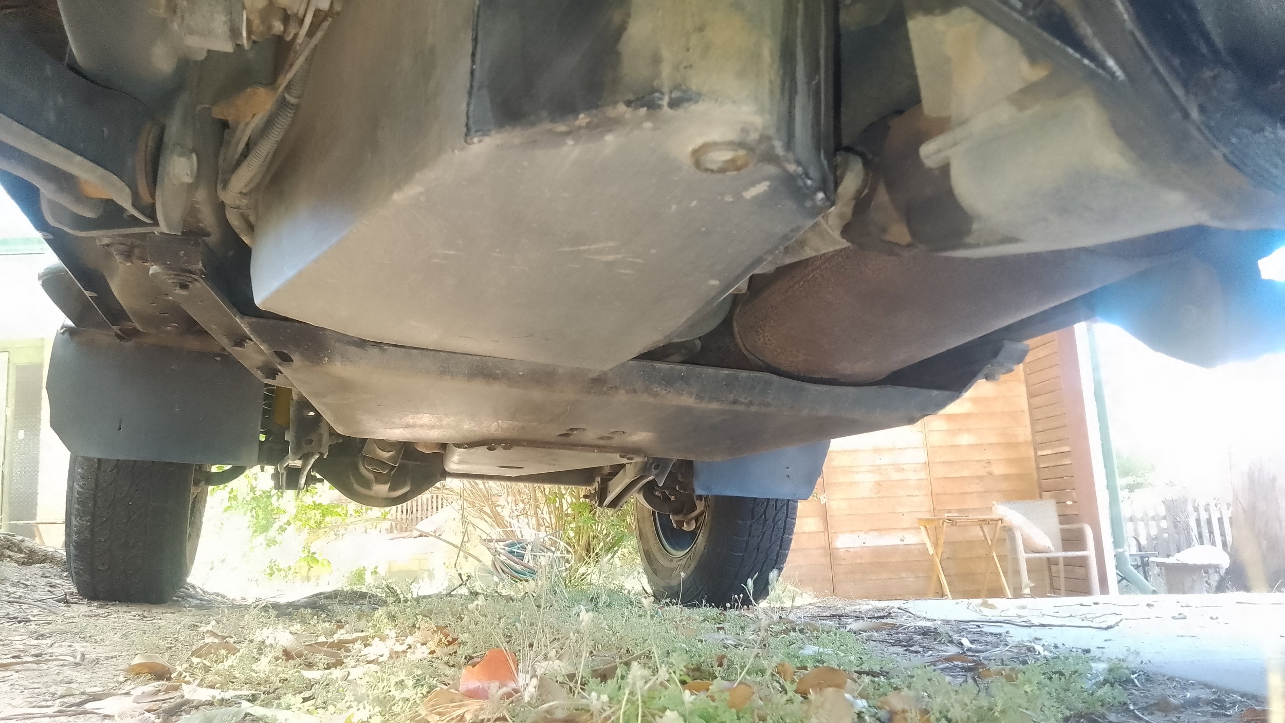

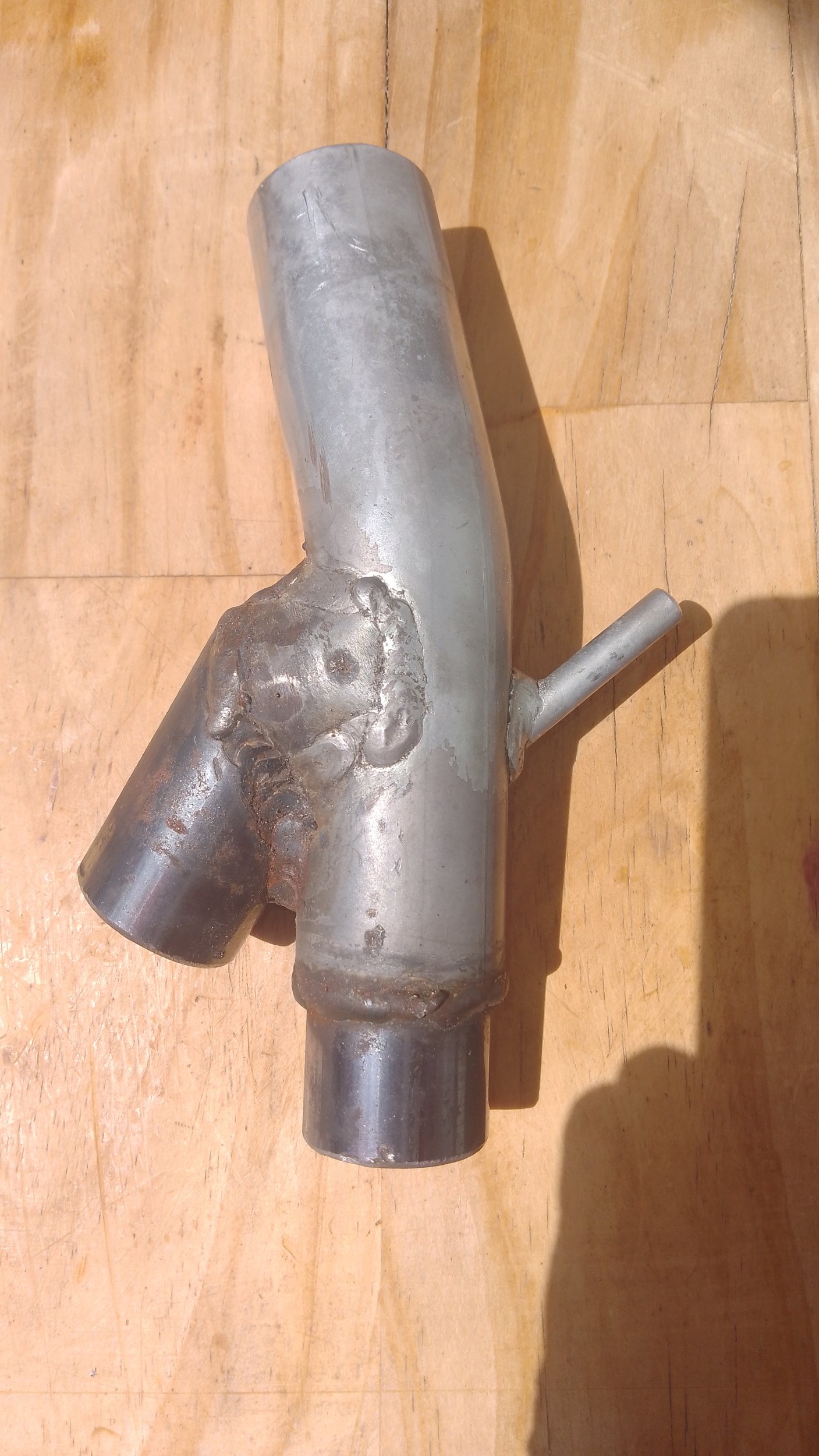

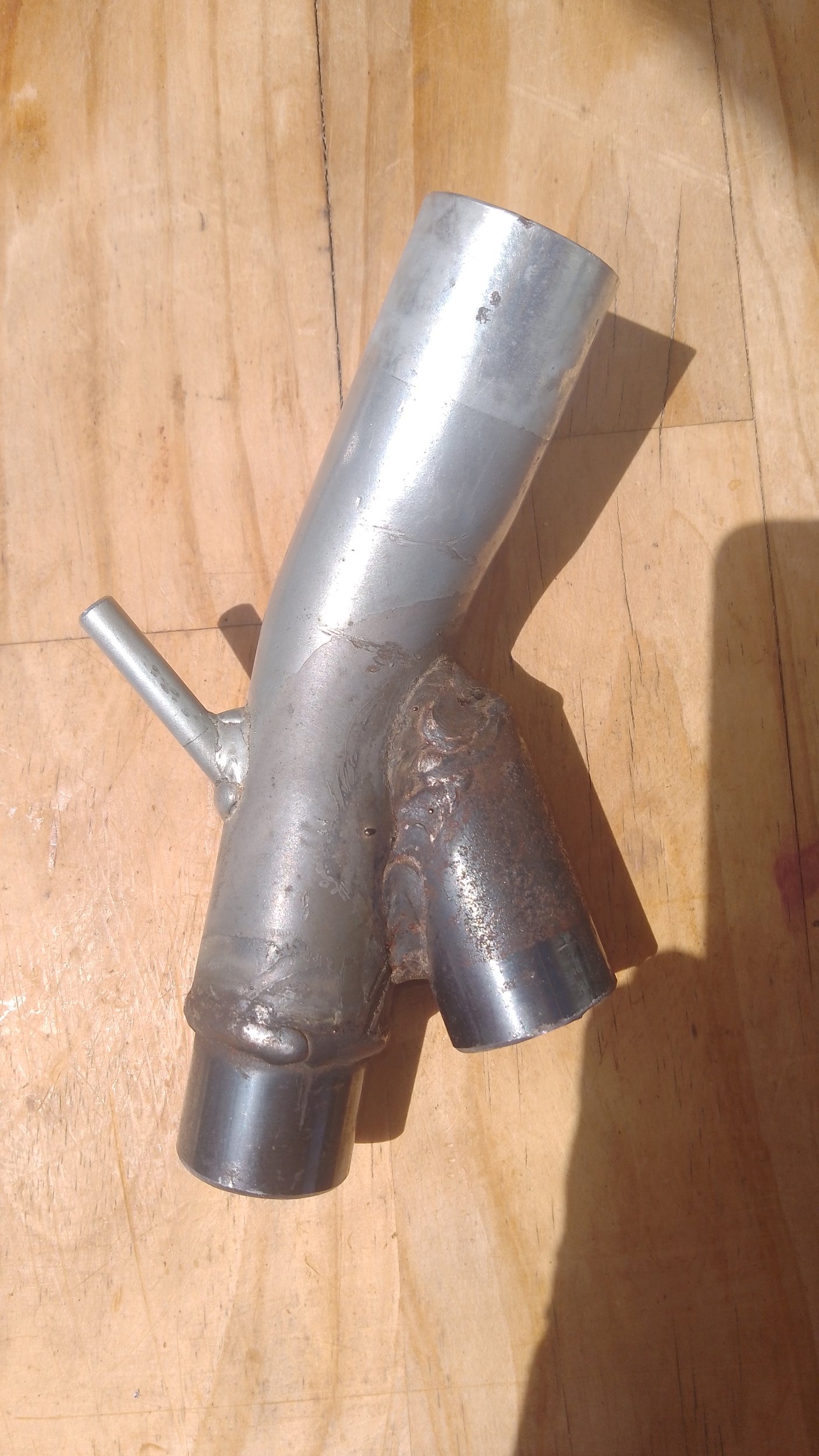

I've got that long ranger tank. The tank itself is well made. The other parts not so much. I got it installed in a shop and they used a jerry can to fill it up the first time. When I went to the petrol station to fill up, it took me half an hour to get about 40l into a system that should take 117l. That's caused by the absolute piece of shit that they deliver for the filler neck:
Looks like the apprentice got his first opportunity to use a welder. The inside is rough as the Grand Canyon. If the fuel actually makes it through that bottleneck, it has to flow through a horizontal pipe that has a dip upward to get over the rear axle.
I re-designed the filler neck and got it welded. That set me back about 500 bucks for a new filler neck, the additional pipes and welding. I wrote a thread here somewhere.
I get my tanks filled up to the limit each time now, actually in reasonable time.
It would be better to have a second filler neck for it elswhere but there is not much room.

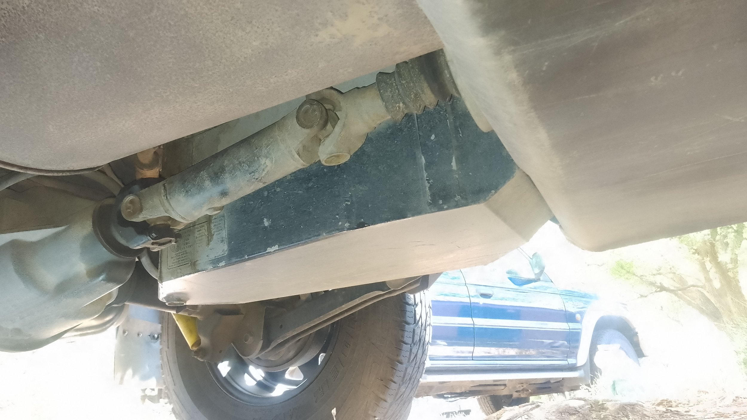

I'd love to have the genright as well but I can't tell if it fits. The hose to the aux tank is massive and goes over a dip on the original tank. If the genright uses that wasted space, you can't have both together.
Range wise - great! I get 850km out of them.
