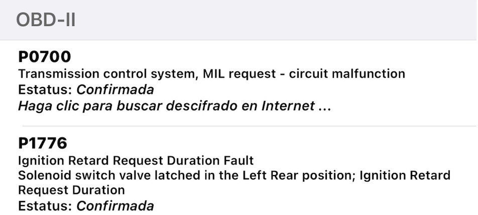

The error code that appears when scanning is P1776:
“IGNITION RETARD DURATION FAULT. Solenoid switch valve latched in the left rear position; ignition retard.”

But seriously, the thing I love about the 32RH is that I never need to consider that the computer might be causing part of the malfunction. With the 42RLE there are so many more variables. And honestly, I don't have anything concrete to offer in the way of troubleshooting. The P0700 is a basic TCM issue, usually coupled with another code, so I wouldn't worry about the P0700, it will most likely clear once you fix the P1776. I don't see any way it's related to the radiator change, unless there is a problem with the trans cooler section....I suppose that could explain why it takes a while for the problem to appear; it needs a sufficient amount of heat buildup to trigger the issue? You'd need to be running a trans temp gauge to have any idea if this is the case, and the conventional wisdom is that on this transmission you absolutely should be running a temp gauge. So there's that.
My default answer at this point would be to inspect your wiring, and (perhaps) obviously verify that your solenoid is actually working. You can pull it out and put 12V across it. You should hear it click. Wiring harnesses at the age & level of abuse tend to develop cracks & shorts that can lead to odd things. But if it is repeatably internmittent and somewhat timing based, I'd tend to be less suspicious of the wiring.
A quick google says it could be the range sensor, but idk if the 42RLE has one (the AW4 in the Cherokee does, 32RH does not), and then there is always the generic "you've got some schmutz in your valve body."
