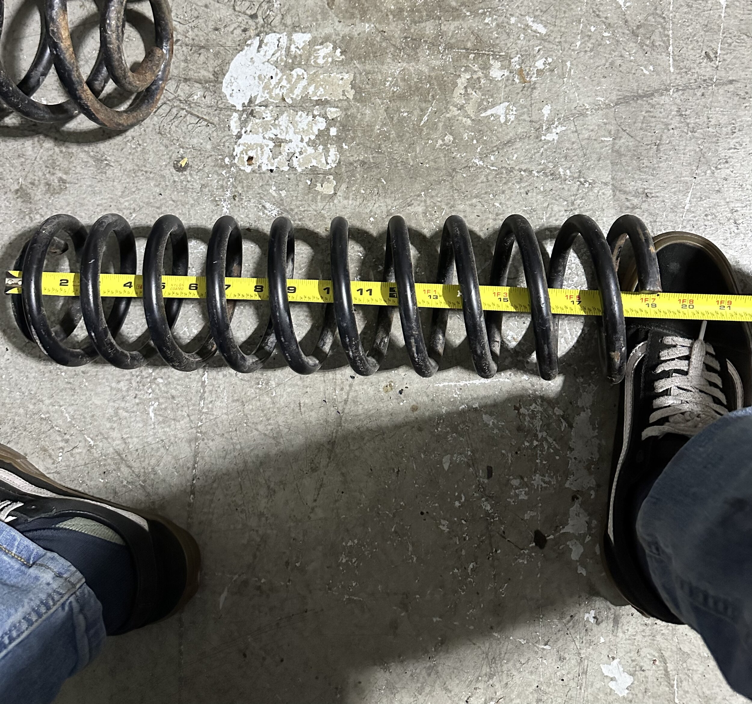

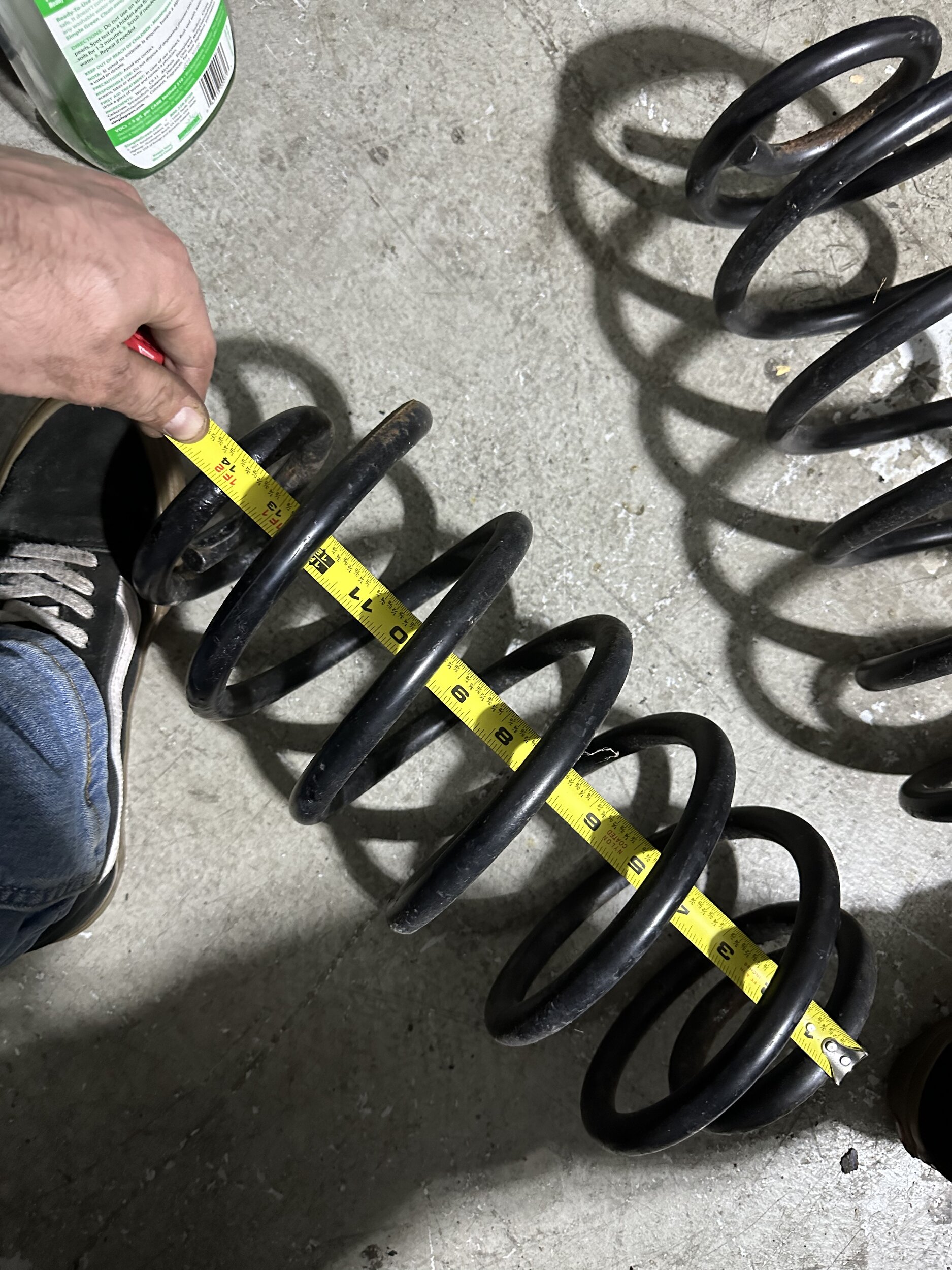

Looking to get some information on a set of springs I picked up second hand. I was told they are OME 3 inch springs but I have no way to verify and they do not appear to be branded in anyway. Ive attached photos with measurements if anyones able to identify them. Im only in them 20 bucks so not too worried about it. Thanks!
Rear spring measuring 14 inches
Front Spring measuring 19 inches

OME 934’s measure 20.08” extended when brand new.
OME 942’s measure 14.96” extended when brand new.
I’d make sure and measure those accurately, from tip to tip, and then expect a little sagging. Seems reasonable since your measurements are not done correctly as per your pics.
