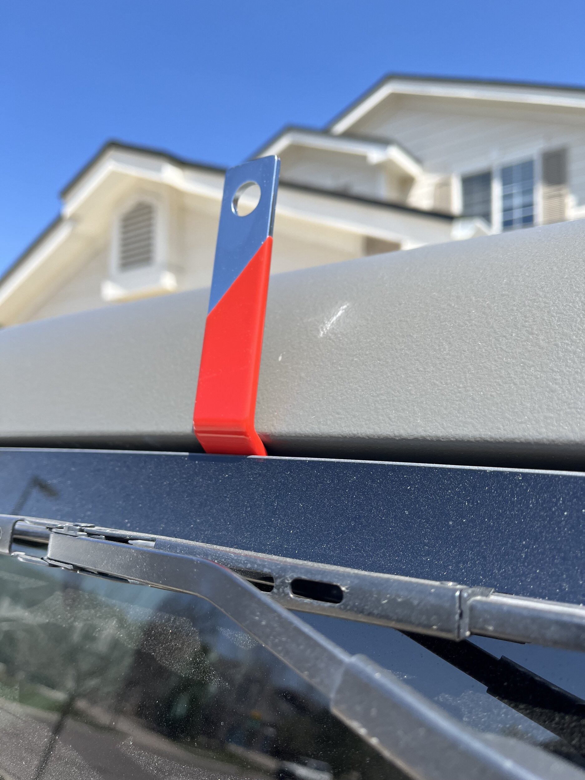

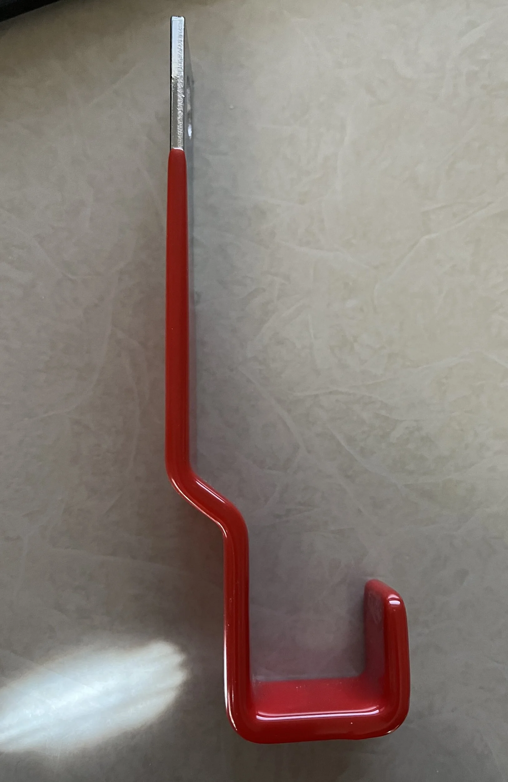

I have the Lange hoist with the red TJ hook and I used it with my previous TJ. I remember it being tight but not so much to concern me. It seems like I had to wiggle it a bit because the hook was pushing on the inside trim.

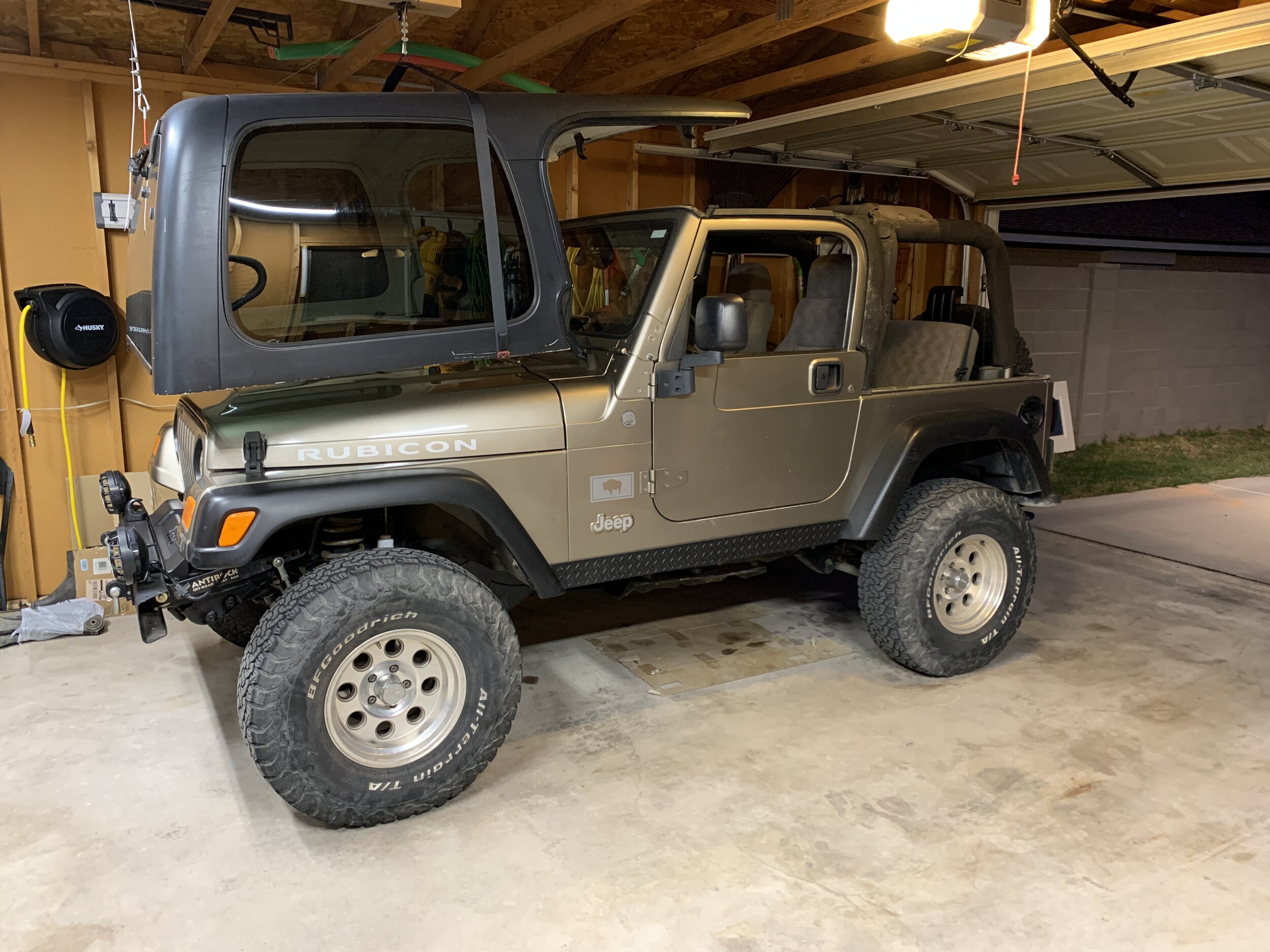

You can leave the window open as well, unless you don't have room against the wall. The ceiling shouldn't be a factor since the front strap connection is long enough that you can't get the top up that high. Here’s mine, about as high as it could go:

Thank you so much for the specific experience. I guess I just don't know what is tight vs concerningly tight. After seeing Alex's post in Midnight LJR's thread, I am a little hesitant. I don't really have room for the open window, and will be using the T-frame instead of the strap system. I do appreciate your photos though!

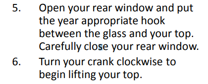

From the Simple Hoist instructions (attached, page 8 of 11):
I'm trying to think of a reason why it would matter.
