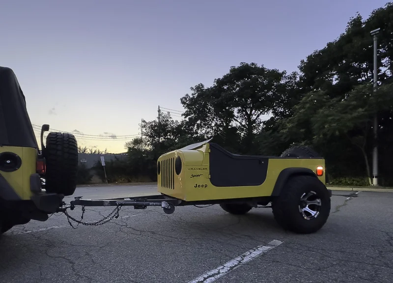

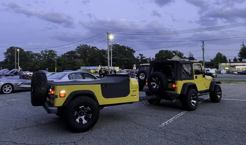

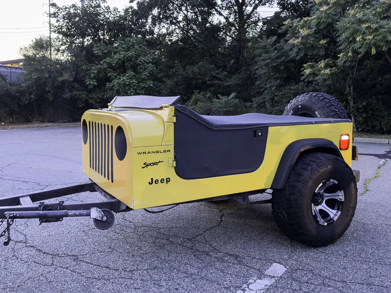

I've started looking for an off-road trailer and someone in my area posted this for sale...
I had seen it on the road a few months back but only once. He recently listed it on local FB MP.
'96 YJ tub
Pretty basic.
Everything from the firewall forward and belt rail up has been removed.
Originally built using the forward frame rails squeezed together to form the tongue but later added 2x3 rails and a hitch
Tailgate remains functional
Inside is basically just gutted.
Retains the stock Dana 35 rear axle and parking brakes.
The soft doors are neat way to gain access to the front of the tub.
Custom tonneau cover.
Estimated weight is 1200lb
He is asking $3500.
Registered as a DIY trailer
I'm looking for something to put a RTT on and the absence of mounting where the doors are is a show stopper for me. I have my heart set on either a Dinoot or Tentrax but thought this pretty neat.
