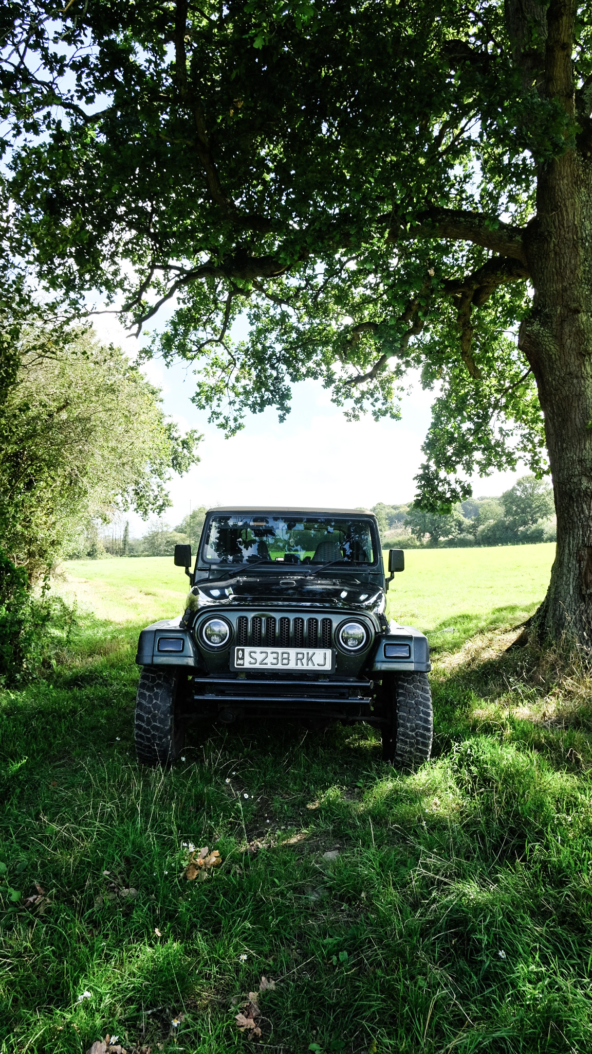

I’ve seen many posts on this issue and sorry to make another one, but I felt I needed to share this information to all Jeep enthusiasts in the UK or even Europe that I recently had with my TJ with the May and Scofield immobiliser issue. But a lot of answers were from people in the USA Most people haven’t had much of an answer other than getting one from the US shipped over which is costly. Just wanted to give details of the company ECU DECODE which I just used to remove the immobiliser from my ECU. Amazing, got it back in two days. If anyone else is struggling with this issue I can’t recommend them enough!! My Jeep started up straight away after sending the ECU off to ECU decode to get the immobiliser programmed out when I got it back just plugged it in and it was fixed!
Hope this helps some of you if you’re stuck with this one as I was, before finding these guys!

Totally unrelated, but it's time for an alignment.
