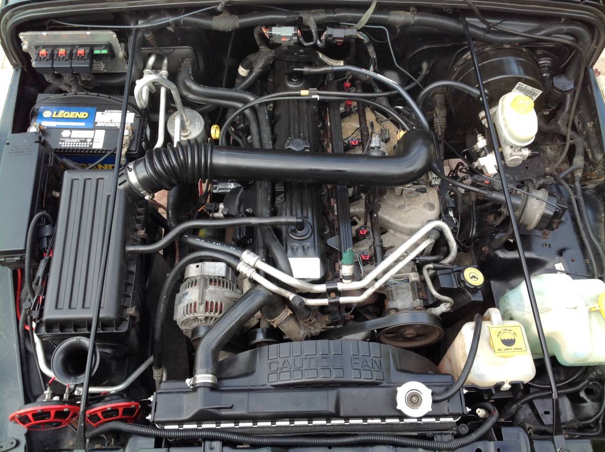

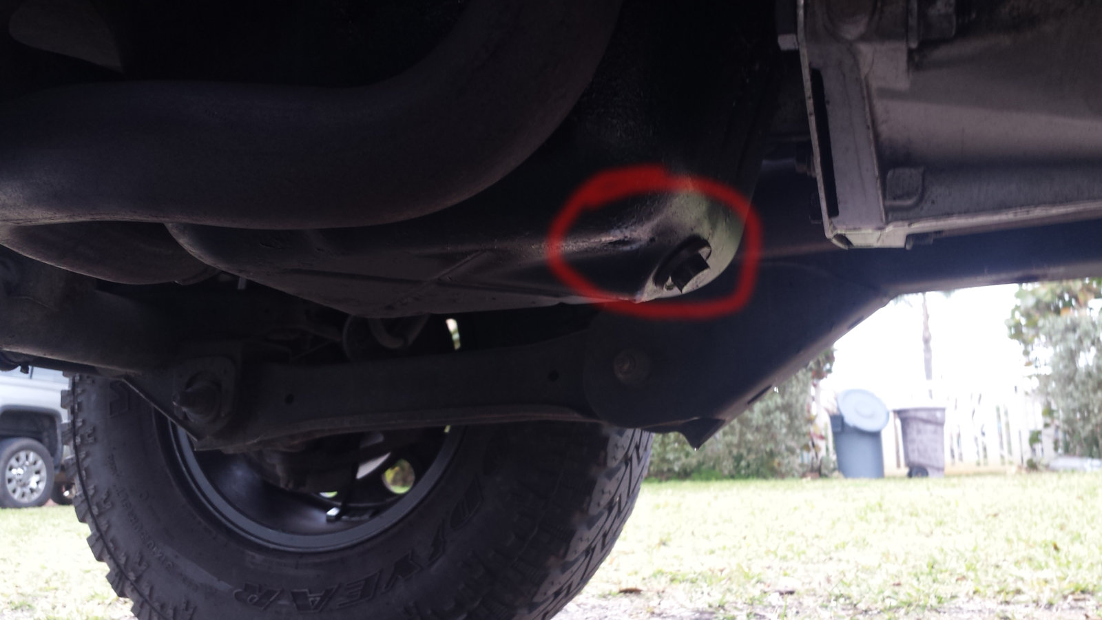

  • After driving it, I did notice a slight oil drip. There's a photo below with the area the oil was dripping from circled in red. Is this just a fact of life with an older wrangler? Or is this a real problem?

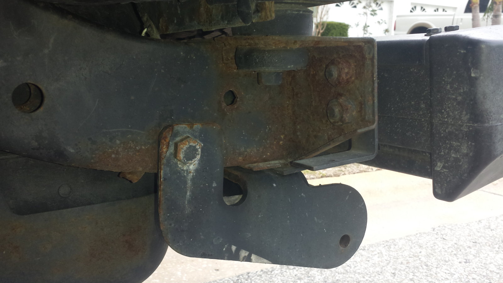

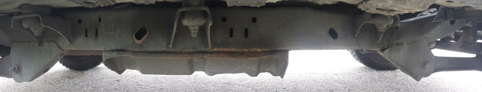

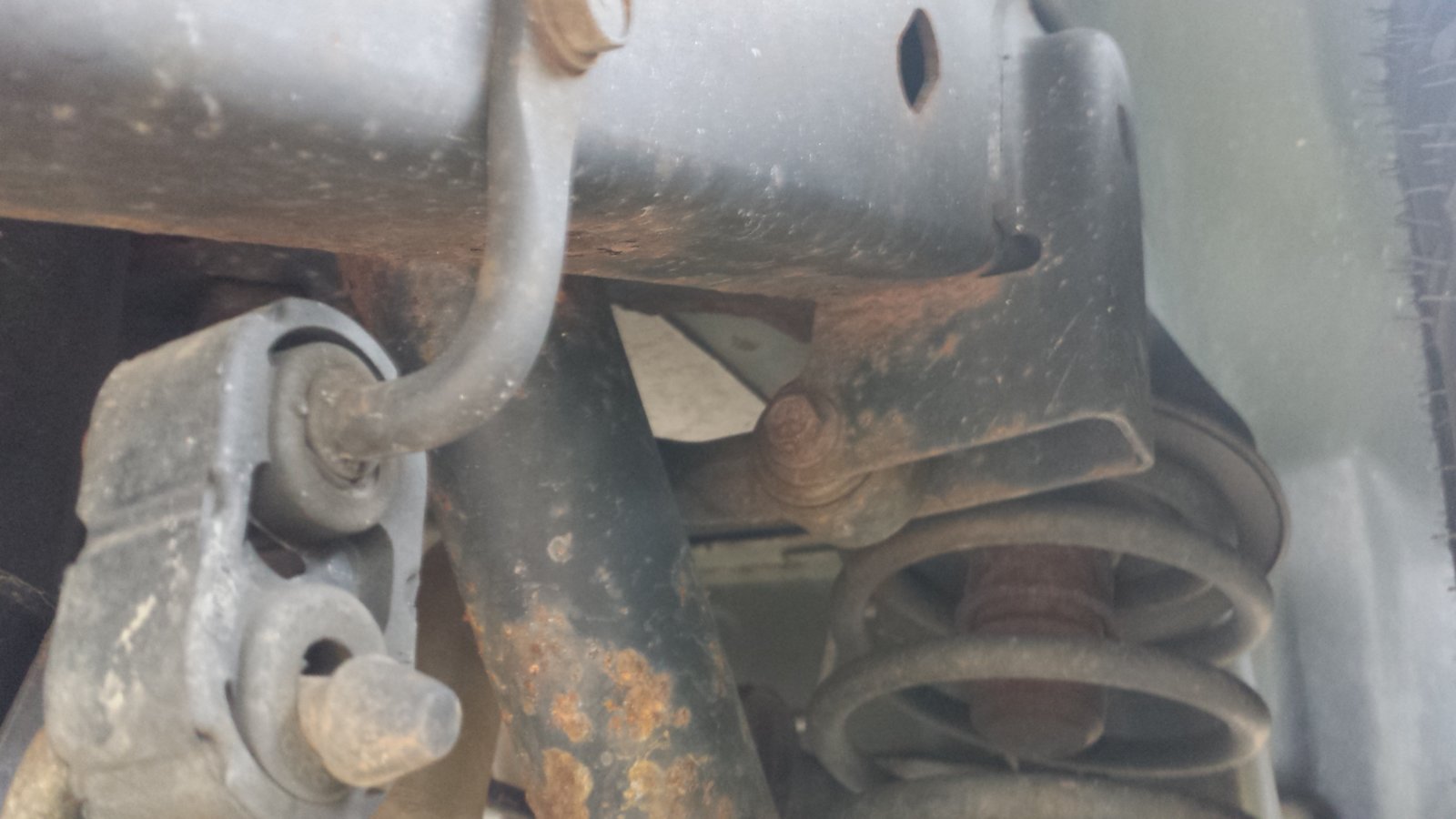

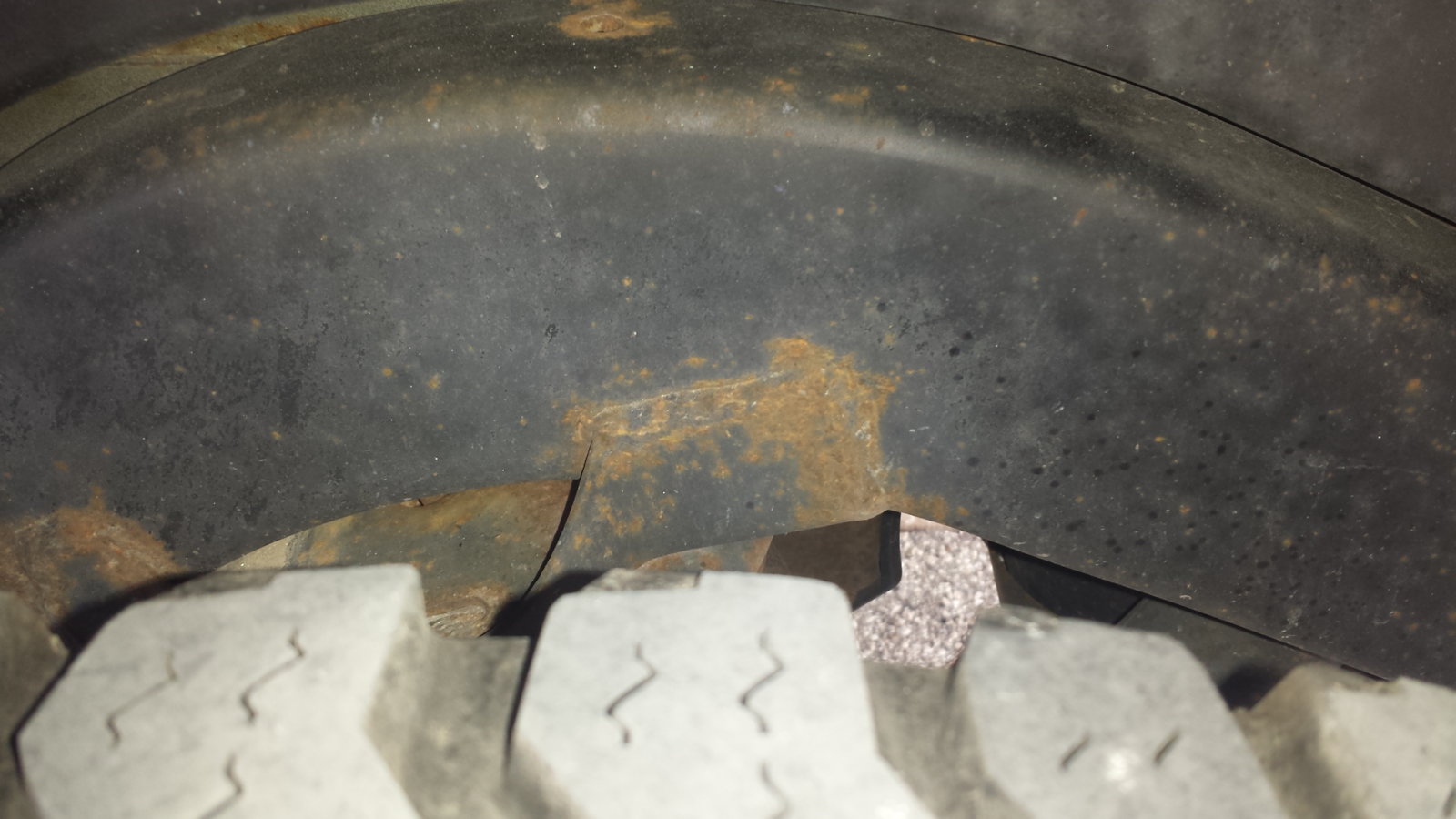

  • I guess we all have our own interpretation of the words "rust free" but I'll be nice and assume maybe the seller is just loose with their words and meant that "some areas are free of rust," because this vehicle is certainly not what I would describe as "rust free." Now, the frame doesn't look completely decrepit, and without knowing better I might even call this amount of rust "acceptable," but I'd like to ask your opinions about what you see. I took photos of the problem areas I could find:

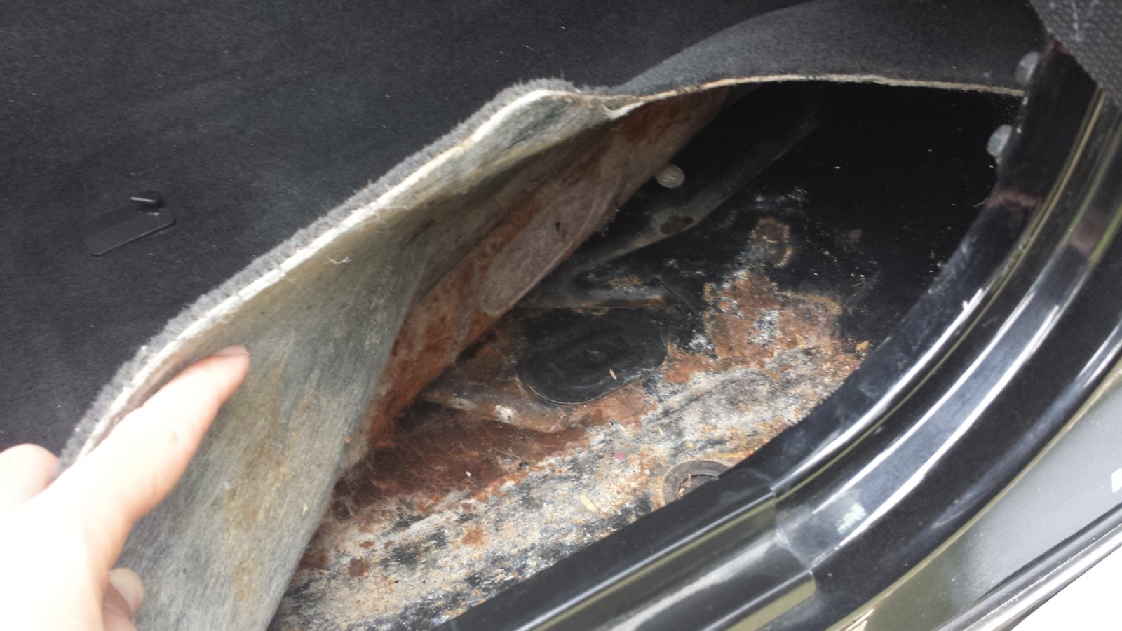

12. Passenger side floorboard. Rust seemed fairly superficial and there was light moisture here. None on driver's side.

12 Location of Oil Drip

Nope, wouldn't touch that thing.
There's nasty rust lurking there, I can tell by the photos. That's far from "surface rust" either.
There may be a few who disagree with me, but having dealt with rust like this before, I'll never do it again.
So my personal opinion is to walk away and find a cleaner one. There's no shortage of clean, rust free (really rust free) TJs out there.

Yea looked pretty good until I saw the rear frame and the passenger floor pan. And where the transfer skid plate contacts the frame looks suspect. I would invest in a boroscope off amazon for your tj/lj search. It makes inspecting inside frames very easy. You can do better for $10.5.

Living my whole life in the rust belt I think that is called rust free by too many people, but I didn't think it looked too bad until I saw these pictures:
#10 the lower control arm mount, I can't quite tell what I'm seeing there.
#11 skid plate to frame area. What my "rust free" TJ had but luckily it was still solid enough to put back together, they ain't all that good.
#12 probably just needs a little work.
I see you're from Florida and would think it's from Florida too. I'm guessing that rust like that comes from too many rides down the beach and not enough cleaning up afterwards.

In Michigan, that would be an OK jeep to start with. In Florida, I'd keep looking. No reason to start off with rust. Its not bad and most of it would clean up easy, but if you have the opportunity, why bother. The concerning rust to me was the amount of rust I saw on the passenger floor board and some of your frame pictures showed rust in the pinch welds of the body. That is a real bitch to clean up...you basically have to cut it out and put new metal in.

I was thinking it was marginal until the last few pics and it's a non-starter for sure. Too much rust for someone with marginal repair skills. You said you were willing to learn, but this one isn't for beginners. Keep looking!
