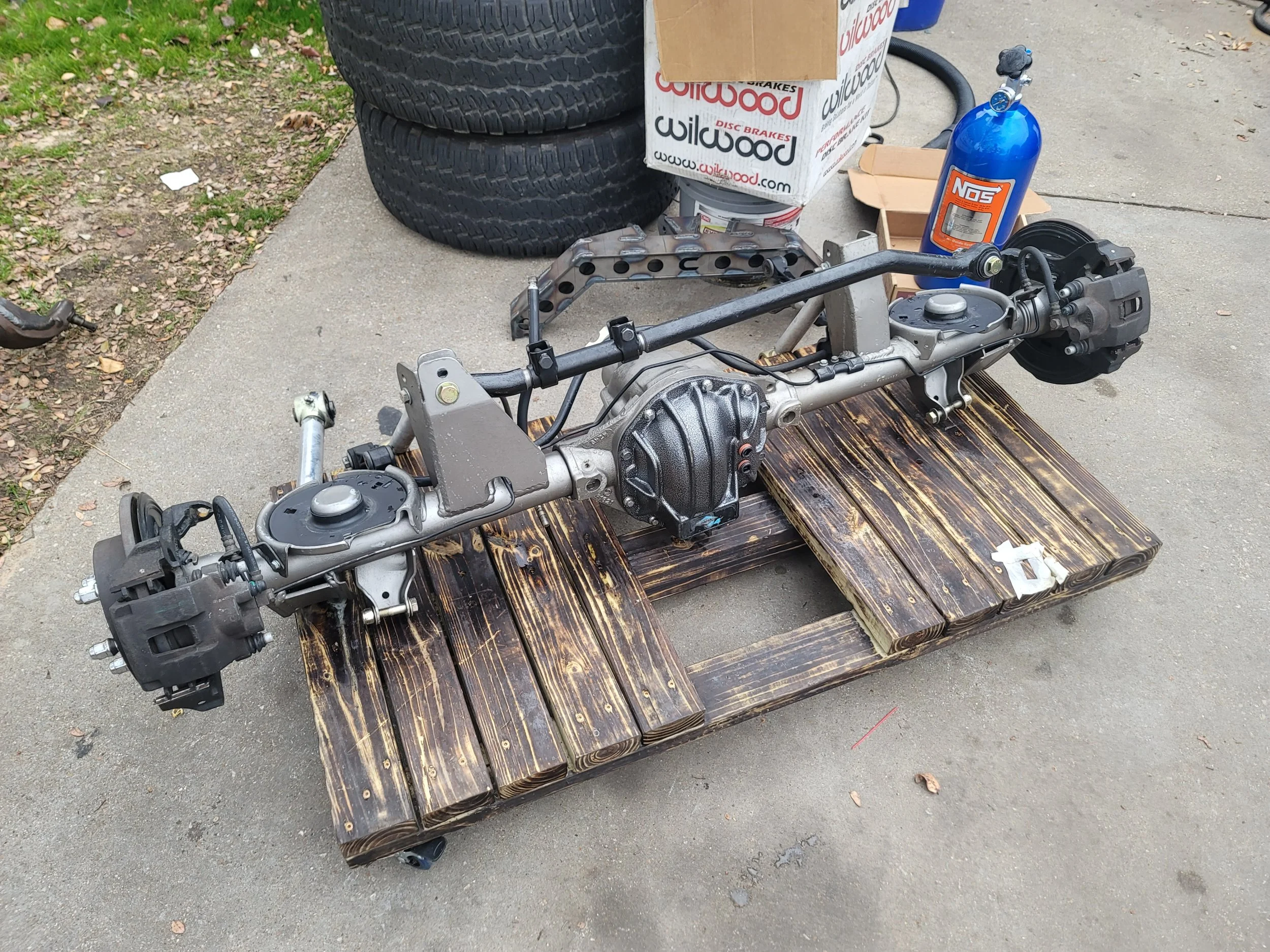

Driving it like a race car everyday 72 miles a day (it's my daily) And using nitrous every now and then with my buddies lol (as seen in the picture below)
Except this time it wasnt my Ring&pinion it was the Eaton trutrac that grenaded itself, the gears in this axle are like new (they have less than 1k miles) What did it for this diff was using a borrowed drag pack and me having a solid hook at the drag strip lol
