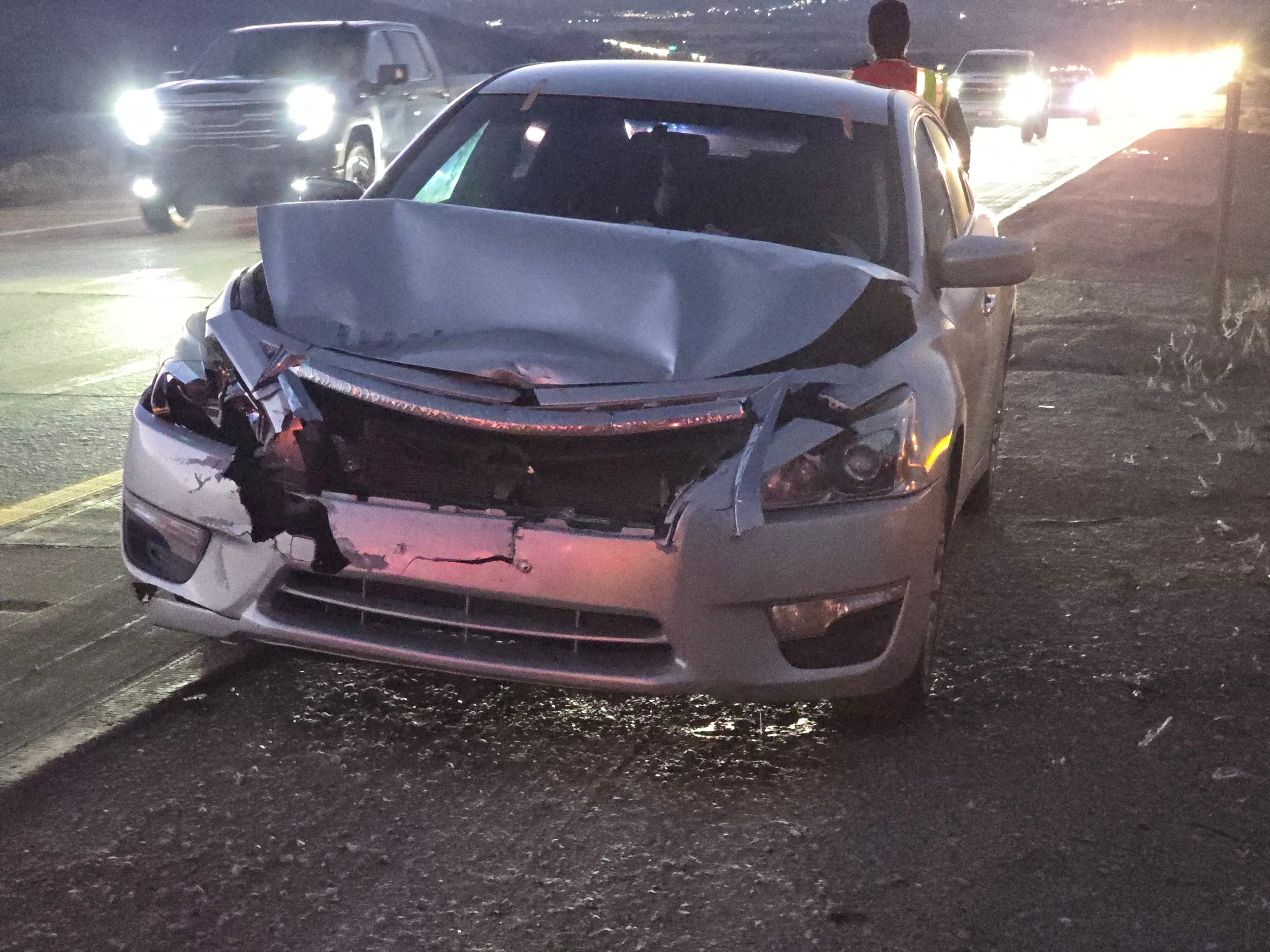

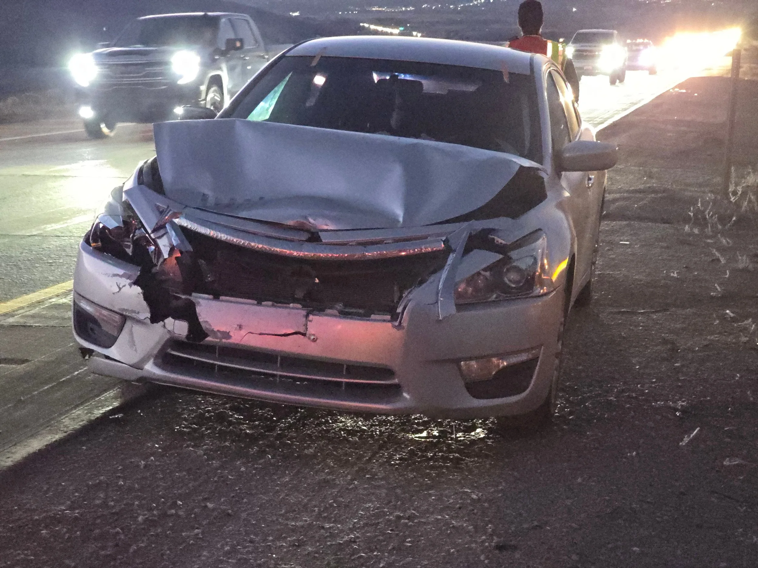

A few weeks back I was on my way up the mountain to work, when ahead on the other side of the highway there was a major incident (was dark and only saw lights of the emergency vehicles ahead) and traffic on our side was flowing smoothly. Suddenly just as I got close to the incident everyone in front of me slammed on their brakes, and I followed suit coming to a stop a few feet behind the truck in front of me. I looked into my rearview and closed my eyes because it was clear the car behind me was clearly not going to be stopping, she plowed into the back of the TJ and forced me into the back of the truck. Her sedan became quite crinched, and the truck had it's bumper mangled. I looked at those first because I didn't want to look at the TJ (and truth be told my first thought was worry that my fishing rod was broken when it came flying up from in back)

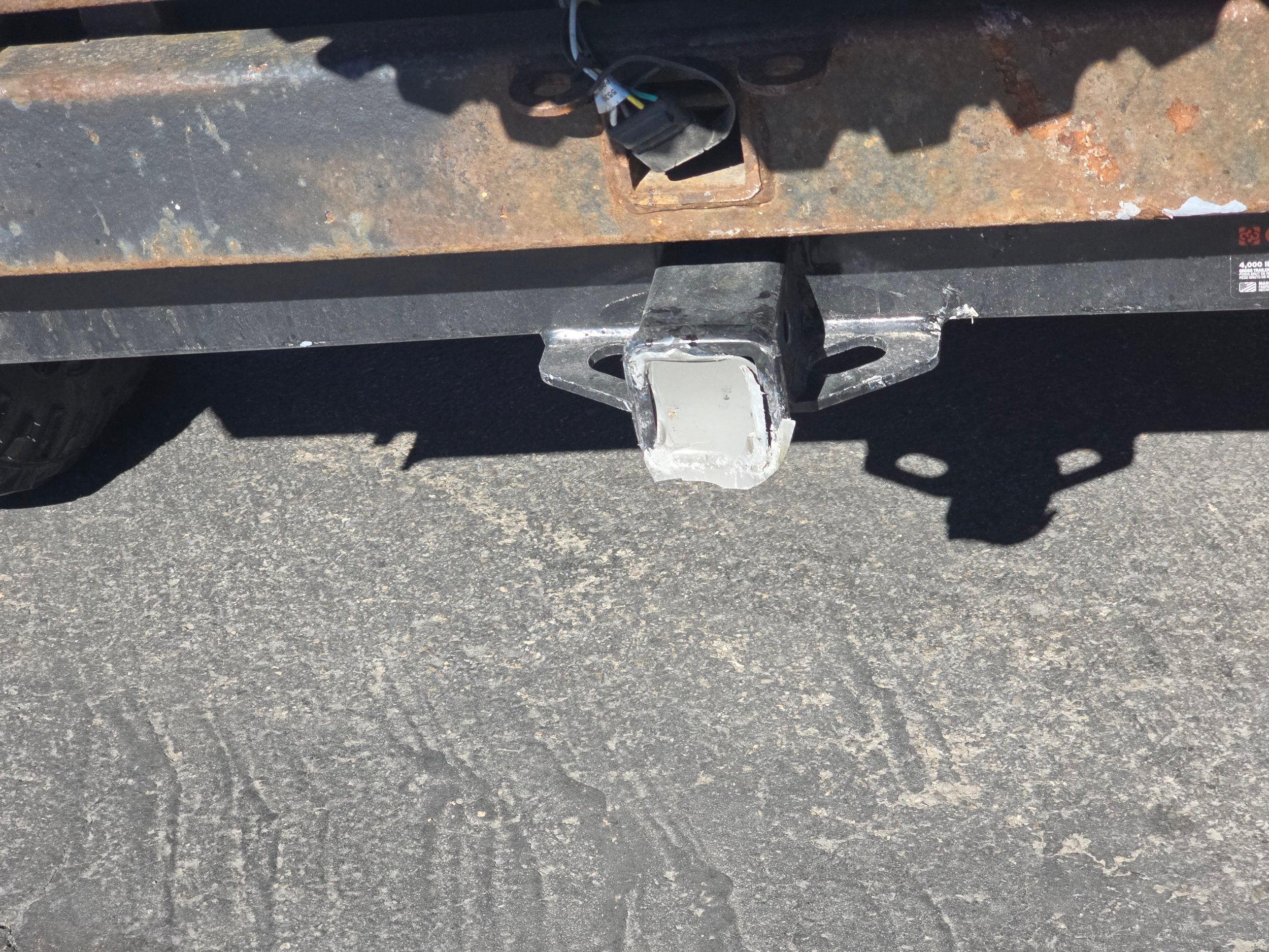

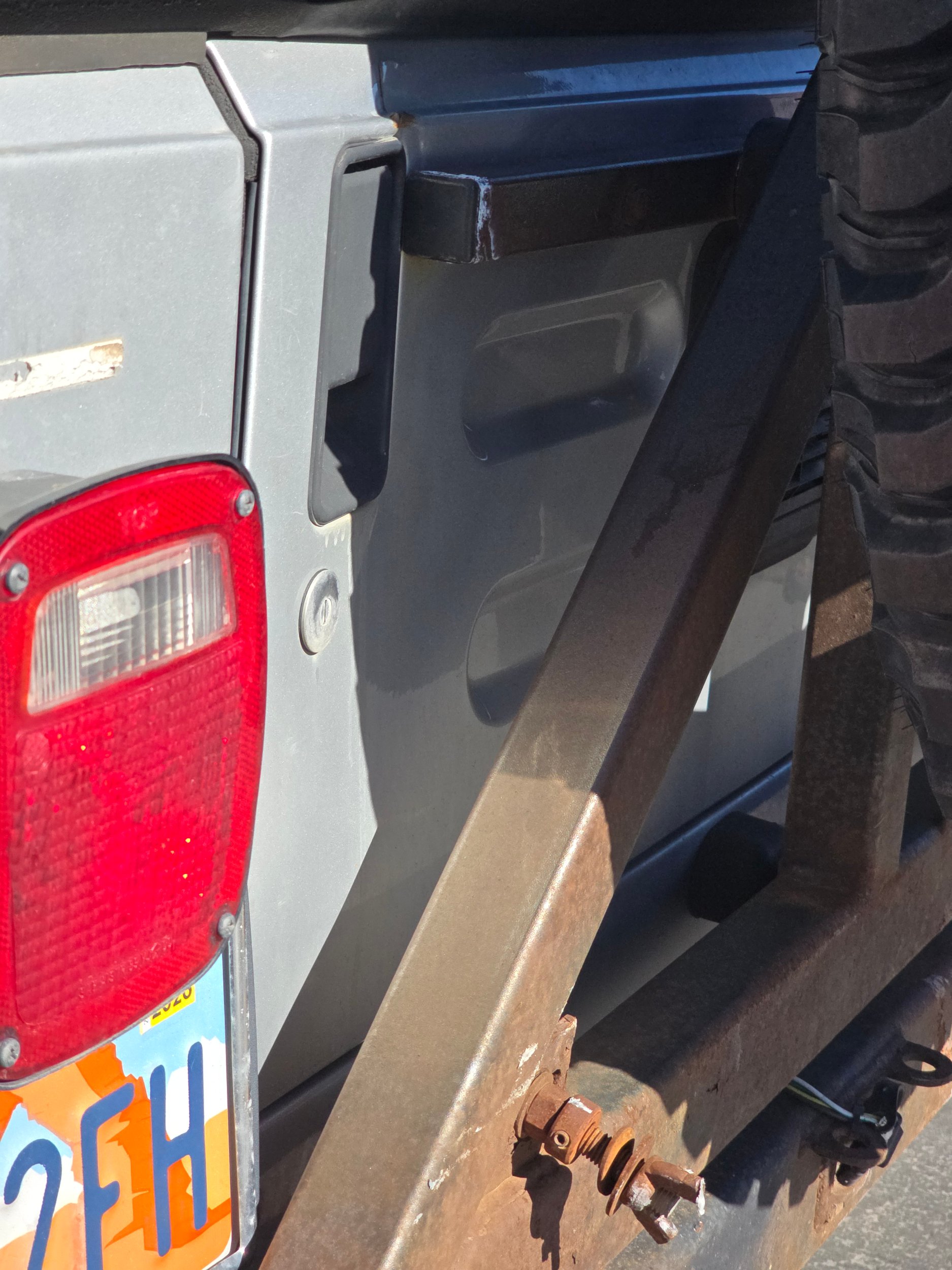

When I looked finally at the jeep I was pleased to see only minor visible damage (at first glance), and looked like the ARB bumpers and spare took the brunt of the impacts (yay ARB!) but the spare tire swing pushed in the tailgate a bit. The tow hitch bit a piece off her front end and was embedded in the hitch hole. One of the front fenders was bent.
