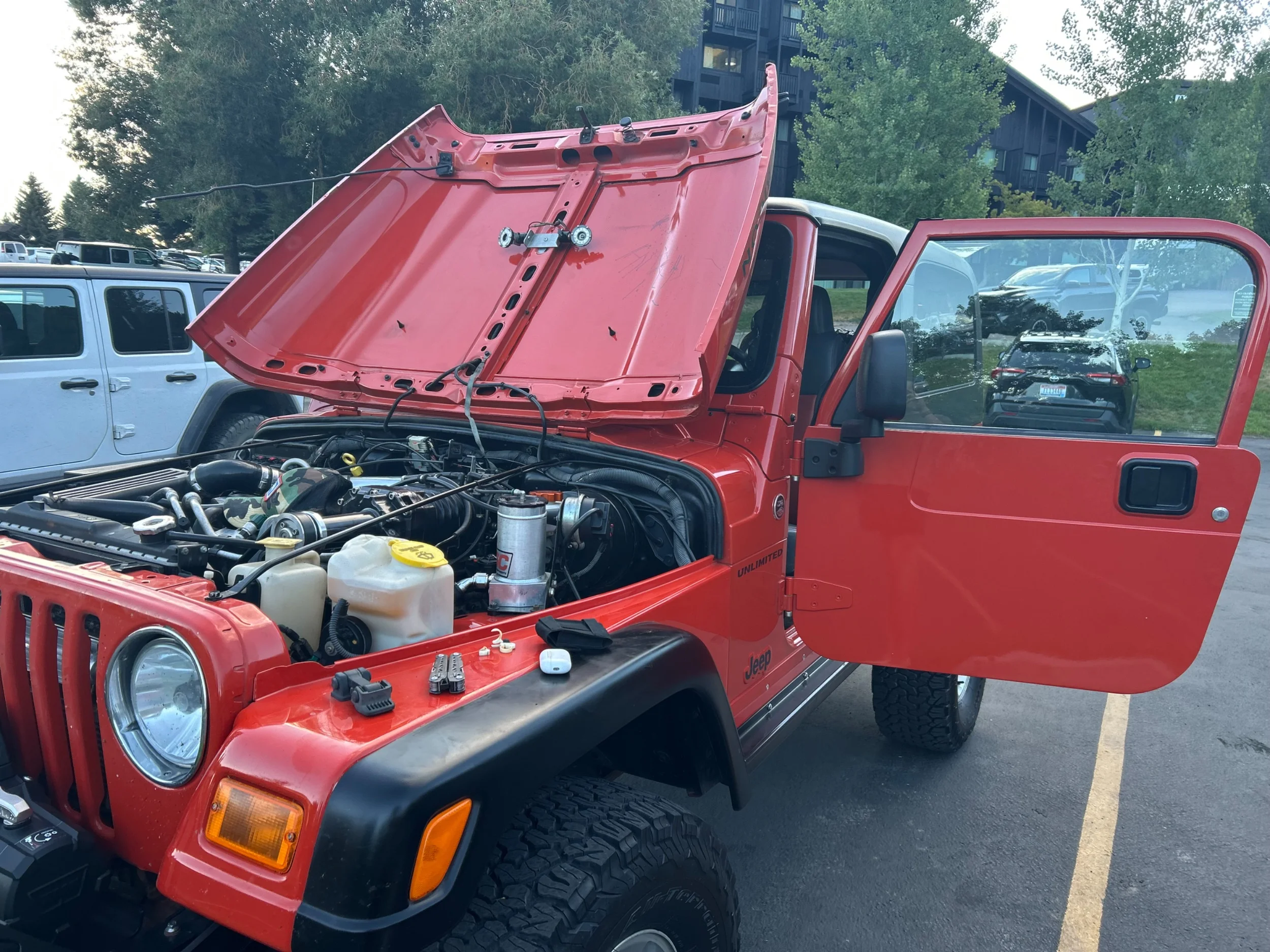

Below is a photo of the missing supercharger bolt that fell into the intake of my old engine. It is a very sad way to lose a factory 91k mile 4.0L. My assessment is that the driveline vibration helped work these bolts loose. Other supercharged Jeeps have not had the same problem and the only obvious difference between my Jeep and others is a lot of driveline vibration.
I'm very happy that this happened right as I was pulling into a hotel in town and not in the middle of Wyoming. My initial plan was to camp with this Jeep but I called that off after I found too many issues to be comfortable taking it off-pavement. I could have been stranded in a much worse place...
