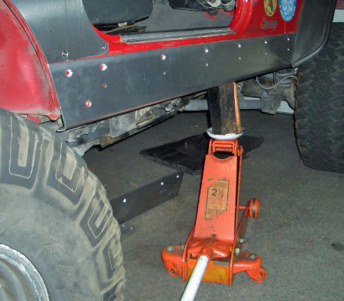

Once you get them in place like this you just drill holes through the slider holes, pass bolts through them then install the washers and nuts and you're done. Mine don't have steps but you get the idea.
